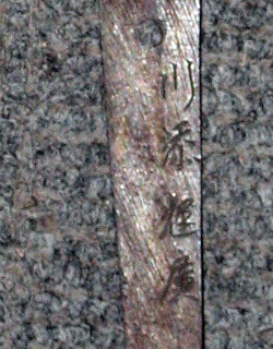

Ken-Hawaii Posted May 1, 2007 Report Posted May 1, 2007 My wife just purchased a nice Gendaito katana yesterday for use in jodo, & I'm trying to decipher the mei. Thanks in advance for the help. Quote
Nobody Posted May 2, 2007 Report Posted May 2, 2007 I think that the mei reads "Kawazoe Teruhiro (川添輝廣)". But I do not have any idea about the smith. Quote
Ken-Hawaii Posted May 2, 2007 Author Report Posted May 2, 2007 I was fairly certain that I had figured out the Kawazoe portion of the mei, Koichiro, but was completely lost on the Teruhiro part. Thank goodness my son & his Japanese wife are moving to Hawaii in 10 days! She may be able to help on some of these Kanji puzzlers. Hmm, you're right - Hawley doesn't have a smith listed by that name, or even close to the Showa era. Guess I have to do a bit more digging . Thanks! Quote
Rich T Posted May 2, 2007 Report Posted May 2, 2007 Tsuguhiro, ToShow shows 3 Showa smiths with this mei. 継廣 Cheers Rich Quote
Nobody Posted May 2, 2007 Report Posted May 2, 2007 Tsuguhiro, ToShow shows 3 Showa smiths with this mei. 継廣 Cheers Rich Yes, it might be. Actually, at first I thought that. And again, I cannot deny Tsuguhiro. :? Quote
Ken-Hawaii Posted May 2, 2007 Author Report Posted May 2, 2007 Thanks, Rich. My wife keeps saying that we just have to learn Kanji, but even with my detailed dictionary in front of me, along with a few cheat-sheets specifically on Kanji for mei, I get only about 10% of my guesses correct.... I see the three smiths in Hawley's, but what is "ToShow?" Quote
