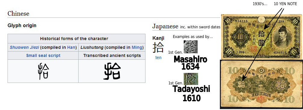

#5 KarlPeterSmith
KarlPeterSmith
    Chu Jo Saku
  • Members
  • 74 posts
  • LocationEngland
Posted 21 April 2018 - 09:05 PM
Thanks again.
I've put this together... showing the 1930's 10 YEN note (which shows both the Japanese character for 10 and the Chinese original character for 10 on the same note.
With two sword examples that use different numbers of kanji strokes.

Trusty old John Yumoto has all this very well covered as well. It is still worth owning.
