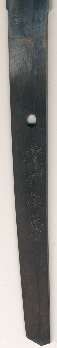

David McDonald Posted November 29, 2011 Report Posted November 29, 2011 Dear All This weekend I was at a gun show and bought (and I plan to resale) a late war naval officers (kai-gunto) with black lacquer saya and shark skin not the normal 'same' under the ito. The blade seems to be signed Noshu ju Hide So was there to much sake being drunk? and the last part of the name is missing? Or is there a WWII smith signed Hide? Any thoughts would be great. later david Quote
raaay Posted November 29, 2011 Report Posted November 29, 2011 Hi David At quick glance could it be Nobu Hide. Sorry David, I do not like the look of all the scratch marks on the top lefthand side of the tang ! has there been a showa stamp removed ? Ray Quote
David McDonald Posted November 29, 2011 Author Report Posted November 29, 2011 Dear Ray and Guido There is no seki/showa or the like stamp on this blade but you can see the hard spots at the top of the gunome so this is a oil tempered blade. And the hamon looks like many of the WWII Seki smiths. So Noshu Nobuhide Noshu Sumihide Do not lead to a know smith. I am thinking to much sake and the last kanji was forgotten. later david mcdonald Quote
cabowen Posted November 29, 2011 Report Posted November 29, 2011 There are two reasonable explanations: the smith's actual mei is simply Hide, or the last kanji wasn't cut. Sumihide is very unlikely. Quote
David McDonald Posted November 29, 2011 Author Report Posted November 29, 2011 Dear Chris I still think to much sake :D but there are the ichimonji blades, and the sa blades and I have a shinto/shinshinto with the signature gatsu So maybe there is a WWII smith that only signed Hide but he is not listed from what I can tell. So would you read the mei as ---- Noshu ju Hide ?? thanks for the comment later david mcdonald Quote
cabowen Posted November 29, 2011 Report Posted November 29, 2011 LIke I said, most likely one of the two scenarios.... Yes, the mei would be Noshu ju Shuu...農州住秀 There are several smiths with a one kanji mei so it is not out of the realm of reality....Shibata Ka, Shibata Ko come to mind..... Quote
