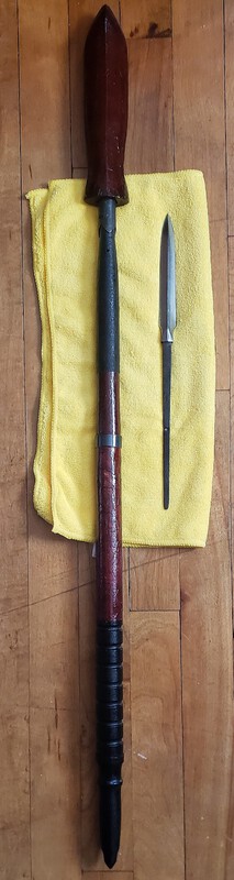

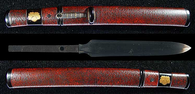

I was watching some videos on the usage of Uchiné and they make out that Uchiné were used for anything and everything. A multitool weapon of last resort?
You could throw one right after firing an arrow in order to cover yourself if the enemy tried to hit you at close quarters in that defenceless moment while reloading. A back-up arrow?
You could use one instead of a Yoroi-dōshi Tantō for delivering the fatal stroke to the neck of a downed warrior.
As a short stabbing spear in its own right. Or you could strap it to the end of your bow to function as a longer spear.
Etc.
Ultimately it seems to me that they would have been decorative for most of their working life, demanding too much training for too little benefit.(?)

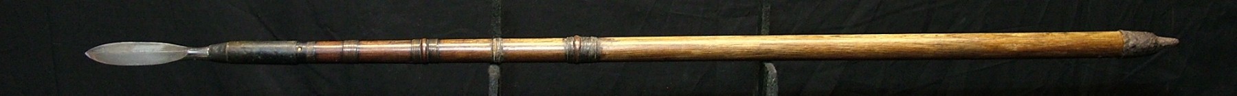

 The one I posted was bought a few years ago in 2016 and has been examined at the R.A. Leeds, and the mei is still visible on the nakago, so not cut down. The resident expert suggested "Kanahisi" (hope I remembered that one right) and a late 17th century date. Not all started long and ended short.
 Methinks it was made for a Te Yari or a Makura Mari for home defence, and probably quite inexpensively.... like the one below.

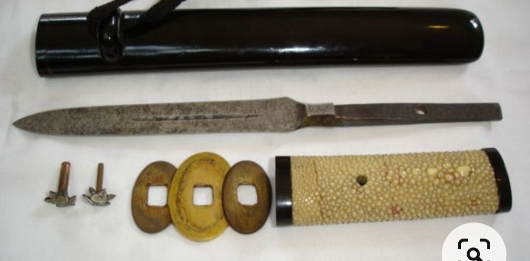

Here I go contradicting myself. This is one of my dozen+ Yari. Retains the original nakago.
Nagasa 14.5cm
Nakago 18.7cm.
Mei is 4.5cm below the kerakubi and last kanji 3.5cm above the mekugi-ana.  I have them signed above and below mekugi-ana. Nakago tapers down to a thin taper which is common on every yari i have. 20221023_095632.thumb.jpg.4319d8d8e88f722cd615aae012be4ad1.jpg
I have it mounted as a te-yari. 20221023_095655.thumb.jpg.db8f841b2733e33d27f201da60a00287.jpg

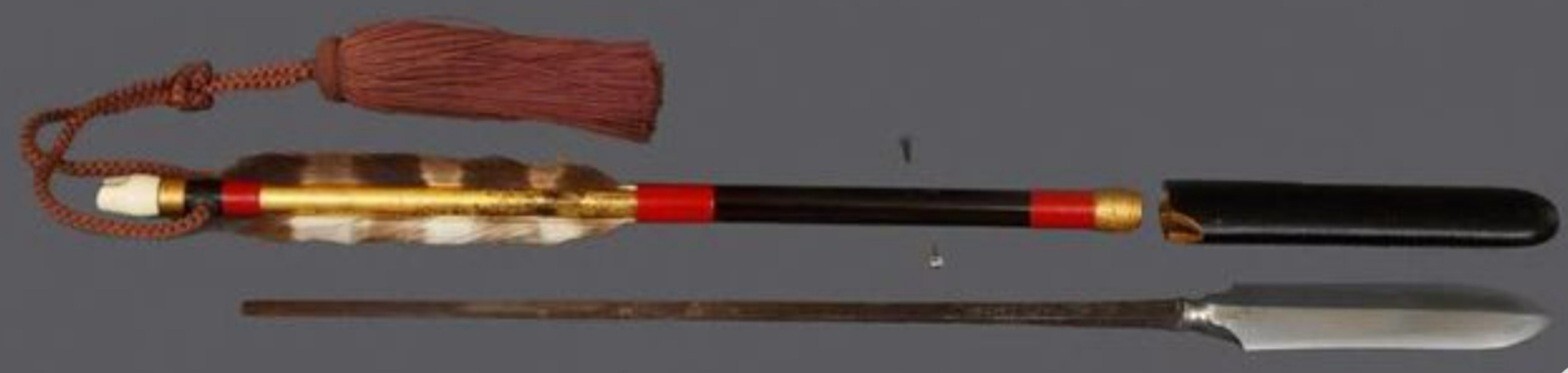

In Japanese unfortunately but there is an interesting article here on the possible uses and drawbacks of Uchiné, including the contact for a martial arts school that still continues the tradition.
PS One usage is to ward of the blows of an enemy, so presumably it would be advantageous for something 1 Shaku to 1.5 Shaku in length to have a steel/iron core (longish Nakago).
https://saitamagyoda.blog.fc2.com/blog-entry-394.html?sp
These items must have been really useful in a norimono, being small and handy. Providing there is no tassle or other attached cordage, they could be thrown at an attaker gaining enough time to climb out and draw a sword.

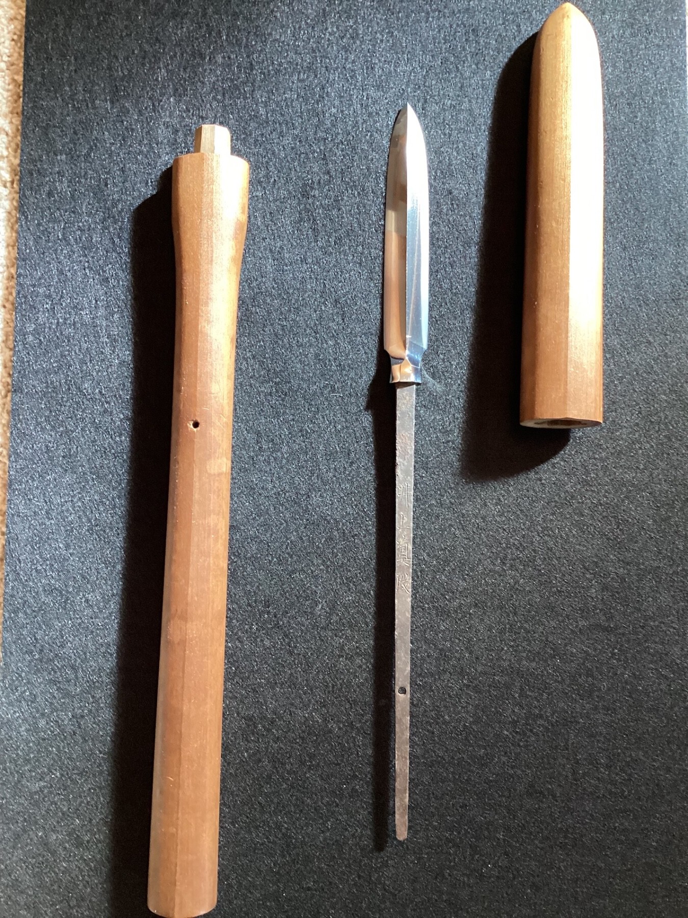

Noticed you have an extensive collection and I have a question about a yari in shirasaya I just picked up. Based on the previous discussion and your experience, would you consider this a kago yari, uchine, or something else? I ask because it is quite small - ha is 4.5 inches and overall about 14.5 inches.
Regards,
John C.

I'm going to have to go with what I said earlier.  Unless it is mounted as such(uchine or Kago yari) there is no way of knowing. Even then, the ones I have been seeing coming out of Japan seem questionable on much age. I have seen pictures of a matched set of arrows, quiver, and uchine. All nicely lacquered with gold kamon. The uchine koshirae was considered to be that of the edo period, but the Yari itself dated to the muromachi period.
I recently acquired a book about Uchine, and in it are illustrations and translations taken from books/scrolls from different schools discussing uchine all written in the last 50 or so years of the Edo period. The early mounting of them was what one would call a Kago yari. A short spear/shaft made for throwing lacking feathers. They all seem to state the same thing though, in that the blade length is around 6cm all the way up to 21cm. That is a huge variance and contradicts a lot of things that I had originally thought.

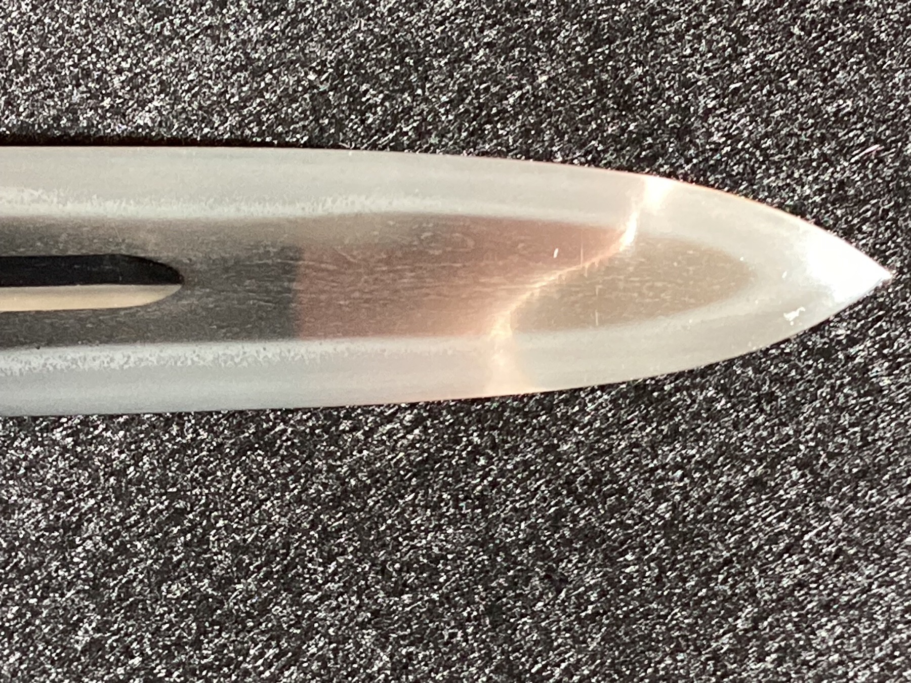

Thank you. As a follow-up, is there any way to tell an approximate age based on style/size or did the various styles run the gamut of periods?
It seems to be very nicely made with nie along the temper line and is in decent polish. Nakago is a dark rust so I'm thinking not too new. Early meiji perhaps?

A late reply because I really don't have an answer for you. I was researching yari and dates for a while but just stopped.
The one thing that keeps getting told over and over again is a long Kerakubi is an indicator of old age. Well, here is one with NBTHK Hozon papers dated to mid to late muromachi period. Notice anything?
Small kerakubi, and this is even an Omi yari at over 23 inch blade.
Here's one signed and dated 1636.
Here's some of my older ones. The far left one is an Omi yari.
20240108_110914.thumb.jpg.7cf279bec7570e36afb932f3acbf8af9.jpg20240108_110830.thumb.jpg.e3299821e5f61b563acae39b677bd746.jpg
Unfortunately the nakago is heavily corroded away and is signed but to hard to read. The problem with determining age by nakago is that the condition is all over the place on these. Probably because how they were stored or the ebu material itself.
