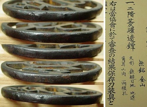

One or two thoughts here on the matter of "bones" in iron tsuba...
It seems likely to me that, initially, anyway, tekkotsu were a by-product of the type/constitution of the iron used by various metal-workers in their production of tsuba. Since iron tsuba were being produced from at least the Kamakura Period onwards, we might expect to find a range of guards presenting with anywhere from zero tekkotsu to rather a lot of it over the centuries. However, I suspect that, in these earlier times, too much tekkotsu might be seen potentially as a structural flaw, or conversely, as an aesthetic one. If we remember that in the 14th, 15th, and early part of the 16th centuries a more definitely Chinese aesthetic sense held much sway in Japan, the various subtle aesthetic principles we might tie to the expression afforded by tekkotsu (yugen, shibusa, sabi, wabi, etc...), and which would have been greatly appreciated and sought after by the late 16th century, would not in fact have been likely to be seen as a desirable trait in an iron guard. I don't think it's an accident that when we think of the various classic forms of Kyoto tsuba (i.e. "refined," high-culture tsuba), we rarely find traditions known for their use of tekkotsu (yes, I do think it is a conscious inclusion in tsuba design and production; more on this in a moment). Consider Kyo-sukashi, Kyo-Shoami, Heianjo-sukashi, and Umetada tsuba: none of these "schools" is recognized for its tekkotsu. In fact, only the ko-Shoami "school" can be seen to incorporate tekkotso in their guards, and even they did not do so to anywhere near the degree that the various Owari Province tsuba smiths did.
Why might the ko-Shoami group have utilized tekkotsu, then? I believe it has everything to do with the Tea Culture which was utterly dominant among the most powerful taste-makers in Momoyama Japan. At no other time before or since was there such an intertwining of the ascendence of Tea with that of such potent martial men as Oda Nobunaga, Toyotomi Hideyoshi, and Tokugawa Ieyasu, along with "lesser" bushi like Hosokawa Sansai, Fukushima Masanori, and of course, Furuta Oribe. For these bushi, Tea was immensely important. And with that importance came the aesthetics attached to it.
In much the same way, then, that Tea aesthetics impacted the evolution/development of the various ceramic types utilized in the Tea Ceremony, those same aesthetics, I believe, found expression in the tsuba of the day. Since those aesthetic principles manifest in ceramics as not only simple formal asymmetry, but also the deliberate "marring" of the surface and structure of the tea vessel in question in order to realize the sought after "Tea Expression," so to did they manifest in the Yamakichibei, Hoan, and Kanayama tsuba of that period. If one has access to enough Yamakichibei tsuba to do a side-by-side-by-side comparison, one can begin to see patterns of tekkotsu in terms of their type, amount, and specific location on the tsuba. They exist in various concentrations and degree according to location on the guard. Viewing many Yamakichibei tsuba at once affords such a realization, if one is observant and conscious of what one is seeing there. Of all the tsuba schools and traditions, Yamakichibei, I believe, most powerfully express the same aesthetic principles guiding the artistic production of Momoyama ceramics; and they are no less conscious in the specifics of their design and creation than are the products of kilns like those of Shigaraki and Iga, along with the Seto, Bizen, Oribe, etc...
Let's remember that one of the most important castle towns of the Momoyama Period was Kiyosu in Owari. At various times, Nobunaga, Hideyoshi, and Masanori, among others, all were lords of Kiyosu. Yamakichibei and Hoan are both thought to have been armorers and tsubako in Kiyosu; Yamakichibei is noted to have been in the service of Nobunaga as an armorer and tsubako. Kanayama tsuba are understood to have been made in Owari province as well, as were, of course, Owari tsuba (also known for its fine use of tekkotsu).
In my view, tekkotsu are specifically, if not exclusively linked not only to Momoyama Japan (whose aesthetic is decidedly not Chinese [unlike so much of what we see in Muromachi times]), but to Owari Province as well. This isn't to say we cannot find tekkotsu in tsuba made outside of this period or locale, but it is to say that Momoyama Owari is dominant when it comes to the conscious employment of tekkotsu toward a deliberate aesthetic intimately associated with Tea Culture.
I have included a few photos here of prominent Momoyama Tea utensils, along with a couple of Momoyama tsuba with tekkotsu. Note the surface expression in each. Then consider the use of tekkotsu in Yamakichibei, Hoan, and Kanayama tsuba. In my view, the crossover is inescapable, especially since so much of the aesthetic principles involved were expressly written of in the Momoyama Period itself (rather than merely centuries later...).
