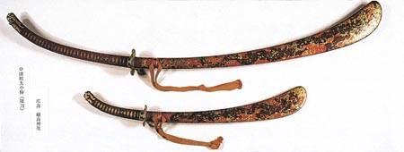

Nobody Posted September 18, 2010 Report Posted September 18, 2010 I know little about this subject. One of my books defines Keiba-Tachi/Dachi (競馬太刀) as follows. Keiba- Tachi/Dachi is a tachi which was put on at horse racing (競馬 - Kurabeuma). Its fittings are of Kenukigata, but blade and tsuba are made of wood. Ref. 刀装のすべて, ISBN4-7694-0122-1 Kurabeuma (競馬) is not a modern horse racing but a traditional ceremony. Ref. Kurabeuma http://www.cr.chiba-u.jp/~yamamoto/fswi ... oKurabeuma http://il.youtube.com/watch?v=KnzHrQX8hsg BTW, the Tachi in the attached picture is one of Important Cultural Properties of Japan, and it is now posesed by Itsukushima Shrine. It is also called Keiba-Tachi/Dachi sometimes. However, its appearance might look a little different from the definition above. Quote

reinhard Posted September 19, 2010 Report Posted September 19, 2010 Attached are three examples from the Tokyo National Museum. Description is always the same: They were made between 15th and 18th century for ceremonial horse-race. There's not much of a secret as it seems. It was a kind of standard for three hundred years to be worn on this particular occasion. This kind of koshirae was usually made with a kenuki-gata handle. The one in the Itsukushima shrine depicted by Moriyama-san seems to be special and of a more elaborate kind than the ones in the TNM. reinhard Quote
