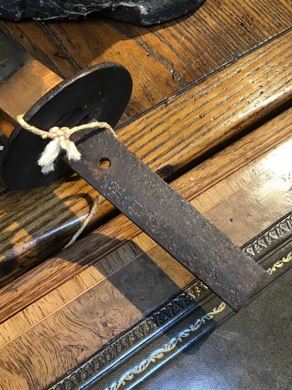

nihonto_1 Posted Thursday at 07:42 PM Report Posted Thursday at 07:42 PM (edited) Hi - while browsing around i cam across this Blade - apparently from a well regarded Victorian collector's collection - described as a early 19th century sword. the pictures are not my own and the blade is not in hand to take any other images. Blade is 70cm long I was interested in the combination of the kaku-mune and the Kikumon generally it seems in rather poor shape. is this a from a naginata? and has the tang been cut down? seems a very abrupt ending. Edited Thursday at 09:49 PM by nihonto_1 Quote
Ray Singer Posted Thursday at 07:50 PM Report Posted Thursday at 07:50 PM (Kikumon Ichi) Kawachi (no) kami Sukesada Bizen (no) kuni Osafune ju 3 1 Quote
nihonto_1 Posted Thursday at 08:05 PM Author Report Posted Thursday at 08:05 PM @Ray Singer thank you. Now I understand the ichi bit. So from the early 1700 Would the tang be suriage? Just seems very 'cut off' Quote
Ray Singer Posted Thursday at 08:06 PM Report Posted Thursday at 08:06 PM This is the second generation of the Shinto Yokoyama Sukesada lineage, circa Genroku (1688). It appears to be suriage. 1 1 Quote

nihonto_1 Posted 6 hours ago Author Report Posted 6 hours ago Thank you Ray. Bruce, my 'understanding' was on a much more novice level I am afraid. I understood the kikimon, but my 1st time seeing the ichi. So if kikumon ichi, forged after 1701 when permission was given. Are there any thoughts on the kaku-mune / suriage/ 70cm blade length? From my readings the size makes it too long for a naginata, which seems to become more wakizashi in length. So was this a revival piece made as tachi and then cut down? Or just a larger blade with a larger tang that maybe was cut down later in the Edo or possibly early 20th century to fit more modern mounts? W Quote
