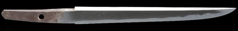

Tsubafan Posted Monday at 08:08 AM Report Posted Monday at 08:08 AM (edited) Hi, I got this Tanto at an antiques fair couple of months ago (as a lot with another one signed Senshū-jū Masakiyo saku => thanks again to Xiayang for helping with the translation) and did not have time to disassemble it until very recently. it is Mumei and the blade in worse condition than the Masakiyo one. It came with the Kozuka Kogatana pictured which is clearly not original to the set. I believe all the fittings are in solid silver and the habaki is a thick gold leaf over copper. Any thoughts on it would be appreciated, especially if thinking about a restoration of the blade would make sense... Edited Monday at 08:10 AM by Tsubafan 2 Quote

Rivkin Posted Monday at 08:37 AM Report Posted Monday at 08:37 AM 13 minutes ago, Tsubafan said: Thanks for your feedback. Please advise on the close ups or measurements you need Mostly just details of work, high resolution nakage - well lit, even if its just photoshop correction, what kind of mune - it feels like it has think kasane. The ana look koto, so here is some promise here. Quote

Lewis B Posted Monday at 09:55 AM Report Posted Monday at 09:55 AM Certainly gives the impression of being a yoroi-doshi based on the sugata and dimensions. The shape of the nakago reminds me of Tosa Yoshimitsu. More info on the deki would be helpful. Appears ubu and mumei would not be unknown for Muromachi into early Edo work. 1 Quote
Tsubafan Posted Monday at 02:20 PM Author Report Posted Monday at 02:20 PM 4 hours ago, Lewis B said: Certainly gives the impression of being a yoroi-doshi based on the sugata and dimensions. The shape of the nakago reminds me of Tosa Yoshimitsu. More info on the deki would be helpful. Appears ubu and mumei would not be unknown for Muromachi into early Edo work. Thanks. The blade is not in good shape... I tried my best to do some close ups but being able to capture such details is quite difficult. Quote
Lewis B Posted Monday at 02:25 PM Report Posted Monday at 02:25 PM Are you using fluorescent lighting? If yes, try a LED, incandescent or halogen light source. Quote
Tsubafan Posted Monday at 03:11 PM Author Report Posted Monday at 03:11 PM 44 minutes ago, Lewis B said: Are you using fluorescent lighting? If yes, try a LED, incandescent or halogen light source. Absolutely spot on, i was using a photobox with a fluorescent tube. Maybe those will be better using a powerful LED but to be honest i have exhausted all my capabilities as a photographer 1 Quote
Lewis B Posted Monday at 04:55 PM Report Posted Monday at 04:55 PM How do the photos compare to what you see in hand? The last photo appears to show mokume swirls. If thats the case then Tosa Yoshimitsu is a strong contender. Overall though the surface oxidation is preventing the viewer from appreciating the activity. So this might be a good candidate for polish. A Tosa Yoshimitsu attribution would date this tanto to the end of the Muromachi. This is one that Ray had for sale in better condition 1 Quote
Tsubafan Posted Monday at 07:50 PM Author Report Posted Monday at 07:50 PM 2 hours ago, Lewis B said: How do the photos compare to what you see in hand? The last photo appears to show mokume swirls. If thats the case then Tosa Yoshimitsu is a strong contender. Overall though the surface oxidation is preventing the viewer from appreciating the activity. So this might be a good candidate for polish. A Tosa Yoshimitsu attribution would date this tanto to the end of the Muromachi. This is one that Ray had for sale in better condition Thanks for your feedback. I can clearly see Mokume pattern on Ray's example and I can almost say there is also Mokume pattern on mine but it is more difficult so see. Would it be possible to get it polished within Europe ? Quote

Rivkin Posted Monday at 08:33 PM Report Posted Monday at 08:33 PM It could be 1470s, for example. Not the mainstream schools unfortunately. It has pronounced nioi-guchi which is not very well controlled, reasonably tight forging, but then again in couple of places it can open up with polish. What happens with the kaeri? Its almost like there is none on one side, which torpedoes a lot of attributions. So boshi-kaeri on both sides would be of interest. 1 Quote

Ian B3HR2UH Posted Monday at 10:30 PM Report Posted Monday at 10:30 PM If it was Tosa Yoshimitsu you would expect it to have a narrow suguha hamon and not be midare Quote

Lewis B Posted Tuesday at 04:30 PM Report Posted Tuesday at 04:30 PM 18 hours ago, Ian B3HR2UH said: If it was Tosa Yoshimitsu you would expect it to have a narrow suguha hamon and not be midare Well there were up to 7 generations (a few in the Muromachi) in Tosa signing Yoshimitsu and not all made narrow suguha hamon. I'm not saying this particular tanto is by Tosa Yoshimitsu, just that this school, which is well known for yoroi-doshi, is an avenue worth pursuing. https://www.sho-shin.com/NAN5.htm Quote
Ian B3HR2UH Posted Tuesday at 05:25 PM Report Posted Tuesday at 05:25 PM Lewis , there are a lot of smiths named Yoshimitsu . My old blue Hawley lists 38 and there are probably more . Attached is a montage of Tosa Yoshimitsu blades from Japanese publications . None of them have a nakago shape like that on the piece you attached . Personally with this discrepancy and the atypical hamon I have my doubts that the piece you put up is by Tosa Yoshimitsu . Perhaps it is by one of the other thirty odd Yoshimitsu. PS It is a nice piece Louis 1 Quote
