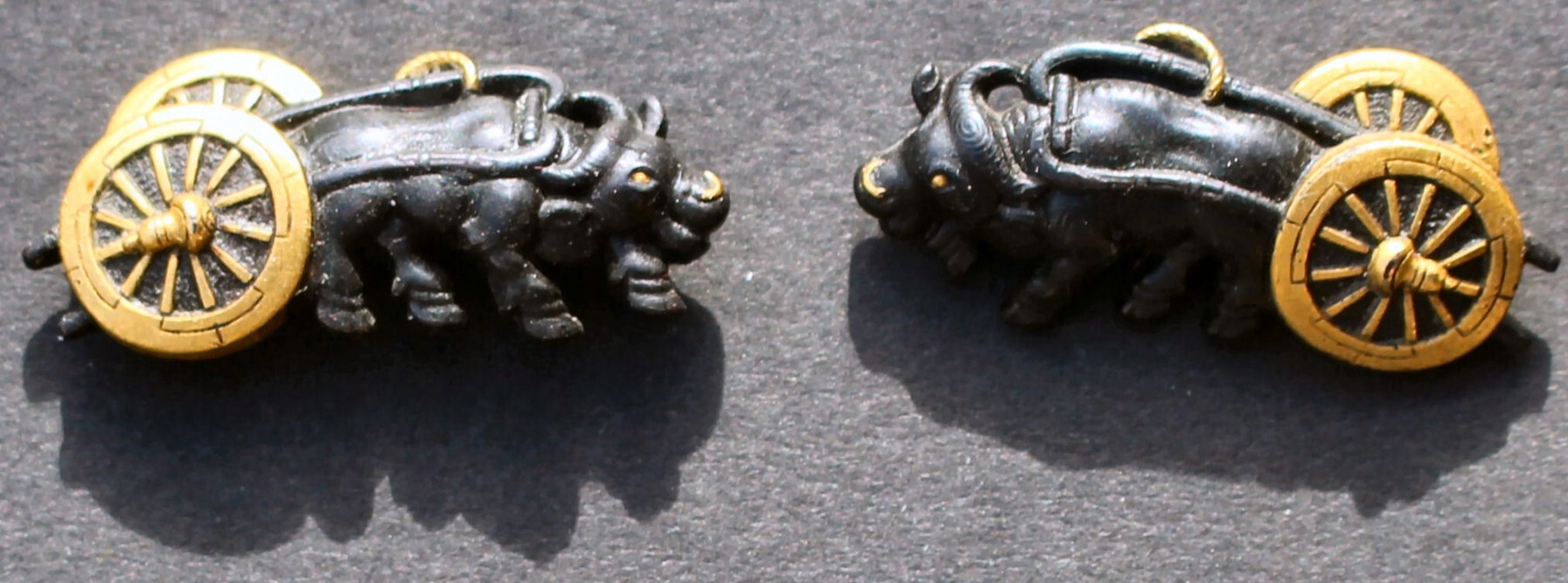

kissakai Posted May 23 Report Posted May 23 I bought these just over ten years ago I was thinking about these menuki the other day and the comments made by Ford Hallam after seeing it in hand, stating the thin gold plating was a 'lost' process Anyone who knew Ford also knew he had a wicked sense of humour so what are the NMB members thoughts? Details but nothing confirmed School: Goto Circa 1700 Thin plate gold was used rather than gold leaf Gissha (Old oxcart for nobles) Shakudo and gold Size 32 x 14mm I'd welcome any comments 1 Quote

ROKUJURO Posted May 23 Report Posted May 23 It was perhaps not a humorous remark but a misunderstanding. The MENUKI have obviously been made in a "lost wax model" casting process instead of UCHIDASHI. Quote
Hokke Posted May 23 Report Posted May 23 7 minutes ago, Lewis B said: Lost or loss process? Mercury gilding is described a loss process as the Mercury is vaporised leaving a thin gold film on the object? I believe he was referring to “lost” in the sense that it is no longer a method used due to the health hazard. Quote
Hokke Posted May 23 Report Posted May 23 Just now, ROKUJURO said: It was perhaps not a humorous remark but a misunderstanding. The MENUKI have obviously been made in a "lost wax model" casting process instead of UCHDASHI. Interesting Jean, what stands out to you that these were cast? The square posts that look to be sprues? Quote

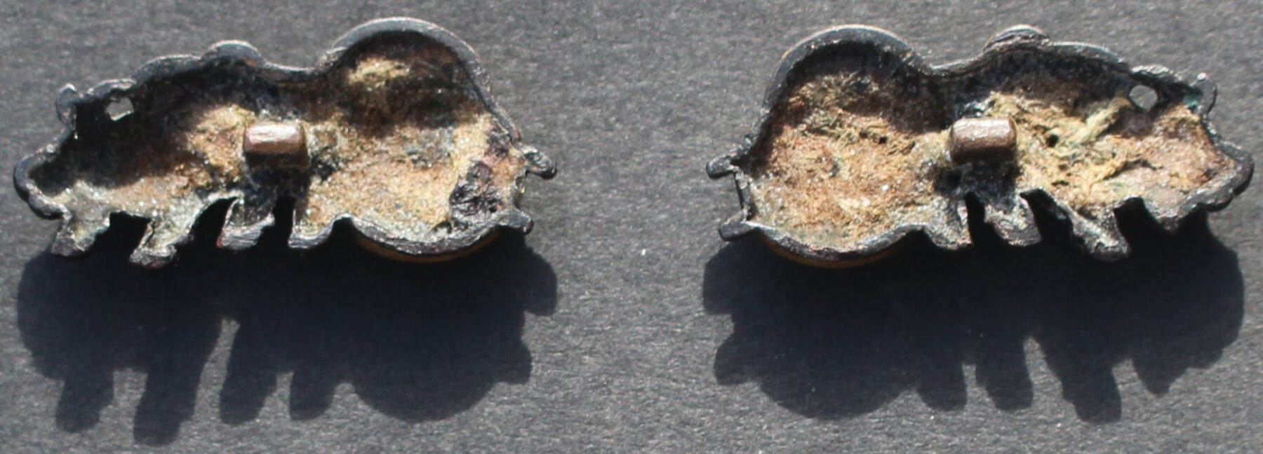

ROKUJURO Posted May 23 Report Posted May 23 This is not really an inferior method in MENUKI making. If you look at the very detailed outer structure, it cannot be achieved just by pushing material in and out. But I admit that one should see these MENUKI cleaned in-hand to be sure. Quote

Matsunoki Posted May 23 Report Posted May 23 These menuki look cast and then hand finished…imo. 1 Quote
NotANinja Posted May 24 Report Posted May 24 On 5/23/2026 at 5:10 PM, ROKUJURO said: It was perhaps not a humorous remark but a misunderstanding. The MENUKI have obviously been made in a "lost wax model" casting process instead of UCHDASHI. Could the oxen be uchidashi, with the wheels soldered or braised as a possibility? The underside of these look like uchidashi, but I agree the wheel spokes look difficult to achieve with that method Quote
ROKUJURO Posted May 24 Report Posted May 24 Rob, we will probably never know how they were made, but you can come closer in case you could clean out the underside carefully. If UCHIDASHI technique was performed, you would see the chisel traces. If the surface texture looks bumpy, but smooth, casting is more likely. As far as I know, soldering and brazing are rarely used in TOSOGU making. Quote
