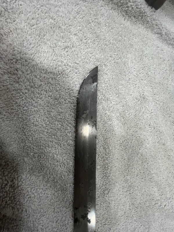

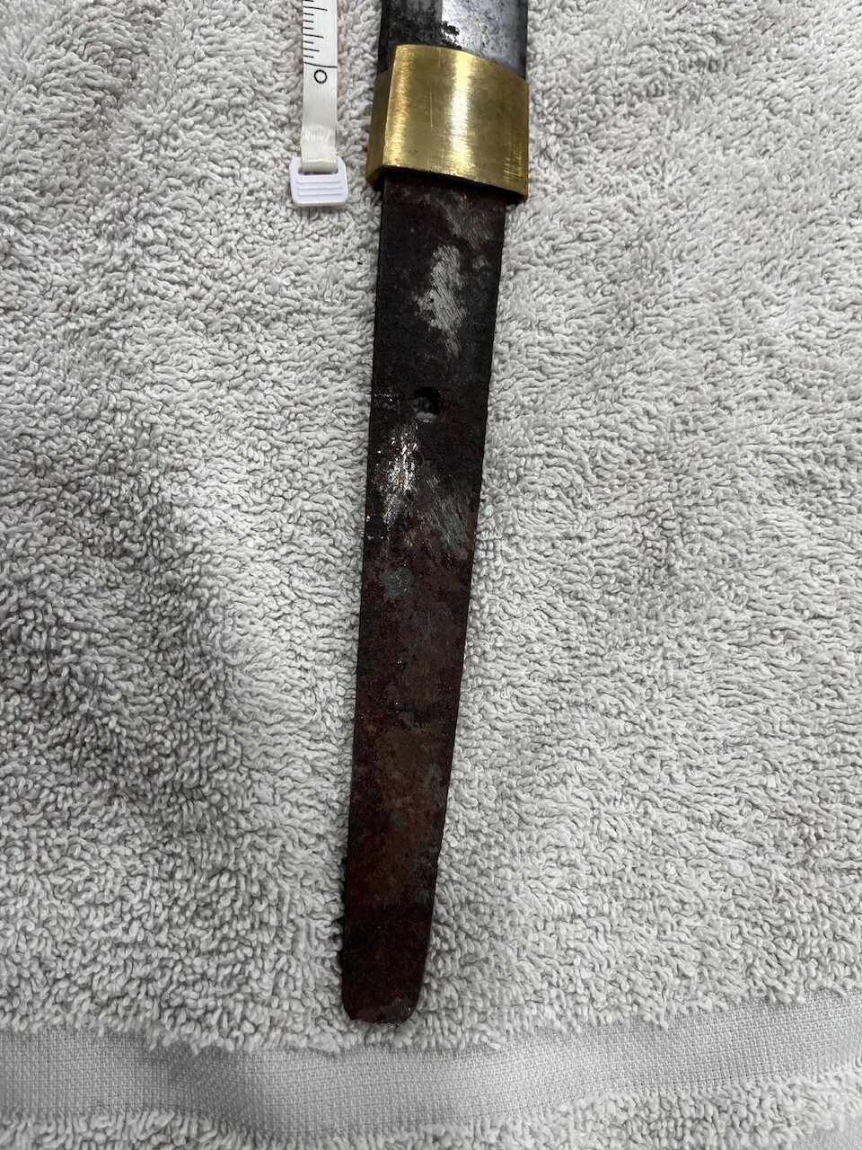

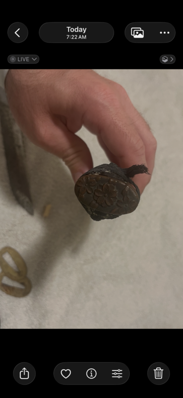

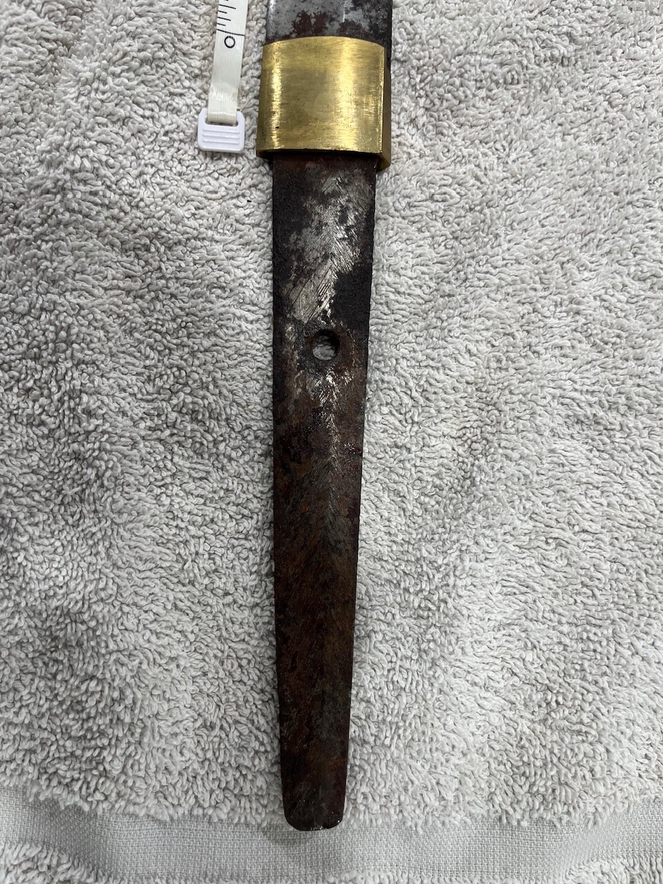

William Jennings Posted March 24 Report Posted March 24 (edited) Hey guys! I picked up this sword at a sale and was hoping to get more information on it. Is this an older sword that was repurposed for the war or a showato? I’m guessing older but not sure. I think it’s in gunto mounts but not the typical mounts that I’ve seen before. Was this a military sword or carried by a civil worker? Mumei nakago The nagasa is 26 inches i think the hamon is notare-gunome but not sure takanoha yasurieme, so possibly Mino den? any information about its age/maker would be helpful Edited March 24 by William Jennings 1 Quote

Toki Posted March 24 Report Posted March 24 Nice find and a pretty sword! The mix of rust and shiny spots on the Nakago make it look more modern than old to me, as if its not completely oxidized quite yet. But I am just a beginner myself, so wait for a more experienced member of this Board.😅 1 Quote
ROKUJURO Posted March 24 Report Posted March 24 William, the TS)UBA photo is upside-down, and the contrast of the blade photos is low due to the bright background so there is not much to see for identification. The corrosion is also not helping. I think I see a SANBON-SUGI HAMON, and as Erik states above, the NAKAGO looks like one of a more recently made (WW II) blade. A good photo of the NAKAGO without HABAKI and light frome the side (blade-tip pointing upwards), made on a dark backgound, may reveal more. Do you see a stamp somewhere? 1 Quote
William Jennings Posted March 24 Author Report Posted March 24 @ROKUJUROJean, thank you! I will try to get you better photos on a dark background and side lighting. As for the nakago, I don’t see any stamps. Just the yasurieme. Is there a way to remove some rust on the nakago without ruining the blade to better look for a stamp? Suggestions? Quote

Rivkin Posted March 25 Report Posted March 25 Hamon is exactly periodic sinusoid with accented nioi-guchi which is visible everywhere at any angle. Most likely Showa (WWII) stuff with brutally cleaned nakago. Quote
