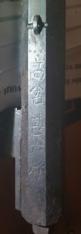

Jay Vining Posted December 17, 2025 Report Posted December 17, 2025 Hello, I'm brand new to the forum and I am interested about learning more about my newest addition to my collection. Most of my collection are antique European fire arms. This is my first matchlock. It seems to be complete and functional however the bore is pretty bad at the moment. The barrel is 106 cm long with a bore of about 11.9mm with a poppy muzzle. The stock is in decent shape with some cracks but stable. I got it all apart to clean up and to check to see if it is signed under the barrel. I'm also trying to get the bison out gently and address the rust under the stock. A translation of the Mei would be much appreciated. So far I have the following pictures. Thank you, Jay 2 Quote
Bugyotsuji Posted December 18, 2025 Report Posted December 18, 2025 Jay, hi and welcome! Congratulations on a fine-looking Tanegashima smoothbore matchlock! The Mei reads Takakura Jinroku 高倉甚六 plus 作 (saku = made by). He was a smith from Sakai in Settsu province, today's Osaka. There is a Kanei 10 (1634) dated bronze barrel pistol listed for Takakura Jinroku Shigemasa kept at Itsukushima Jinja, who could be the same person or a later offspring, but it helps suggest that your gun was made sometime in the early Edo period. (Quick question. Do all the mekugi pins line up correctly with the barrel?) PS A poppy muzzle is an indicator for Sakai manufacture. Sadly, many of these old Japanese matchlocks were not thoroughly cleaned after use, so the bore is often in terrible condition. Only one of mine is still pristine! 1 Quote

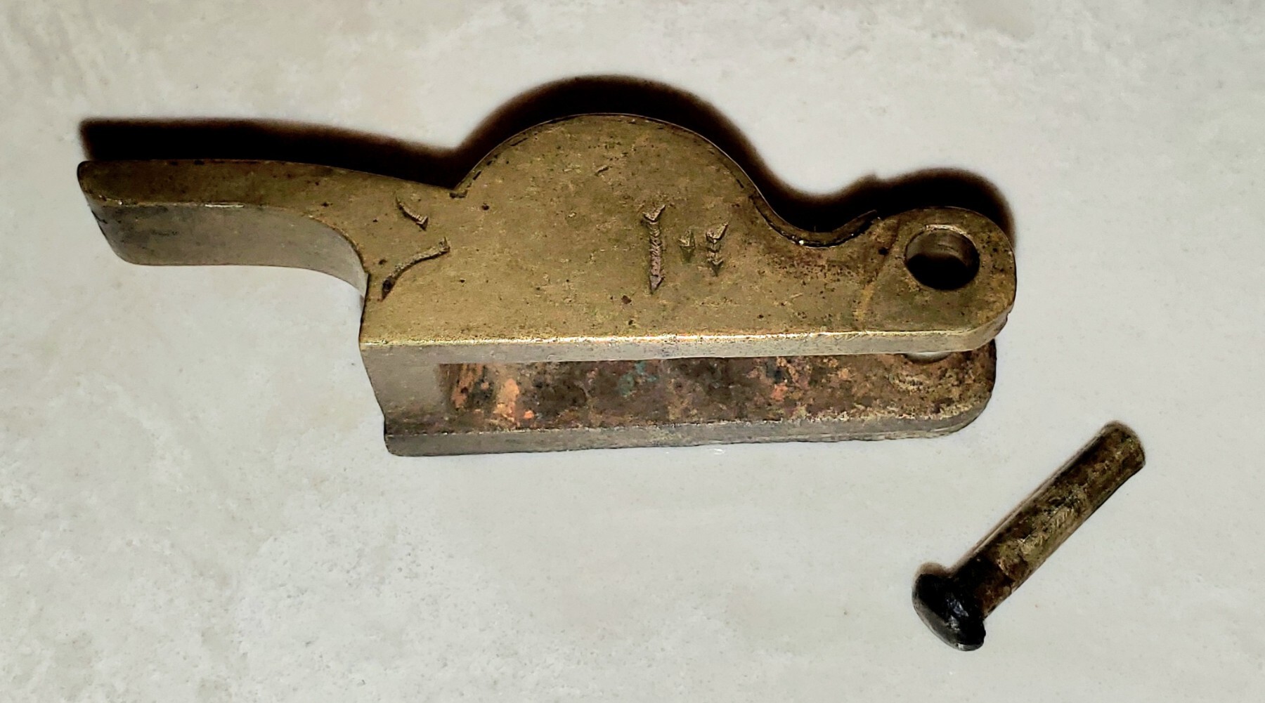

Jay Vining Posted December 18, 2025 Author Report Posted December 18, 2025 I've added some new pictures, there seem to be some characters on the bottom of the pan cover and noting that the pin is solid. Also a detailed shot of the poppy at the barrel muzzle. This is all very interesting and great background for my new Teppo. Thanks, Jay 2 Quote
Bugyotsuji Posted December 19, 2025 Report Posted December 19, 2025 Yes, that is a very nice example of a Sakai muzzle surround with silver zogan inlay. See this photo of four examples from the region. The pan lid has 38 beautifully incised on it, suggesting that this may have been on a gun as part of a multiple order. The number is often repeated on other parts, so if you do not see it elsewhere this strengthens the possibility that it was drafted in as a replacement cover. The pin may also be a replacement as they were usually a hollow cylinder for insertion of a particular wire to support a small protective rain box. 三 八 (三八 Sanju hachi, thirty eight) From the Sakai (Osaka) section of Sawada Taira’s ‘Nihon no Furujū’ (Old guns of Japan) 3 Quote

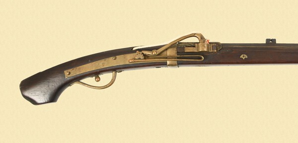

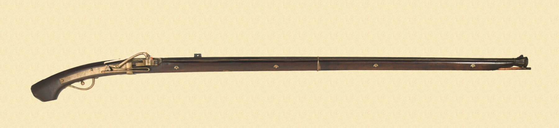

Jay Vining Posted December 29, 2025 Author Report Posted December 29, 2025 Thanks Piers, From reading that page you have provided, I see that it is rare for the front of the barrel to have a wider diameter that the rest of the bore. I assume for easier loading. My example has that characteristic too. I have provided the assembled photo of my gun. From what you have seen, is it possible to tell if it could have been a military gun or for a private individual such as a sporting gun? Thanks, Jay 1 1 Quote

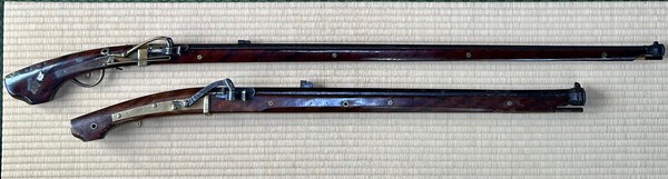

Bugyotsuji Posted December 30, 2025 Report Posted December 30, 2025 You've done a fine job there, Jay. Really something to be proud of, restoring a piece of history like that. Small-bore Sakai guns from the mid-Tokugawa period onwards tend to be flashy, highly decorated for the rich merchants who would buy them, but yours is more understated, which may be because it is an older version.(?) According to Sawada Taira in his book Nihon no Furuju (and he is a proud resident of Osaka), guns of up to 3 Mon-me were sporting guns for hunting small game, or for target practice. Military guns only start from 3.5 Monme (bore of 13.2 mm) and above, most often around 5 (14.95mm) or 6 Monme (15.78mm). When you talk about the wider diameter of the front of the barrel, do you mean the exterior diameter, or the bore? If the exterior, then I suppose a bulge at the end could stop your hand from slipping off the end of the barrel when loading in cold or wet weather. (Last year I came into possession of a long Sakai gun like yours, and then more recently a shorter, heavier 5 Mon-me military version with larger bore.) For reference: 1 1 Quote
