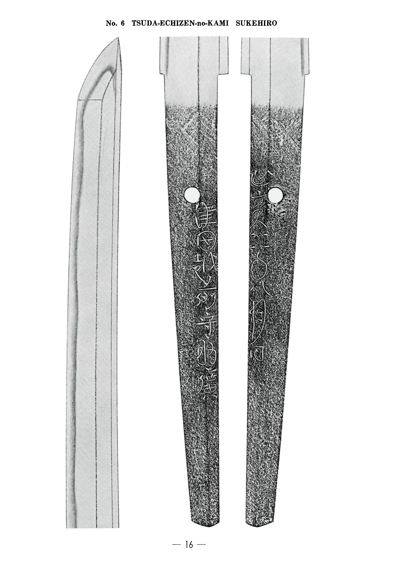

cookiemonstah47 Posted Tuesday at 05:44 PM Report Posted Tuesday at 05:44 PM (edited) Greetings everyone, I am planning on bidding on this sword in an upcoming auction but can't seem to get clear pictures of the signature from the auction house. To me it currently looks like a Bizen blade which is my favorite school but there's no telling how it would look cleaned up. Any ideas on the signature and how do you feel about its condition? Thanks, Khalid Edited Tuesday at 05:45 PM by cookiemonstah47 Quote

nulldevice Posted Tuesday at 06:27 PM Report Posted Tuesday at 06:27 PM The blade looks to be signed Tsuda Echizen no Kami Sukehiro. A Shinto smith who signed in this grass style script. He’s also a Sai-Jo Saku smith so the likelihood of gimei is very very high. Quote
CSM101 Posted Tuesday at 06:44 PM Report Posted Tuesday at 06:44 PM The original: Tsuda Echizen no Kami Sukehiro Quote
