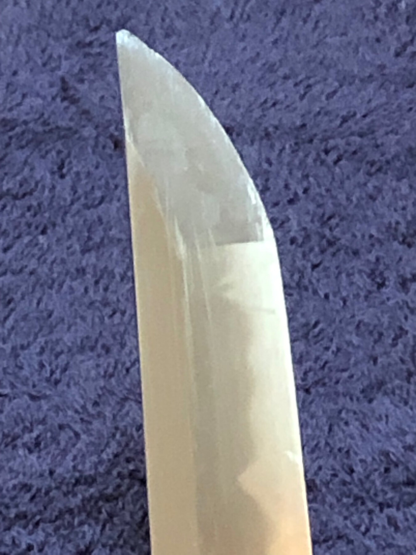

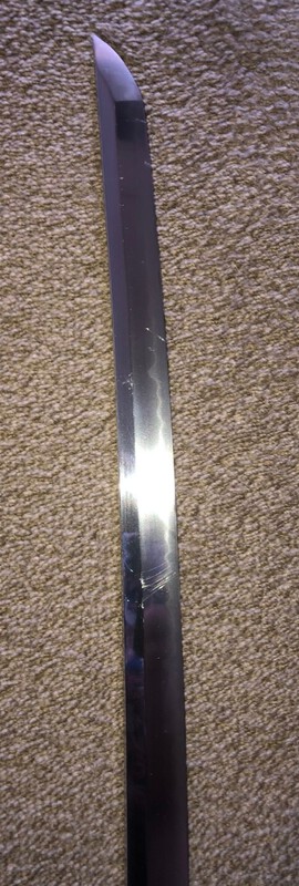

Foletta Posted November 25, 2025 Report Posted November 25, 2025 Does this look like a Kanemoto Boshi ? Quote
Rivkin Posted November 25, 2025 Report Posted November 25, 2025 (edited) I would argue its late Muromachi Jumyo or possibly Kanemoto. Shinto would have sugu boshi. First generations would have more nie, more complicated work, possibly sugu boshi. I don't see periodic groups of three, not a single one strictly periodic, strictly group of three. I see very periodic gunome-togari with a few sticking out. Its Mino, its possible Kanemoto but unless there is an argument missing, I would personally prefer Jumyo. Probably by a significant margin. Edited November 25, 2025 by Rivkin 1 Quote
ChrisW Posted November 25, 2025 Report Posted November 25, 2025 I could see an argument for either, but having been dealing with a lot of Jumyo lately, I would agree that this looks like a Muromachi Jumyo den blade. The gunome/togari, the higaki yasurime, the longer nakago, and the styling of the boshi all point towards this. Early Kanemoto (2nd and later) lineage was a bit more formulaic with their sanbonsugi, which I am not seeing so much here; unless the wear is significant and the hamon has lost much of its original form. This might be a fun one to consider for Shinsa in my opinion! If you do pursue that, please let us know the results! Quote
