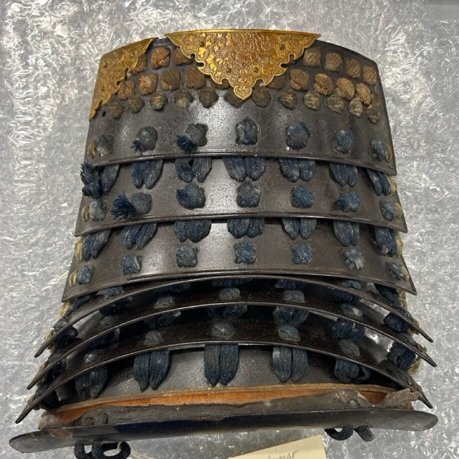

cglog254 Posted November 5, 2025 Report Posted November 5, 2025 Hi all, This pair of kote have hijigane that have an internal storage space inside. They have a simple latch and hinge construction, and are gilt on the interior. I have not been able to find any mention of hijigane opening or having compartments within. Is this a common feature? What would have been stored inside the hijigane? Is this construction indicative of a special use, manufacturing timeframe, or other unique feature? I have attached photos of the kote below, as well as close ups of the hijigane (sadly, one is missing but the interior container is still there). Please let me know if you have any information regarding the hijigane or the kote as a whole (anything unique or indicative to a particular time or place) . Thank you for your help! 1 Quote

Shogun8 Posted November 11, 2025 Report Posted November 11, 2025 What these details do suggest is that the suit of armour was certainly custom and not off-the-shelf, which usually means that the samurai who commissioned it had some means. The length of the frontal kusazuri, the construction of the haidate plates (can you confirm if they are iron?) and the tsutsu suneate point towards an armour meant to be worn on horseback - again suggesting a higher-ranking samurai. 2 Quote
cglog254 Posted November 13, 2025 Author Report Posted November 13, 2025 On 11/11/2025 at 6:18 PM, Shogun8 said: What these details do suggest is that the suit of armour was certainly custom and not off-the-shelf, which usually means that the samurai who commissioned it had some means. The length of the frontal kusazuri, the construction of the haidate plates (can you confirm if they are iron?) and the tsutsu suneate point towards an armour meant to be worn on horseback - again suggesting a higher-ranking samurai. That is so cool! I had figured the armor's original owners had above average means from the gilded decoration and the byakudan nuri on the inside of the tare and the inside of the sode. The haidate plates are indeed lacquered iron, but I thought that was standard? Is it something about the layout or construction of the rest of the piece that suggests it was meant to be worn on horseback? I was able to find information on the suneate suggesting horseback riding, but I haven't been able to find any other information on distinguishing armor designed to be worn on horseback and armor designed to be worn on foot. Are there any other distinguishing features that are unique to or indicative of armor designed to be worn on horseback that I should look for? Quote
Shogun8 Posted November 14, 2025 Report Posted November 14, 2025 The extra long frontal kusazuri were meant to defend the rider against the typical weapons wielded by foot soldiers such as yari and other polearms. Similarly, the construction of the haidate - namely the iron composition and the curved, overlapping plates designed for strength - were meant for defending against ground-based attacks, as were the solid plate suneate. 1 1 Quote
cglog254 Posted November 14, 2025 Author Report Posted November 14, 2025 4 hours ago, Shogun8 said: The extra long frontal kusazuri were meant to defend the rider against the typical weapons wielded by foot soldiers such as yari and other polearms. Similarly, the construction of the haidate - namely the iron composition and the curved, overlapping plates designed for strength - were meant for defending against ground-based attacks, as were the solid plate suneate. Thank you for the information! I had seen similar haidate but I did not know that is what they were indicative of? Quote
Shogun8 Posted November 14, 2025 Report Posted November 14, 2025 Most later haidate incorporated flat plates and were often made in leather. The curved, interlocking ones made of iron like these were likely of Eastern or Kanto origin as used by the Date clan. 1 Quote
