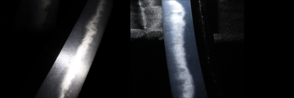

Sukaira Posted Wednesday at 02:55 AM Report Posted Wednesday at 02:55 AM I have a Masayoshi katana that is a masterpiece utushimono to Go Yoshihiro. See pics below...one is an actual Go and one is the Masayoshi Quote
