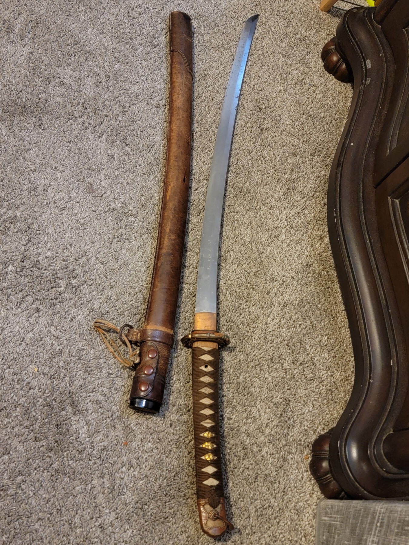

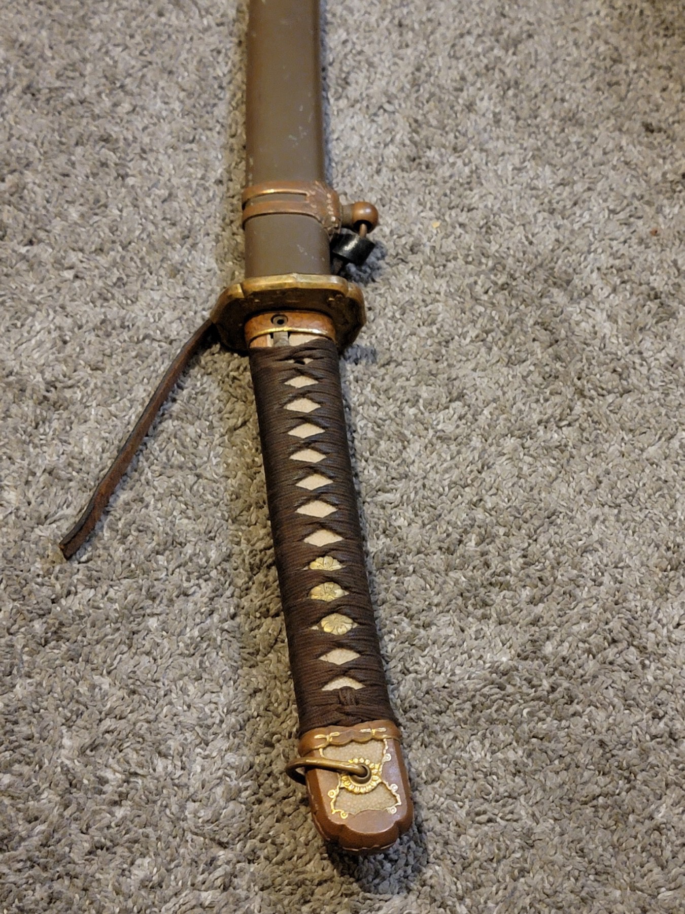

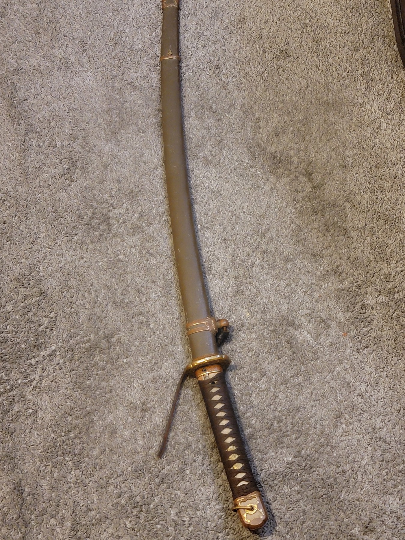

Hello.  I picked up a couple of wwii Japanese Samurai Swords at an estate sale the other day.  I could definitely use some help identifying exactly what it is, what the writing says, and curious as to what it may be worth.  I would greatly appreciate any response.
Dear James.

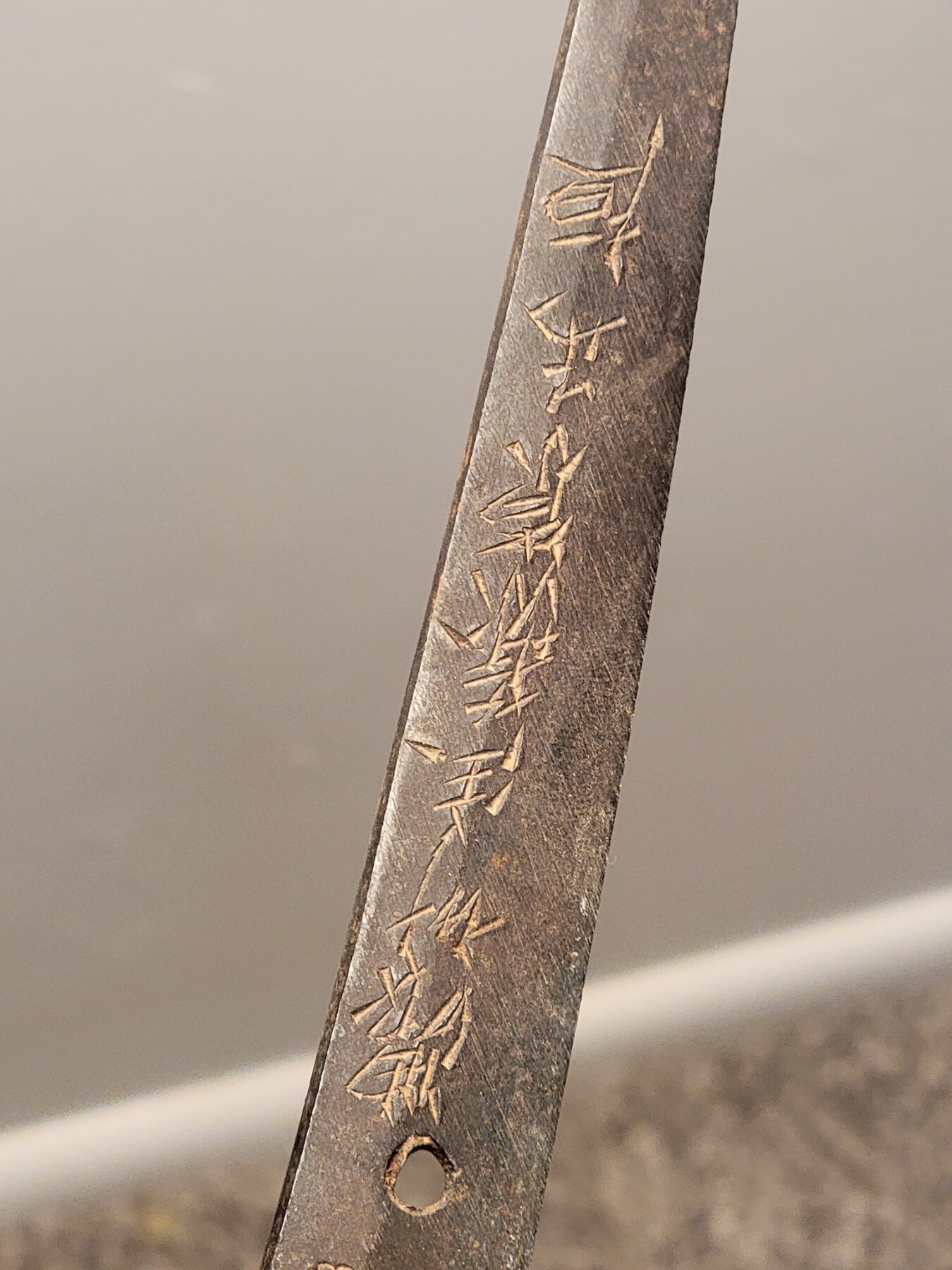

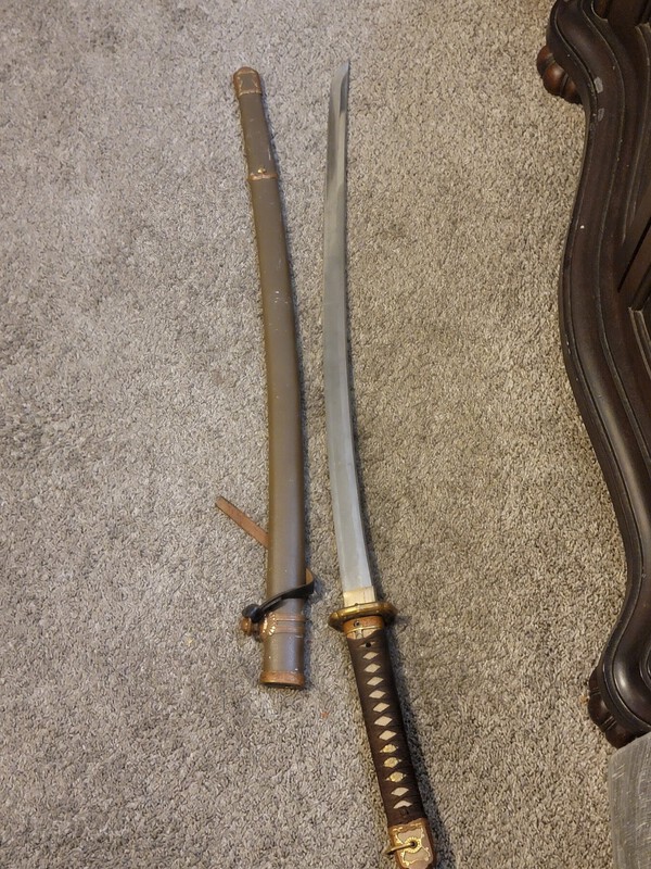

You have posted images of two swords, does the signature relate to the one in the metal scabbard/saya?  If so then there appears to be a small stamp above the signature which confirms that it is a WWII blade, as Ray has already suggested.

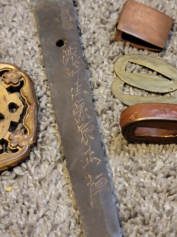

The other sword with the leather covered scabbard/saya and the pierced guard/tsuba is perhaps rather different, do you have an image of the tang/nakago for that one?
All the best.
Hi James!
Like Geraint asked, could you remove the handle (tsuka) of the second sword and show the signature?
The first, made by Masatsune was likely made around 1940-41.  The small stamp is the Showa inspection stamp of the Seki Cutlery Manufacturers Association and not an Army arsenal stamp.  Yours looks like it has a nice hamon (temper pattern)!  These swords vary from market to market, but on average are worth around $1,200-1,400.  The same can be said about your second sword, unless we see that it was traditionally made, which would drive the price up higher around $2,000ish.
