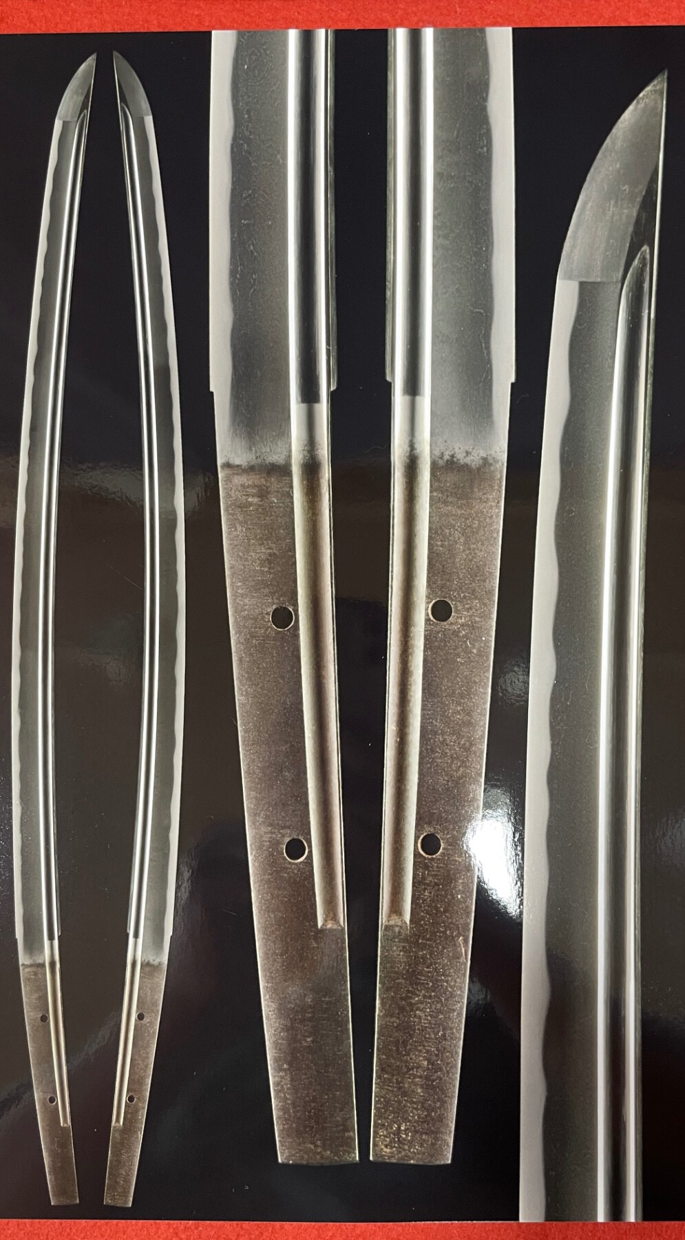

Bosco Posted June 20 Report Posted June 20 Hi everyone, just got a photo of this blade. This is all I got. Base on the shape and size can we tell which one this blade more influenced on ?. By the way it’s an O-suriage, how do we know it’s originally a Tachi or Odachi ?. Thanks all. Quote
Lewis B Posted June 20 Report Posted June 20 What are the measurements? At first glance it appears more Soshuden influenced than Yamato. Quote
Bosco Posted June 20 Author Report Posted June 20 5 minutes ago, Lewis B said: What are the measurements? At first glance it appears more Soshuden influenced than Yamato. Sorry I forgot about this Nagasa : 71cm Sori: 1.2cm 元幅 : 3.5cm 元重 : 7.5cm 先幅 : 2.66cm 先重 : 5.2mm Quote
eternal_newbie Posted June 20 Report Posted June 20 Soden Bizen? Looks superficially like some Osafune Kanemitsu blades I've seen. 1 Quote
Bosco Posted June 20 Author Report Posted June 20 30 minutes ago, eternal_newbie said: Soden Bizen? Looks superficially like some Osafune Kanemitsu blades I've seen. I just googled it and it does look very close. Quote
Bosco Posted June 20 Author Report Posted June 20 Just now, oli said: Yamato Shizu? I saw one in Utrecht This is what others told me. It’s a mixture of Soshu-Yamato Shizu and little bit of Mino. 1 Quote
oli Posted June 20 Report Posted June 20 an example of: https://www.aoijapan.com/katana-mumeitransmitted-as-yamato-shizuthe-37th-juyo-token/ https://eirakudo.shop/token/tachikatana/detail/206481 Interesting school, i like it. Quote
oli Posted June 20 Report Posted June 20 also a good source about soshu: https://www.nihonto-museum.com/swordsmith/masamune-no-jittetsu 1 Quote
Jacques Posted June 20 Report Posted June 20 Sorry, but I don't practice the art of divination. The hamon seems to be based on notare which is a characteristic of Soshu den but I can't say more. We should know if the hamon is in nie deki or not what the size of the nie is, what the structure of the hada is etc. 1 Quote
Ooitame Posted June 20 Report Posted June 20 The kissaki and boshi lead to an impression of utushi of some sort. Quote
