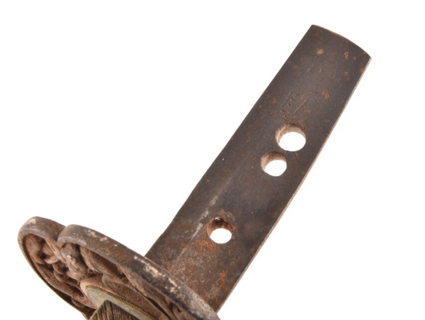

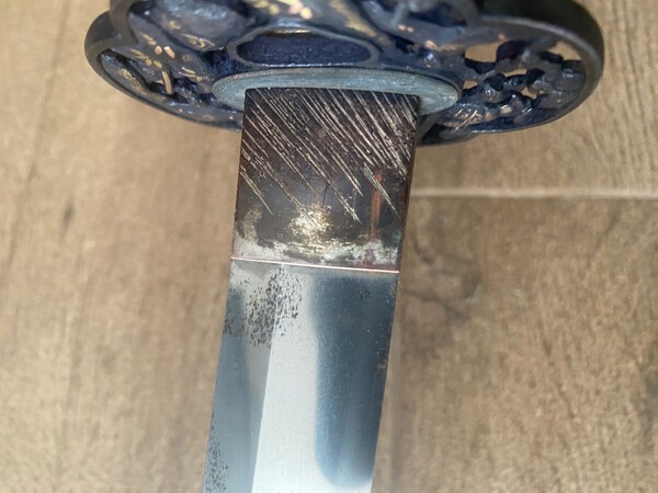

Mercator Posted June 7, 2025 Report Posted June 7, 2025 Hello everyone! Please help me with the translation and identification of wakidzashi. Thank you! Quote
Bugyotsuji Posted June 7, 2025 Report Posted June 7, 2025 Arthur, the Mei on the Nakago of your wakizashi says 則光 (Norimitsu) 1 Quote

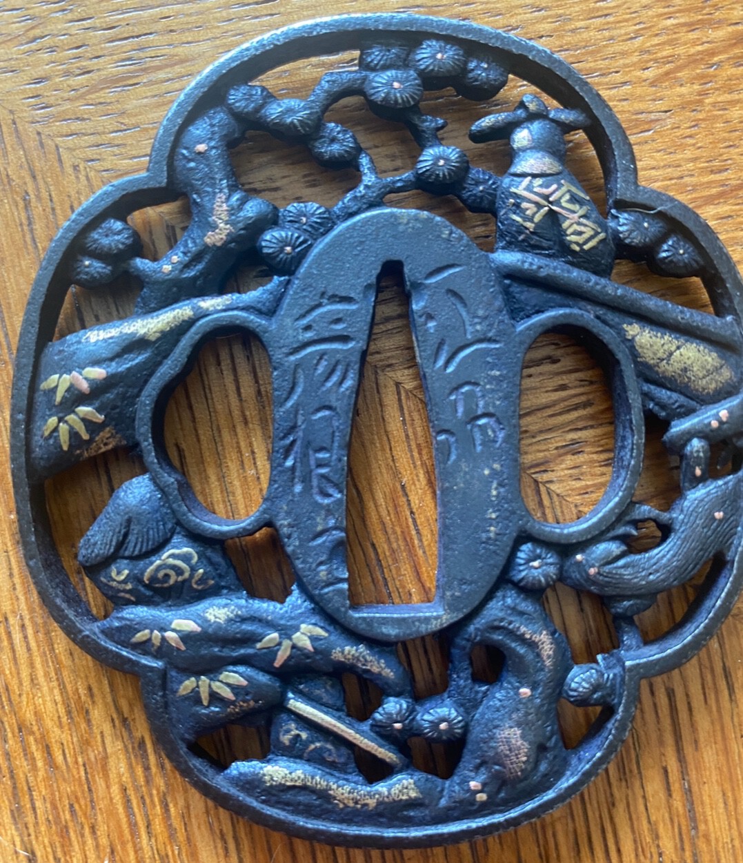

Mercator Posted June 9, 2025 Report Posted June 9, 2025 On 6/7/2025 at 3:18 PM, Bugyotsuji said: Arthur, the Mei on the Nakago of your wakizashi says 則光 (Norimitsu) Thanks! Can you help me translate signature on the tsuba? Quote
Bugyotsuji Posted June 9, 2025 Report Posted June 9, 2025 Yes, these have come up many times on this NMB site. Check out ‘Soten’ (Sōten) school tsuba. Quote
