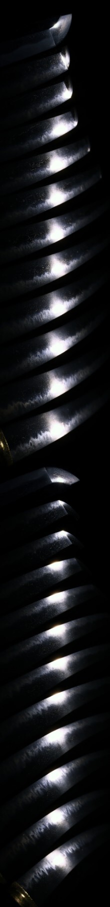

How do you know this blade is healthy?
It's not easy to tell from the photo, but especially the Ura side comes to me without reflection, which means the hamon is almost dead in the monouchi
I repeat - don't rush
And if it helps you - it wasn't that long ago that I reacted the same way you did

Almost no reflexion at the mono-uchi ura side ? This is too much of an high fly to me. Please, can you teach me ?
Sincerely,
Eric
I believe Brano is talking about the ura (Inside) in this case would refer to the bottom photos since this is listed as a tachi. The reflection of the nioiguchi doesn't look as bright as the omote monouchi or the nioiguchi further down the sword. Now this could be a photograph thing and really in cases like this, its hard to capture this without seeing it in person. Its still a wonderful looking blade and a Juyo Ko-Ichimonji that is signedis nothing to scoff at. Way above my collection level at the moment. This would be a fun blade to study in person. But perhaps these little things (if we're discerning correctly in the photos) are what would make this "only" a Juyo sword and maybe not a TJ sword. But that is nitpicking way above my paygrade! I'd be honored if I can one day own swords of this caliber.
Sincerely,
Eric
I separated the ura side from the photo and then divided it into the top and bottom of the ura side
Maybe it will be clearer now
However, as I said, it is impossible to draw definite conclusions from the photo and Norinari is undoubtedly a rare swordsmith
Yes I see it now, thank you very much.
I didn't get it and light angle could by really tricky.
I'm definitively not able to tell the différence betwen Juyo and TJ.
Both looks just fantastic to me...
Still learning.
Thank you,
Eric
