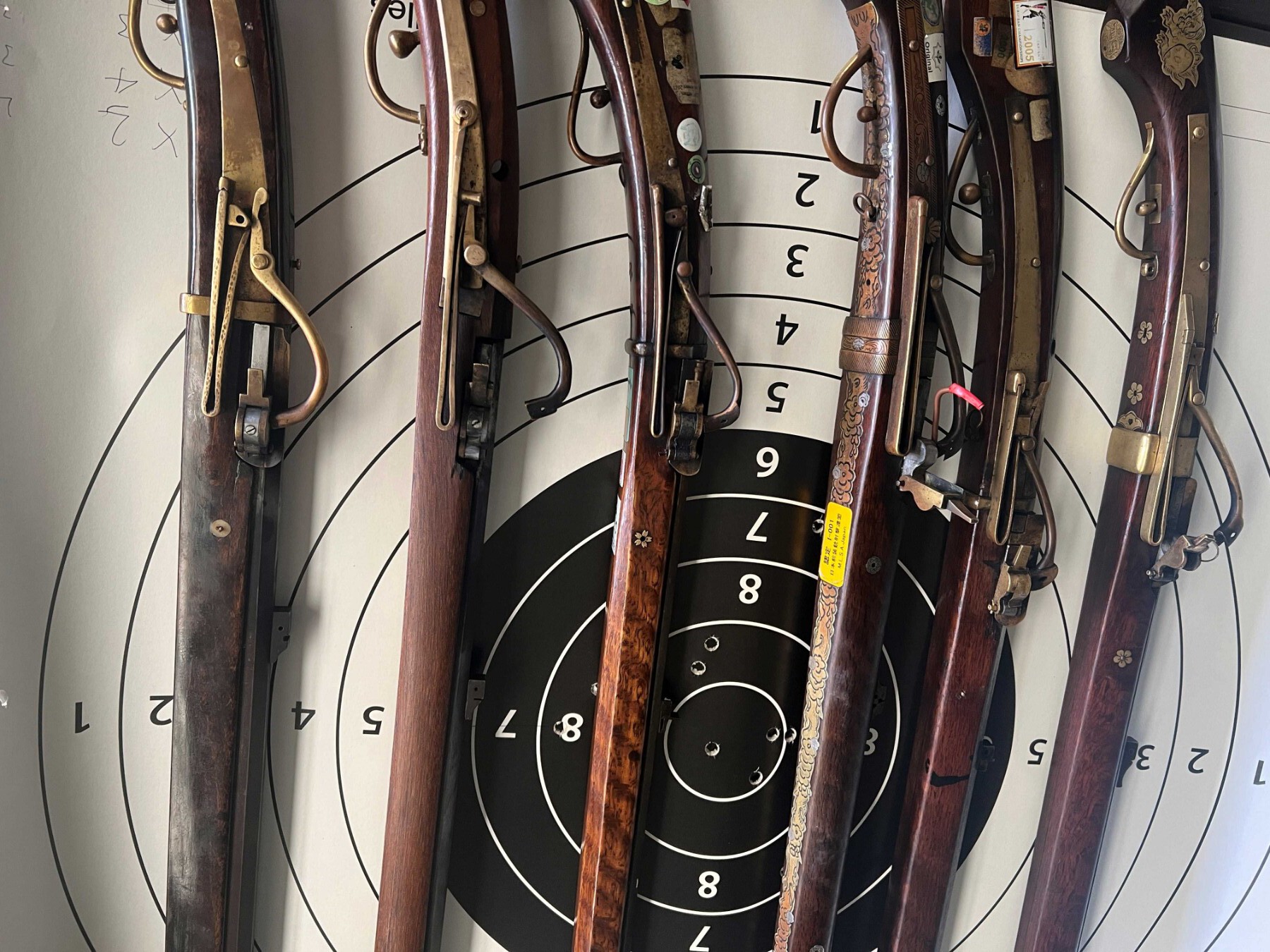

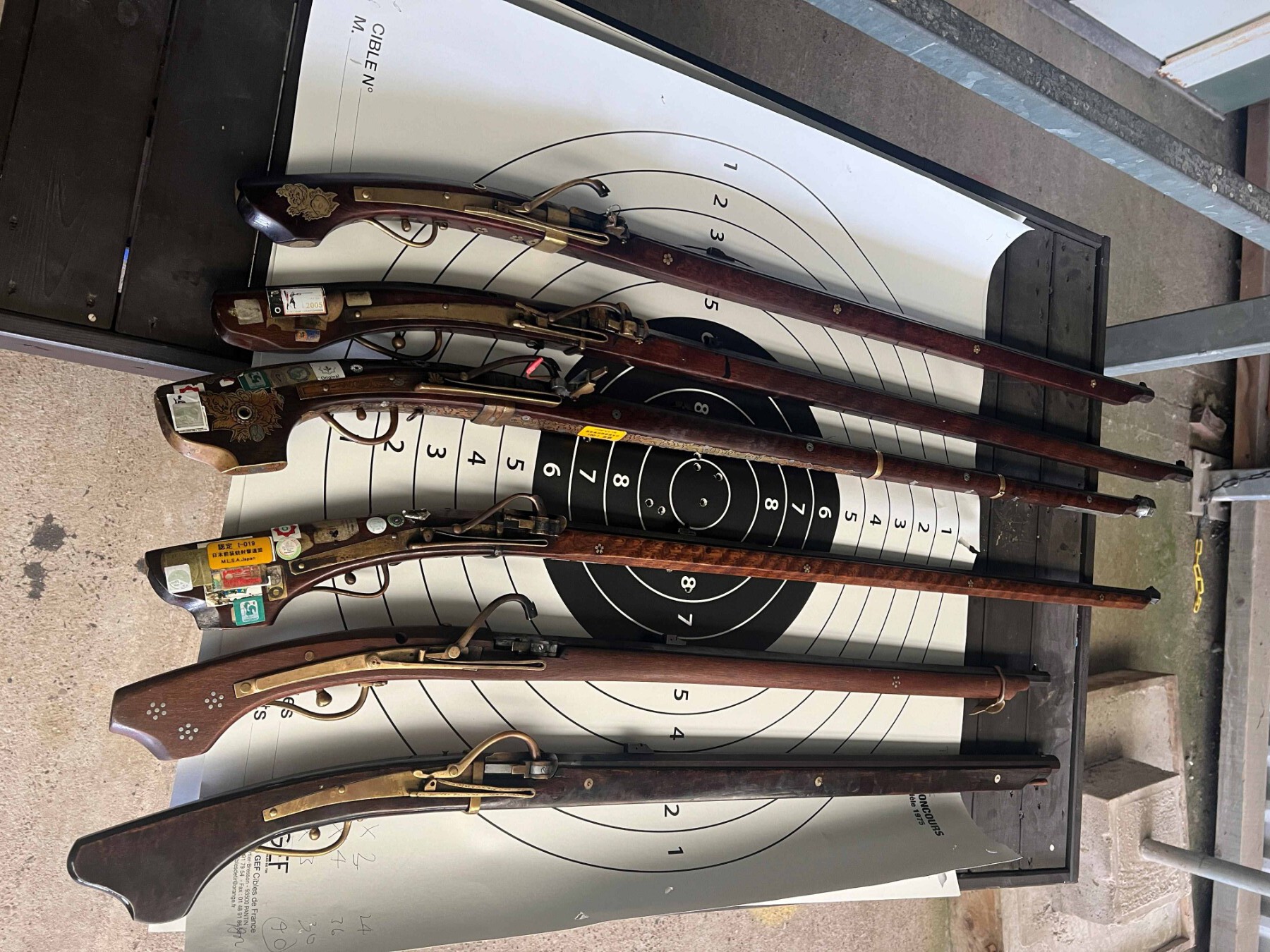

redhugster Posted April 9, 2025 Author Report Posted April 9, 2025 Hi Piers Thank you for comming back to me. No need to appologise! Understood with the Pistols, They do come up here in the UK from time to time. I'll just have to be patient and one will find me in due course if it is meant to be! Cord wise I'm pretty proficient (as are others here in the UK) at producing the finished and treated cord, but the quality of the untreated cord is obviously important. I have made enquiries and a friend in trying to contact the previous cord supplier in Japan to see if he is still making / supplying it (in 300m rolls). I will update you in due course as it would seem that this is topic comes at a good time for you too. I shoot with the MLAGB in competition at Warwick (Midlands UK) and when I can, internationally for GB. A well treated and good quality cord is or paramount importance as you know for consistant and quick ignition. I know others here on this forum shoot in the MLAIC competitions and in their home nations. The below are a few of the Teppo that were used in a competition here last summer. Best Jon 1 Quote
Bugyotsuji Posted April 9, 2025 Report Posted April 9, 2025 Thank you for the detailed reply, Jon. Wow, that's quite an impressive collection you have! Have you ever been to a competition in Portugal? Quick question. The target holes look consistent. Do you have a separate-sized ball for each gun, which you have to keep track of, or have you managed to source barrels that all take the same size? Or is yours just one of these? I'm pretty sure that the cotton match cords used here in Japan do not use any added substance, relying solely on the natural oils in the plant. I do have a section of genuine old cord for static exhibition of artefacts though, which seems to be made of very thin woven threads of cedar bark, possibly. The latest batch of cord that we have nearly run through is slightly too narrow for my pistol and long gun, so I have placed some tape inside the serpentine pinch flaps as I do not want to bend them.The previous cord was woven differently, but just the right size. For the hand cannons, we have sections of a fatter cord. Thanks for the kind offer. Don't worry about me, though, as it will be someone's responsibility here to order a batch. If I find out who makes it, I'll let you know. Quote
redhugster Posted April 9, 2025 Author Report Posted April 9, 2025 Hi Piers, Sadly only one of the Teppo in the picture is mine, the others are from 5 other members of the association who shot that day... Including John H-S who is the current MLAIC World Champion. The target under the Teppo was shot by my friend Paul. I shot in Portugal at the World Champs a few years ago... I did rather well with my .577 Original Enfield Rifle in the free rifle (Vetterli) class. I shot a 96 and came 7th. The four above me also scored 96, but with purpose made arms for that class (with adjustable sights). The Enfield is of course a military arm with fixed iron sights, I'd have liked a medal and if I had shot that the day before in the Military Rifle Competition, I would have taken a silver. This years competition is again in Portugal in Braga... Its a brilliant range in a lovely area. Jon 1 Quote

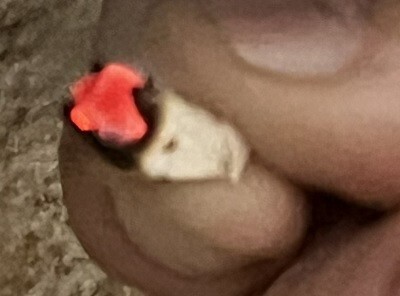

Flint62Smoothie Posted April 11, 2025 Report Posted April 11, 2025 On 4/9/2025 at 2:25 AM, Brian said: Not difficult at all to make your own. There are hundreds of resources online. Check these out: https://www.muzzleloadingforum.com/threads/preparing-matchlock-rope.190347/ (especially post #3) FWIW that is the recipe that my friend Hilton (who made post #3) and I use. Simple! I am now making some using the potassium carbonate powder for boiling the lignin out in an attempt to define the best accurate measures/portions of the ingredients, as Hilton just dumps some in. The cordage I am using is 9-strand braided hemp procurred from Etsy and it came from the UK. This picture below is not cord, but tinder - just dried 'tree fungus' (not even nitrated!) made from birch polypore. It burns HOT without ANY ash head on it! So far the braided hemp burns hot almost as well, and without much ash residue, although one should 'tend their match' (blow across the breech, with pan over closed as per Jacob de Gheyn) for best results before a shot. 1 1 Quote
