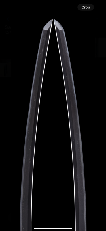

This is going to be my first purchase, any advice on this Nihonto ?. According to the dealer the condition is Old polishing, but generally excellent in its present condition for conservation, appreciation. This is all the photo I got. Comes with NBTHK Tokubetsu Hozon certificate.
Looks like a very old, but also very worn blade.
I hope the spots on one side of the monouchi are not umgane, but just loose welds. It's really hard to see.

I can't say much about the blade you posted, better (and more) pictures could help you to get more opinions. Looks like O-suriage Koto blade. Thin Suguha and Hamachi might suggest it has seen multiple polish. Might be showing core of the blade (as @sabiji pointed) due to that. What is the blade attribution per NBTHK

 Hi , the NBTHK attributed to Senjuin Yamato den.
Its a long blade @71.4cm. I won't post the link as that is the perogative of the poster. But its clearly had many polishes and a lot of the activity is compromised. Basically its tired. I think I would be looking elsewhere for my first early Koto blade. The Senjuin FS here on NMB is a much better example IMHO.

Thank you so much. Your comment very accurate. Is there a way to learn to check the blade health/condition ?. I tried to look at many sources but couldn’t find anything.

The obvious things: the small hamachi distance, from where nakago ends and the Ha (edge), mentioned earlier and the motokasane measurement. In this example its 0.49 which is thin for Yamato Gokuden, suggesting the blade has seen many polishes.

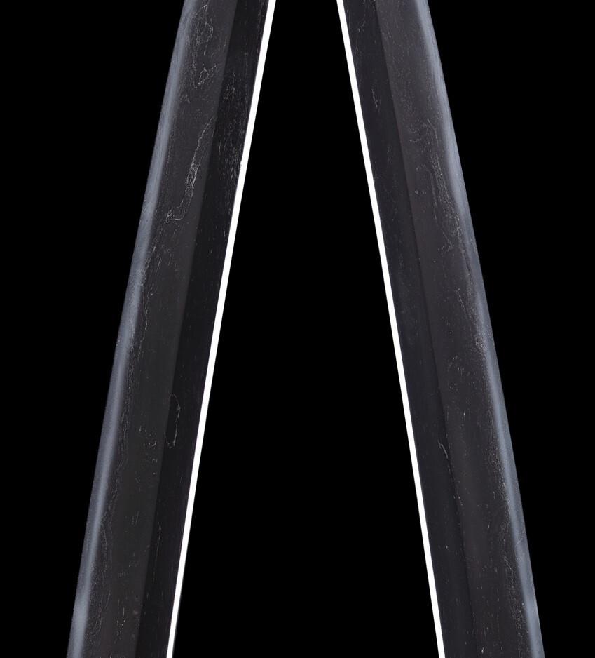

Higher rez image of the monouchi area

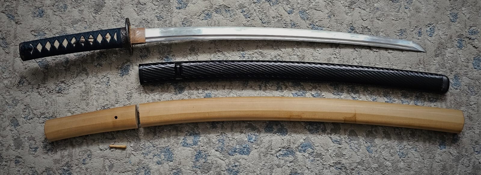

I can sell you mine Koto Bizen Osafune Wakizashi. It comes with very nice Koshirae too.
Check this out: https://www.militaria.co.za/nmb/topic/48905-could-it-be-bizen-kiyomitsu-which-one
I can sell it for 2750$ + shipping costs.

This is just my guess, the edge of the blade seem thicker than the one I posted ?. As in it it still has lot of meat .
