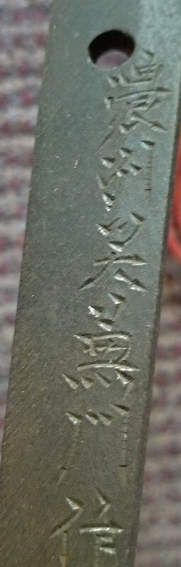

sugarsnout Posted February 16, 2025 Report Posted February 16, 2025 Hi folks Can I get some assistance on this ww2 sword mei? I think it was kanekado of gifu made this. 1931. Cherry blossom stamp. Many thanks folks Quote
Bruce Pennington Posted February 16, 2025 Report Posted February 16, 2025 2 hours ago, sugarsnout said: Hi folks Can I get some assistance on this ww2 sword mei? I think it was kanekado of gifu made this. 1931. Cherry blossom stamp. Many thanks folks Marc, Could I get a shot of the date-side and showa stamp, please? I suspect it's later than 1931. I've never seen one that early. 1 Quote

sugarsnout Posted February 16, 2025 Author Report Posted February 16, 2025 Hi Thanks for helping. My sword man on Shikoku was most sure...🙂 but who knows. 1931, I think. I lost his paper I took notes on, torn up everything looking but no go. Hope these pics help. There are no numbers or stamps anywhere else. Quote

Stephen Posted February 16, 2025 Report Posted February 16, 2025 Have you posted the other side? 1 Quote
moriarty Posted February 16, 2025 Report Posted February 16, 2025 Seems there is no fixed date for this one.. Quote
Stephen Posted February 16, 2025 Report Posted February 16, 2025 Okay I misunderstood you said and now the year I thought you were going to show the other side that had a date. It has showa stamp so in the 40s 1 Quote
Conway S Posted February 16, 2025 Report Posted February 16, 2025 Gifu stamp appears on swords from 1930s, but 1931 is too early. Conway Quote
Bruce Pennington Posted February 16, 2025 Report Posted February 16, 2025 I am away from my chart right now, but the earliest dated blade with the showa stamp is 1935. The massive majority of them show up in 1940 and 1941. So you probably misunderstood “1931“ to be 1941. Quote
Stephen Posted February 16, 2025 Report Posted February 16, 2025 KANEKADO (兼門), Shōwa (昭和, 1926-1989), Gifu – “Kanekado” (兼門), real name Yoshida Tokuichi (吉田徳一), born March 29th 1906, he worked as a guntō smith and died September 6th 1969, student of Kurihara Kaneaki (栗原兼明), ryōkō no jōi (Akihide), Fifth Seat at the 6th Shinsaku Nihontō Denrankai (新作日本刀展覧会, 1941 1 Quote
