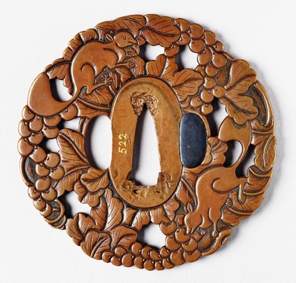

Hello,
My friends just purchased this nice iron tsuba ( 80mm by 83mm by 3-4 mm) and was curious about dating and any other information  that anyone could  provide on it, only 3 to 4 mm thick so thinking that might help with dating, has a roman numerical 63 painted to inside surface so come out of someone's collection/ museum collection at some stage.
Many thanks!
Namban/Hizen? Squirrels in the grapes. A common theme but not seen very often in namban. Difficult to tell age of namban as very few were signed [if any?]
Copper version here from the Ashmolean museum. https://jameelcentre...ction/8/object/21150  I show the ura view, you can find the omote on the link [ura difficult to find]
