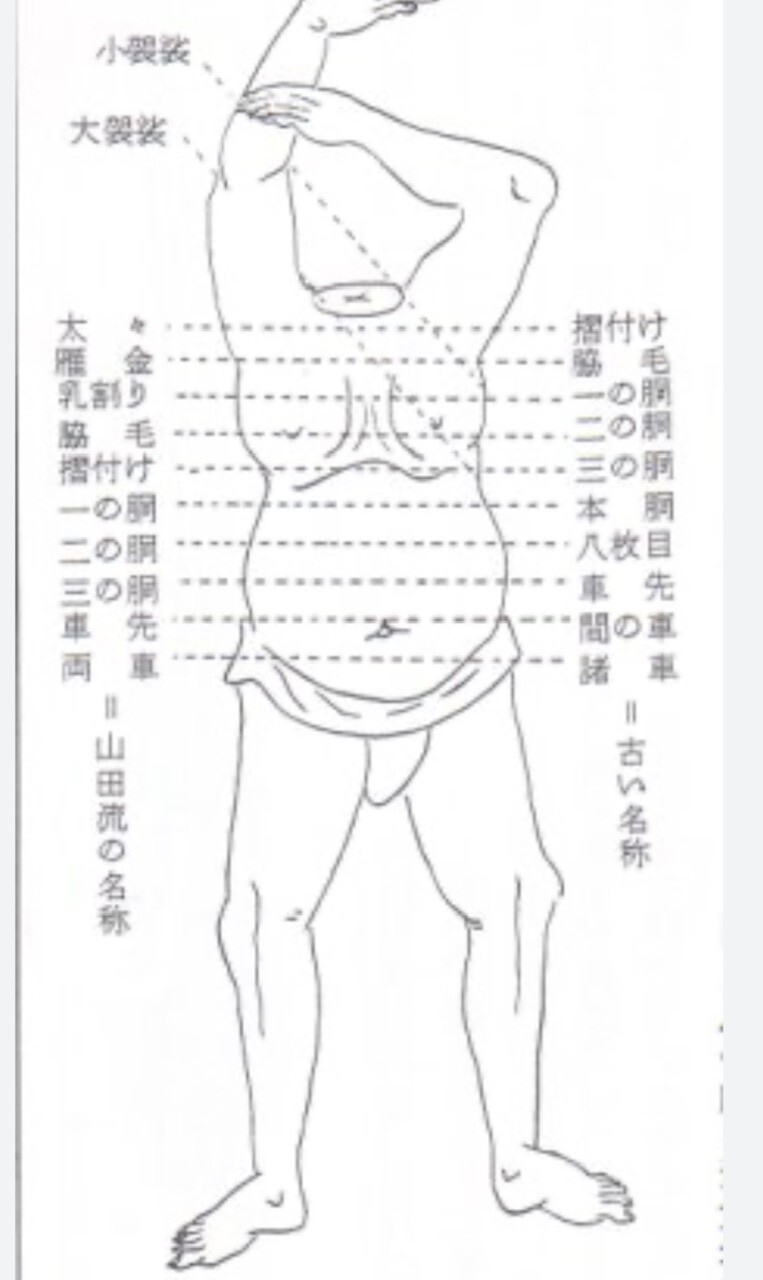

There were indeed three positions across the middle of the do, 一の胴、ニの胴 and 三の胴 (Ichi no dō, ni no dō, and san no dō) among others, but that is different from what we see inscribed in gold. 賦ツ胴 Futatsu (no) dō means two upper bodies, IMHO, and I’ll stick with that until someone proves it otherwise.
For example, this shows Yamada school on the left, old names on the right.

As far as I know, Georg‘s Masayuki has a cutting test result on its nakago, where the performed cut is called golden wild goose. Probably each standard cut has such a specific name.

I HAVE Markus' book "TAMESHIGIRI".  The photo you reference is on page 174:
On the next page, 175, Markus discusses multiple examples of cuts, 3 cuts through one body, one cut through 3 bodies, 2 body cuts, etc.  And these were described on the nakago in detail.  He also mentions blades that were tested multiple times by 2 different testers.
