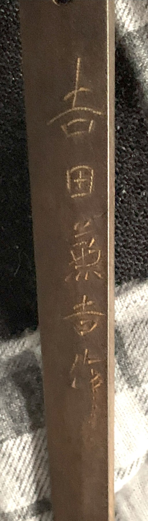

I found a sword my great-grandfather brought back from the pacific it’s a gunto
but there’s no numbers on the tang there’s an inscription I asked someone and they said someone named yoshida made it any info?

the tang photos are upside-down. Please load them up here on this site.
YOSHIDA is correct, but we will have to see the full blade (tip-upwards, directly from above, light from the side, dark background) without HABAKI (copper collar) to make a guess. It could well be a copy made after the war, but I am no expert in this field

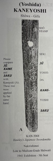

well there is a KANEYOSHI (兼吉), Gifu,  real name Yoshida Ushinosuke (吉田丑之助), he worked as guntō smith, Fifth Seat at the 6th Shinsaku Nihontō Denrankai (新作日本刀展覧会, 1941)
Below is an example.  But note on your sword the "yoshi" is incorrectly cut (like by a non Japanese?).  Not sure what this means.  Best you show more of the sword and fittings.
Added another example from F&G, hard to read but shows Seki stamp and correct "yoshi"
Mal are you refering to how the box at the bottom of the kanji was cut?
Japaneseswordindex.com has 2 Kaneyoshi.  Here's one with a similar yoshi:
I'm totally uneducated, so forgive the question, but could this be a case, like the multitudinous variations of how "kane" is cut?
But to add to the mei question, I'm seeing black same' (rayskin) and the ito (handle wrap) is of the late-war & post-war souvenir color.  So still waiting to see the whole rig, with more details.  But maybe this was a very late war sword and mei cutting was done by inexperienced workers.
3 hours ago, mecox said:
I was referring to the cross strokes on "yoshi".  The top one should be the longest.
Ah!  I see now.  Hm

Your photos aren't close enough, nor detailed enough, of the blade to say for sure.  Slough's book said he made medium to low grade showato, so it's most likely not traditionally made.

Mei was above nakago Ana.
True gendaito, miss it, should a could a sword.
What i mean is are you saying its a gendaito? I finding it hard to determine anything since only the name is on the tang no dates stamps or anything.
