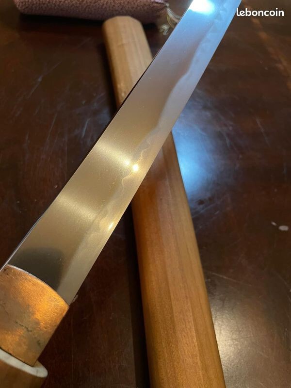

hello,
a new one in my budget... (I'm staying in the same topic to avoid spreading myself too widely over the forum, I hope it doesn't get in the way)
It's a tanto this time, here's the information I have:
Quote
Hira-zukuri Tanto in Shirasaya,
With JASMK certification,
Mumei so unsigned attributed to 会津兼定 Aizu Kanesada
As the photos show, this particular blade has a beautiful Hamon with a clean Jigane showing the excellent skill of the smith. No catastrophic damage or imperfections were observed, overall in very good condition for collecting or study.
I found the hamon strange, or it's just my lack of knowledge ?
Thanks

Hi, this is probably the nicest Nihonto you have posted.
Smith wise the Kanesada swordsmiths are well know with a lot of information. The Aizu Kanesada were a branch of the Kanesada smiths with 11 generations from from 1556 when the 4th generation Kanesada moved to Aizu, with the last 11th generation smith working into the 20c.
The papers ( JASMK certification) are issued by a sword merchant in Japan, it’s not a bad indicator of what you are getting. It’s not Hozen papers so they don’t have a market value themselves and are not a gold standard..but give you the opinion of someone who does know Japanese swords and are a nice to have and as you know the school of smiths and the branch gives you some foundation for study.
The blade seems to be in reasonable condition and Polish, there seems to be a mark on the kissaki, Price wise its what I have paid for equivalent condition Tantos with hozon papers, but I then had to pay 5% import charge..so slightly less than what I paired for an equivalent blade with papers ( but hozon papers do add value and make it easer to sell).
it may be worth trying to ask for a closer picture of the mark in the kissaki and using the mark to seeing if you can get a bit  of a price reduction..if you can get a reduction of 10-15% it’s probably a reasonable deal for a first Nihonto.
All in all I’m not seeing any red flags…it’s a budget Nihonto in Polish that will make a reasonable first piece to study…so it’s all about the price and getting it as cheap as you can. But I’m only a couple of years into the hobby so get some wiser views than mine.

As you didn’t explain what you mean by ‘strange’, my following statements are a bit of a guess.  I think what you see as strange is the difference between the actual hamon and the hadori polish… it may look almost like ‘two hamons?’  It is fairly common especially with a heavier hadori polish to have some difficulty seeing some of the activities until you can differentiate between the two.
Bingo, yes, I also thought of a polishing specificity.
It may be a common look, but I have to admit that it bothers me a little...

This one is sold for 700€, I don't know if that's a fair price for a Tanto in this condition
Always difficult as something is worth what someone will pay for it. So all I can say is would I pay £610 ( 700eu)..if it had a hozon paper then yes I would, without, probably not that much…but I tend to put quite a price on have a hozon papered blade as a minimum…as it’s a first blade you would properly end up studying and selling on so making sure you get your money back is important…iI would think if you got it for 575-600eu you would get your money back in a sale……but it’s aways iffy
