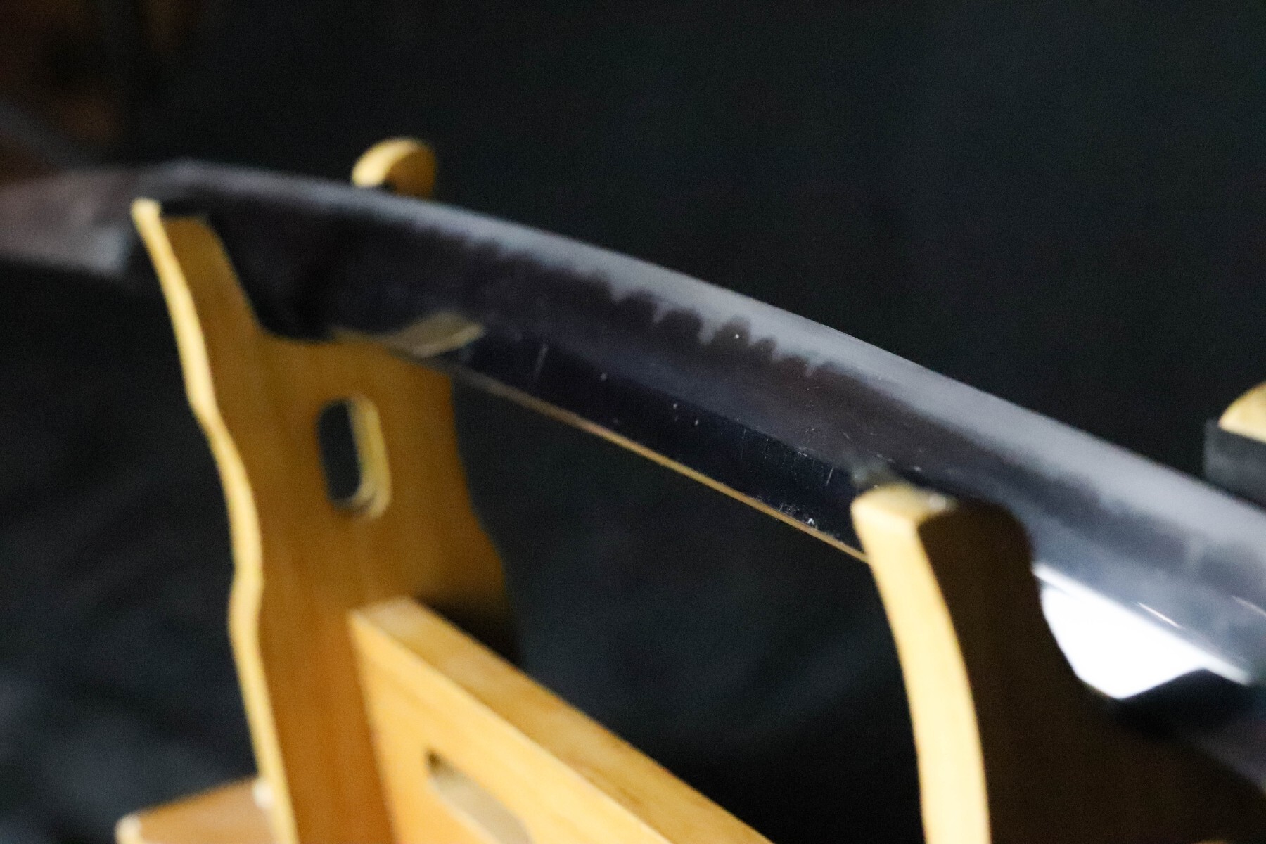

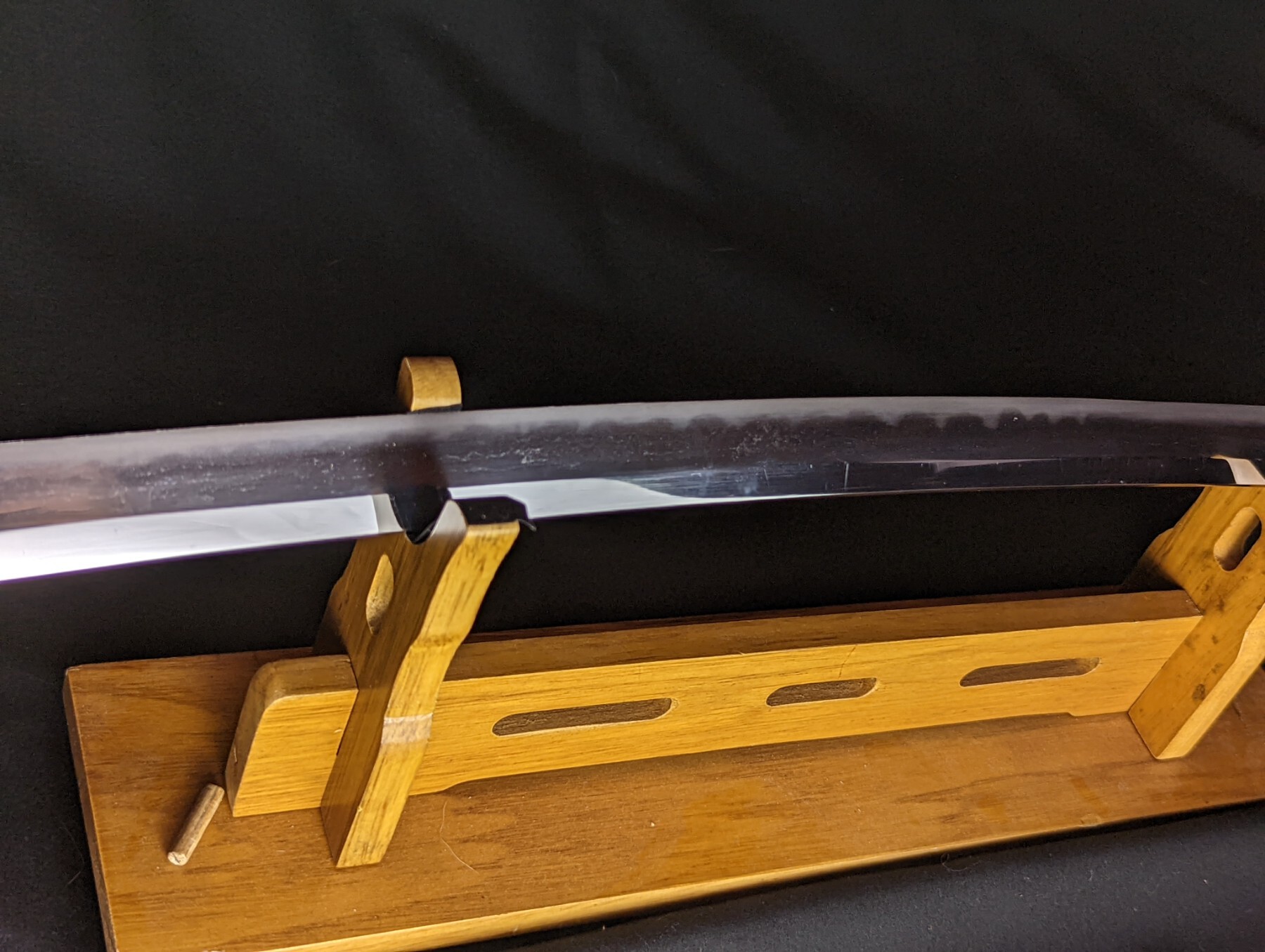

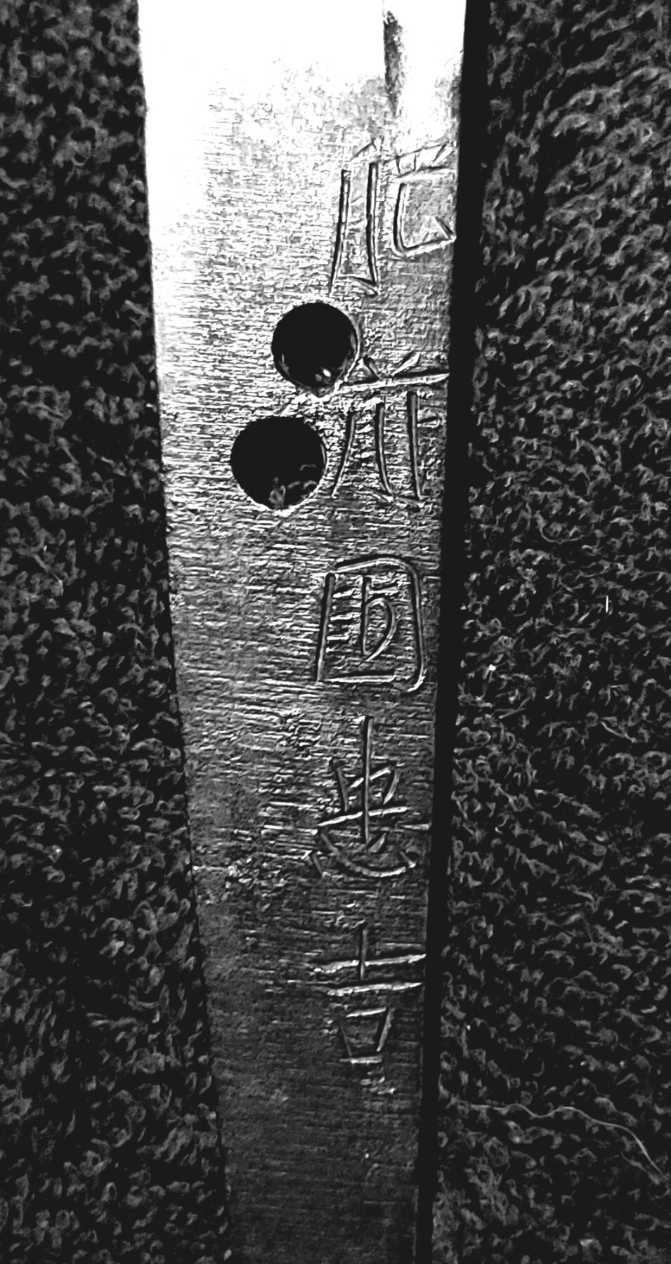

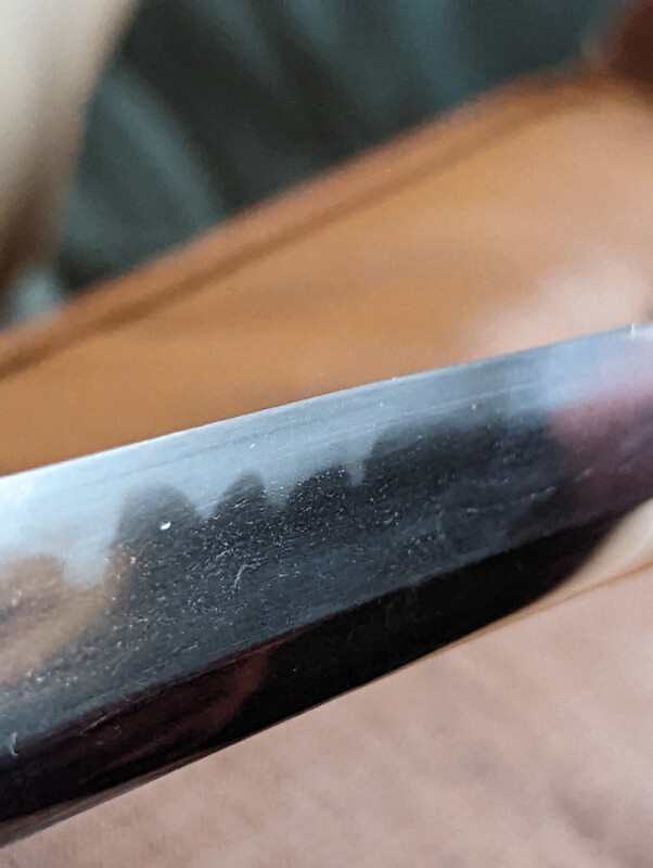

Hi guys,
Thought I'd share something I got fairly recently.
I picked it up in an auction with the mei mistranslated.

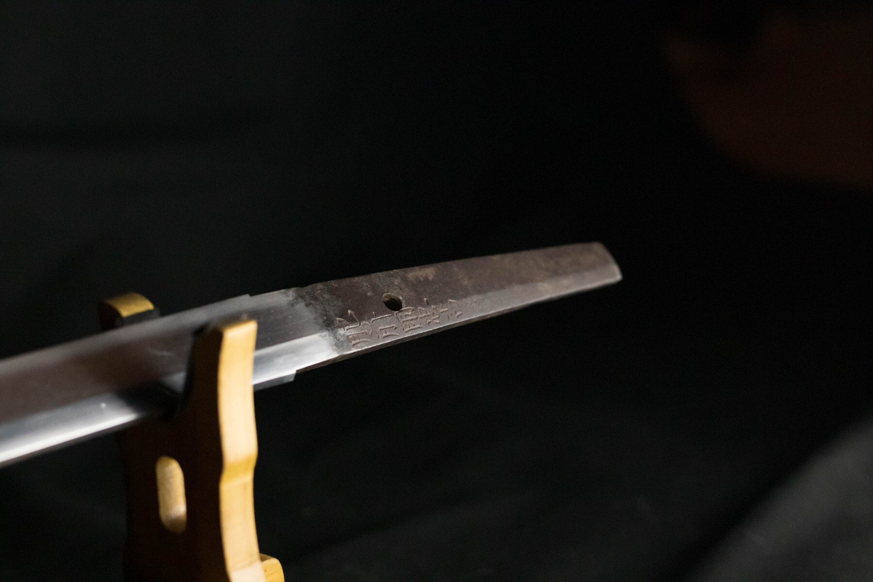

I don't know if it's gimei or not. The hamon is mostly what seems to be choji gunome but starts on one side as suguha.
I know a large percentage of the Tadayoshi work is suguha but also that most of the gimei Tadayoshi are suguha too.
I don't know the generation or age.

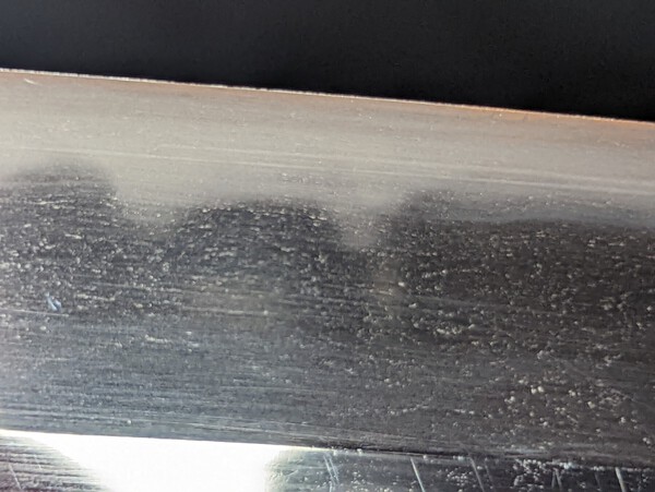

It has very faint nie.
What are peoples opinion's on this one?
First impression is that it is gimei the hamon is also atypical. Can you let us have some dimensions? In the meantime I'll hit the reference books to double check the mei
Atypical hamon ? why please ?
Yes Jacque I agree the broad belt nioiguchi is a feature of his later work and those of his successors. His early work had much greater variation
I said the hamon was atypical because I have not previously seen a hamon with the acute togari peaks seen on this blade. They look more mino than Hizen (to me)
Measurements
Nagasa 61.6cm
Nakago 15.5cm
Kissaki 3cm
Yokote 1.5cm
Sori 2.5cm
A fair few tobiyaki
struggling to see the exact boshi shape

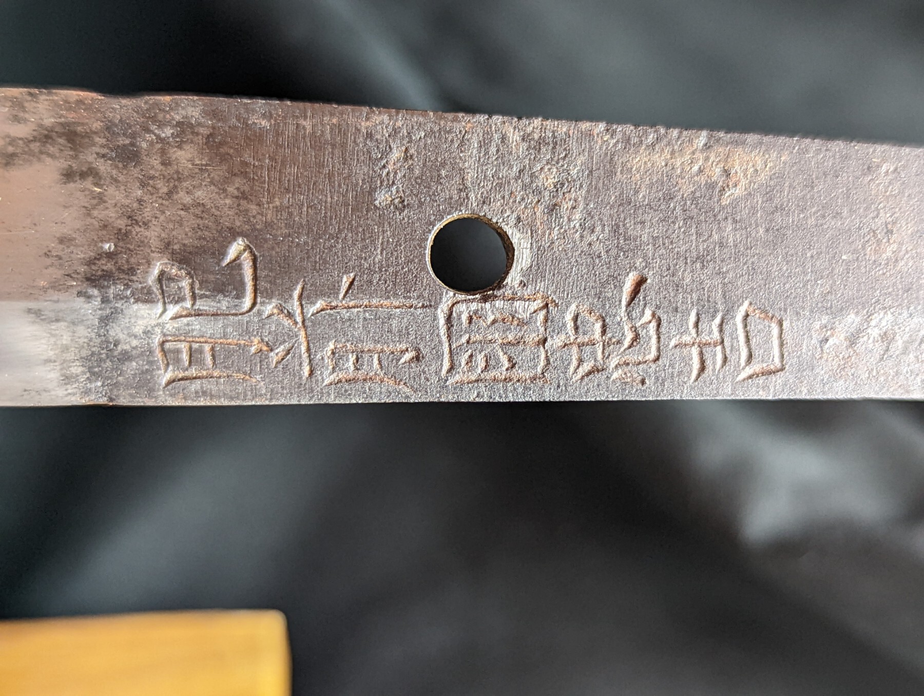

The fact that he was the most prolific smith of the Shinto era, I believe, was because he could work in many of the 'old' styles.
Older works did have midare with togari-ba and later his signature chu-suguha. I've seen some notare examples also and mine is a total Shizu utsushi! Needless to say - personally - my most favorite Shinto smith. As for your blade, my gut tells me gimei but I'm hoping I'm wrong. Cheers.
J.
look at this one
Well thank you all for the comments and opinions! I will do some more reading and expanding my knowledge. I like the sword whether it is gimei or not.
Cheers all
That's what matters. Keep in mind there are few strokes that are missing in your signature however based on the Jacques example I'd say it looks pretty close - hamon and hada..
Cheers
J.
