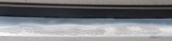

Below: Sadakatsu versus Masamune, I did not process either image to the fullest yet.
As with most shinshinto and especially gendai which carries some study of Ikkansai Yoshihiro's approach - Sadakatsu's "Masamune" will have only small nie which does not sparkle too much and all forging lines are going to be pristine and well defined.
Masamune will have at least two fukure, everything will be three notches brighter, nie size will be all over the board, transitions much more natural and irregular.
G'day Kirill,
Thank you for that comparison. I agree that generally a Gassan Sadakatsu will exhibit uniform ko-nie and clean, well defined forging lines. Below is a comparison of a Gassan Sadakatsu in my collection done in masame on the right, with the Masamune photo you supplied on the left. It would be nice to be able to compare them in the same light.
Cheers,
Bryce
