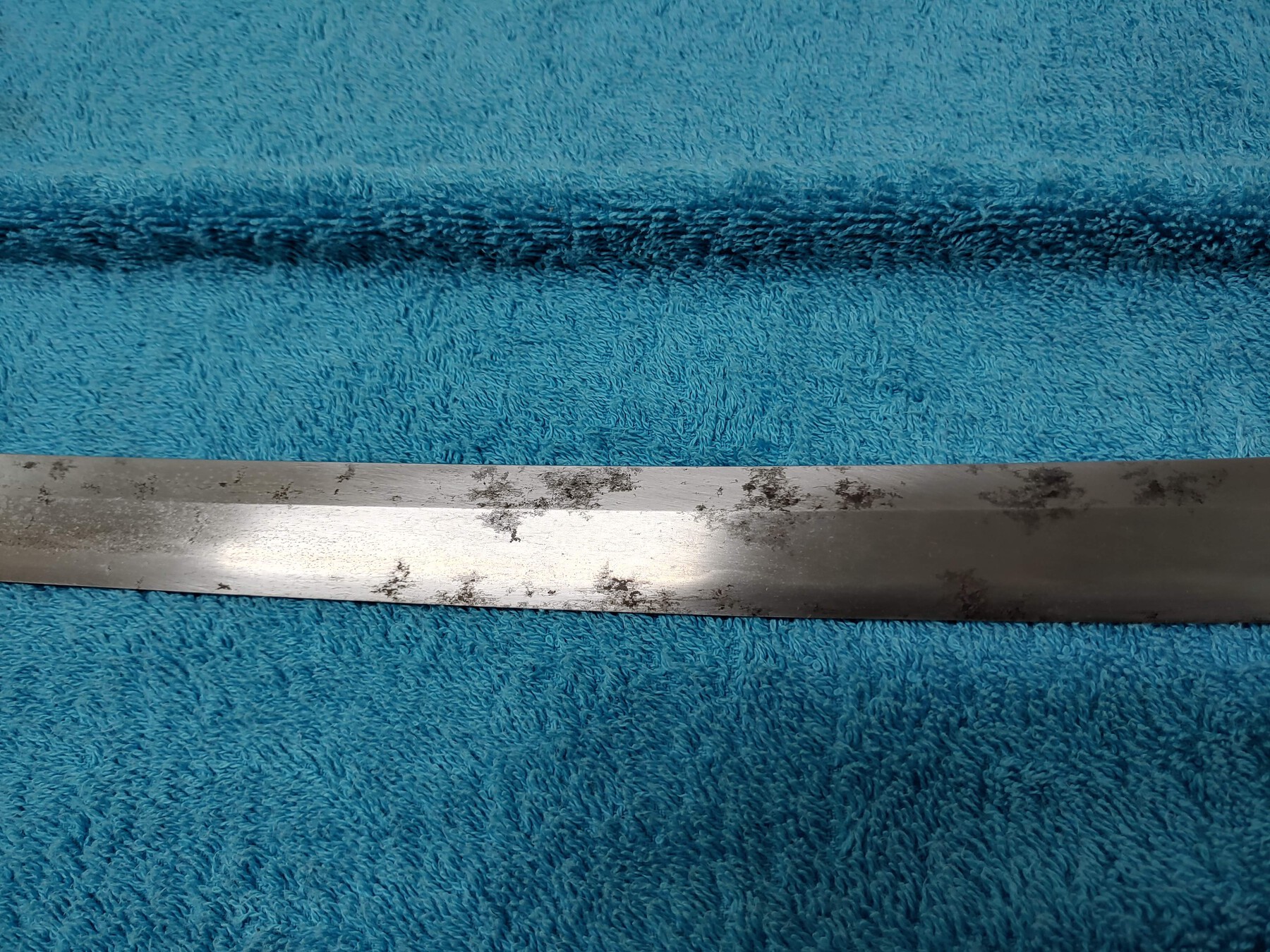

The Katana has a nagasa length o 73,5cm. The yokote line is hard to spot but exists ever so faintly, like a shy Will-o'-the-wisp. The hamon appears to me to be a notare-midare hamon, with long, very irregular waves. I do spot a lot of ware and a fukure. I am but a humble beginner at the art of appreciating nihonto, so I don't think I know enough to say much more of relevance. I don't find any mei on the tang and I find the blade's curvature rather pronounced, but that's the extent of my knowledge and I can't begin to atribute any era for the blade's manufacture.

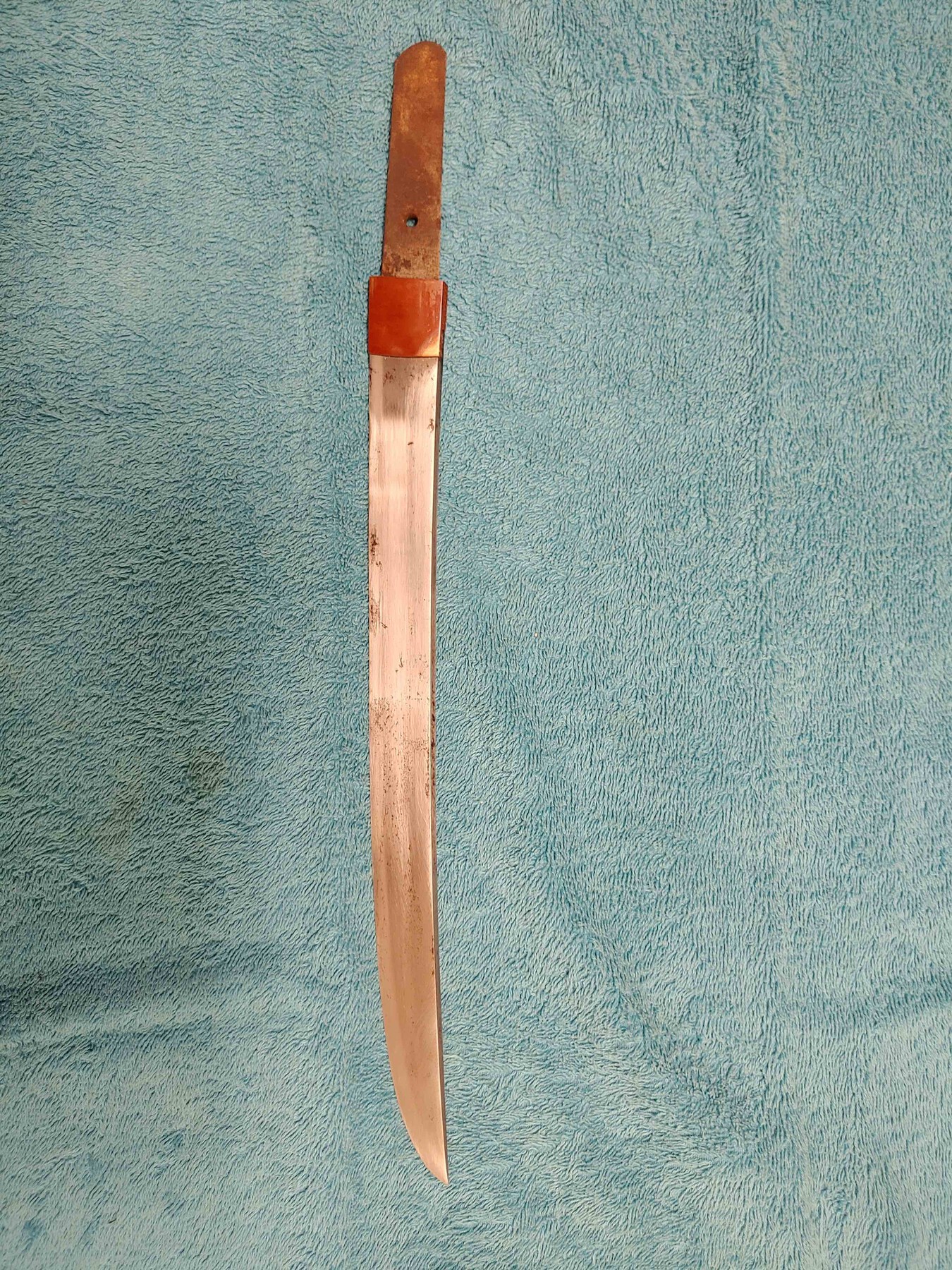

As for the tanto, it has a nagaha length of 31cm and a Suguha hamon. I find it very healthily shaped and doesn't have nearly as many flaws as the katana. I am also unable to find any mei on the tang. The fittings of the tanto came with a kogatana without the kozuka. This workmanship on these tanto's fittings is marvellous. The details in the insects is mind-blowing to me.

Welcome to NMB.  The kozuka depicts a demon with a drum and the blade with it is nothing more than a paper knife.  You have rescued these, now you are faced with the difficulty of knowing what to do with them.  First step is to take of the habaki and lightly oil the blades.  Clearly both now need a professional Japanese polish, some of our European members might be able to recommend who to use if you decide to go down this route.  However, looking at the nakago of the katana it seems thicker than the blade which suggest that it has already had several polishes, given the depth of some of the rust patches it might not survive another.  The koshirae looks OK for this sword.
The tanto looks healthier and does not seem to be so badly damaged, more hope for this one.  I like the mounts, though again they need some restoration.
For now learn what you can from them and stabilise the rust as far as you can.  Take careful advice and decide what you want to do with them.

I have already oiled the blades, hopefully stoping all rusting for the time being. The katana does indeed look like it has been polished a lot. Could this indicate that it is rather old? I would be inclined to say its curvature reminds me of older blades, but once again, my knowledge is very limited. As for the tanto, it does indeed look much healthier than the katana and I think it might be worth polishing. I'm most curious to understand how old both these blades might be.
