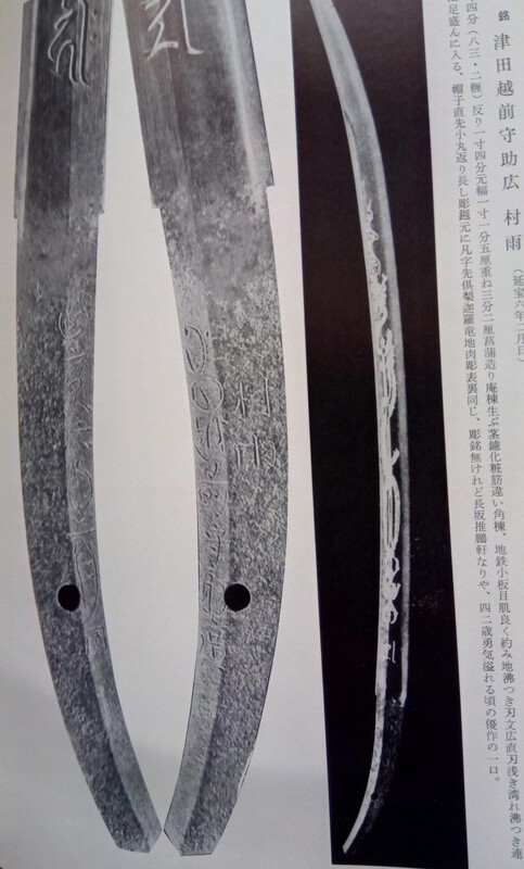

Jussi Ekholm Posted June 16, 2020 Report Posted June 16, 2020 I would second Jacques in this that the 2nd ana was probably done for different mount. I will borrow few Images from Seskos Meikan as I feel it is the easiest way to show the consistency that Jacques was talking about. You can note that few examples in there have 2 ana too, just note the one in the consistent place is the original and second one an add on. I should have at least c. 60 oshigata by this smith and I do believe they pretty much follow the same pattern. I don't actually know much about Sukehiro or his work in general as I don't focus in swords of this age. Quote
Brano Posted June 16, 2020 Author Report Posted June 16, 2020 I would second Jacques in this that the 2nd ana was probably done for different mount. I will borrow few Images from Seskos Meikan as I feel it is the easiest way to show the consistency that Jacques was talking about. You can note that few examples in there have 2 ana too, just note the one in the consistent place is the original and second one an add on. I should have at least c. 60 oshigata by this smith and I do believe they pretty much follow the same pattern. I don't actually know much about Sukehiro or his work in general as I don't focus in swords of this age. IMG_20200616_193626.jpg IMG_20200616_193633.jpg Thank you Jussi, The view that the blade is machi okuri originated from the missing yasumire near the hamachi (see posts 8 and 10) Quote

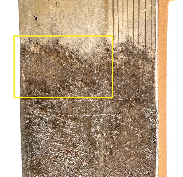

DanielLee Posted June 17, 2020 Report Posted June 17, 2020 The yasurime is the part which makes me wonder. It appears that looking at the ubu examples, the yarurime end at the polished part of the blade. Perhaps its ubu but the entire nakago was once rusted over so after restoration there is a portion of the nakago which has patina but no yasurime. The Iidakoendo example also has the yasurime ending quite a distance from the ha. 1 Quote
Brano Posted June 17, 2020 Author Report Posted June 17, 2020 This could be a rest of marks from yasurime Quote
