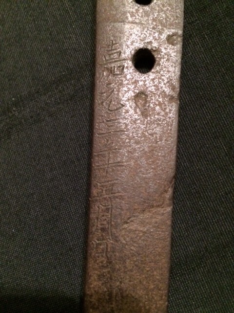

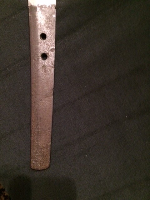

Dear Morita-san:
Thank you for the oshigata of the Marquis Satake oshigata from 1927. Thank you also for clarifying that the oshigata at page 194 only has two mekugi-ana.
I have some photos of the nakago of the Nakahara Kunimune I examined years ago. The nakago in the attached photos look to me to be of the same nakago as the one pictured at page 194 of the Toko Meiji Taikan. Would you agree? I thought you would like to see the photos. I really appreciate your expertise and kindness in providing me with this very helpful information.
Best regards,
Bill E. Sheehan (Yoshimichi)
