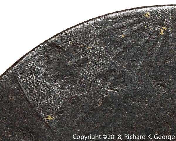

Here's another tsuba from the last batch I got.  Its a bit of a head scratcher.  The tsuba was labeled ko-shoami, but I don't know...
post-204-0-55573900-1516128832_thumb.jpgpost-204-0-43636700-1516128881_thumb.jpgpost-204-0-09686100-1516128926_thumb.jpg
The beastie measures 75.9mm (H) X 75.4mm (W) X 3.94mm (T, seppa dai), 4.32mm(T, max)
the piece's raised areas appear to have been created by etching the ji back, and the "nunome" is curious - it appears that a sheet silver was attached to the surface which was then crosshatched and then a bit of gold was applied to that here and there - again, I didn't shoot a microscope image, but here's a close-up showing the details...
So, should it be binned as ko-shoami, Hoan, what awa shoami, or...?
comments apprecated.
thx,
rkg
(Richard George)
Richard -
That type of etched (?) raised work like the closeup pic I usually associate with Hoan although I don't usually think of "nunome" with Hoan. Nice tsuba but a bit of a puzzle.
Rich
I was wr... Not right.  after spending some more quality time with the microscope (and blocking one/the other gooseneck light to get some depth), I realized that what I thought was silver is actually just the patina being really really thin on the high points (can you say er, enthusiastic cleaning) - my bad... I'd add an edit to the above, but i seem to have gone beyond the magic time to to do that....
rkg
(Richard George)
