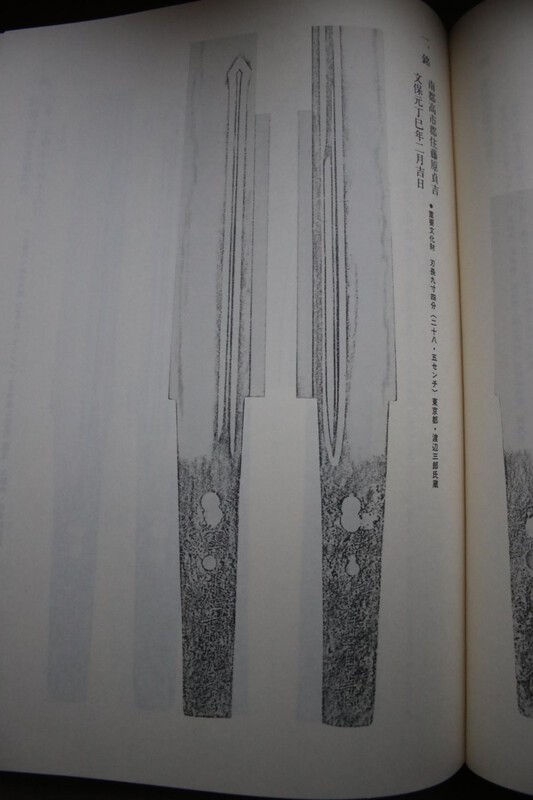

Hello All,
Can you help translate the mei and date?
I see "Yamato Kuni Hosho ??" for the mei but I may be way off base with my translation.
I am totally stuck on the date. I took many photos with my phone and posted what I thought was the most legible.

Normally  Sadayoshi or Sadamune should follow Hosho Goro
It doesn't appear to be suriage to me. What are your thoughts why the nakago is missing the name?

Don't know (even if i have an idea). Works of these 2 smiths are extremely rare
From NBTHK oshigata book
