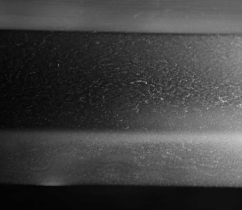

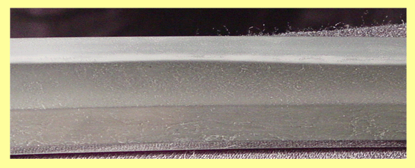

well it's another example of thinking you are getting a handle on something and then prove you know absolutely nothng!
As said in earlier posts I have had the chance to look in considerable detail at a chu-Aoi blade over now nearly 10 years. It is decribed as having classic chirimen hada of the Aoe school. It looks nothing like this swords jigane.
Also according to the NBTHK dan utsuri appeared in the late Kamakura/nambokucho as did saka choji with backward slanting ashi.
All the Ko-Aoe swords (and most chu-Aoe) I have seen first hand have much tighter hada than this and jifu.
So what conclusion can de draw. The authenticating bodies are inconsistant/ We (me) are interpretting their descriptions too literally and not allowing for variation
Or as I fear I am wasting my time trying to understand this subject!
Images of Chirimen hada from Aoe Tsunetsugu from late kamakura
Jussi illustrated well what I am talking about. I think in this case even more dramatic.
