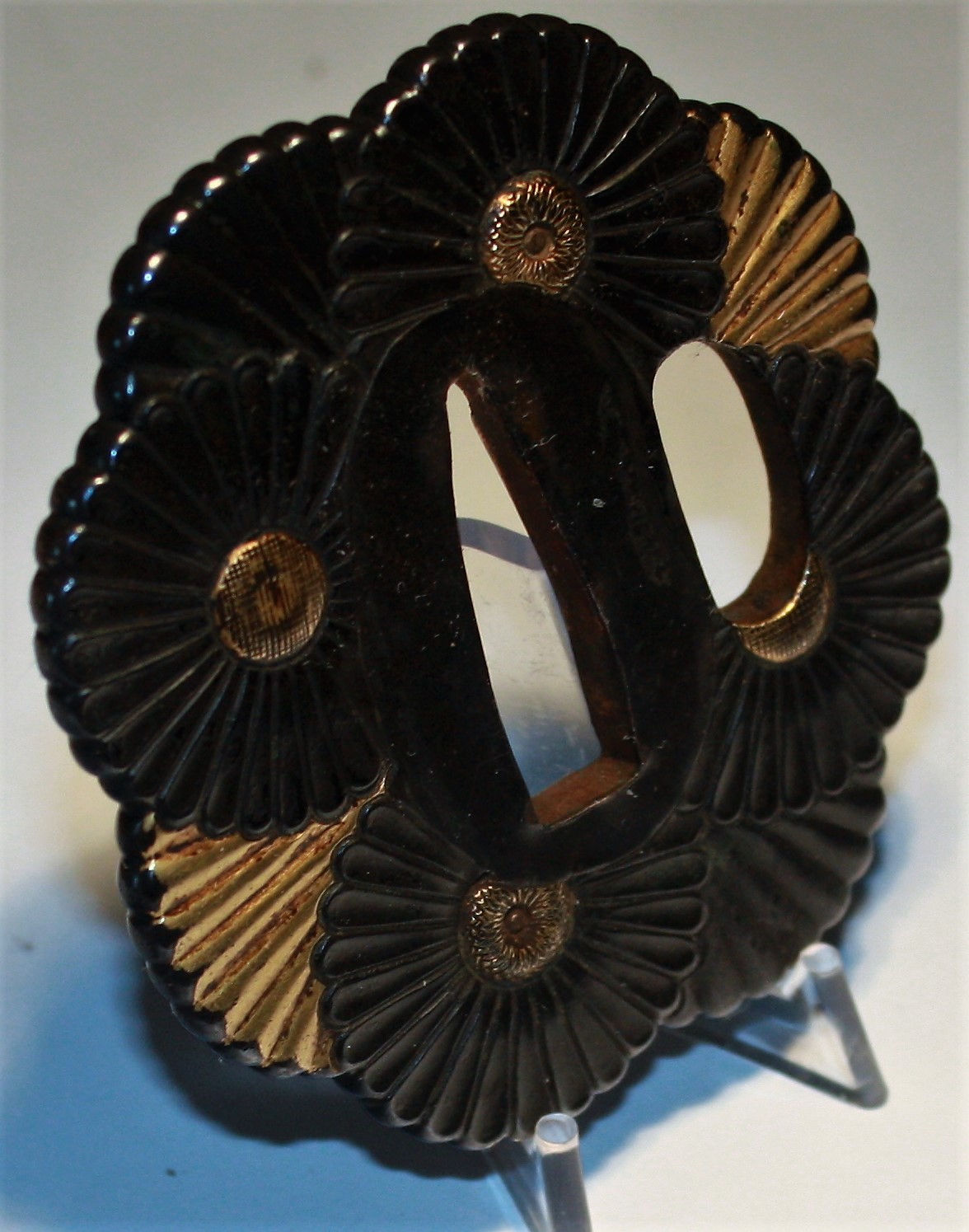

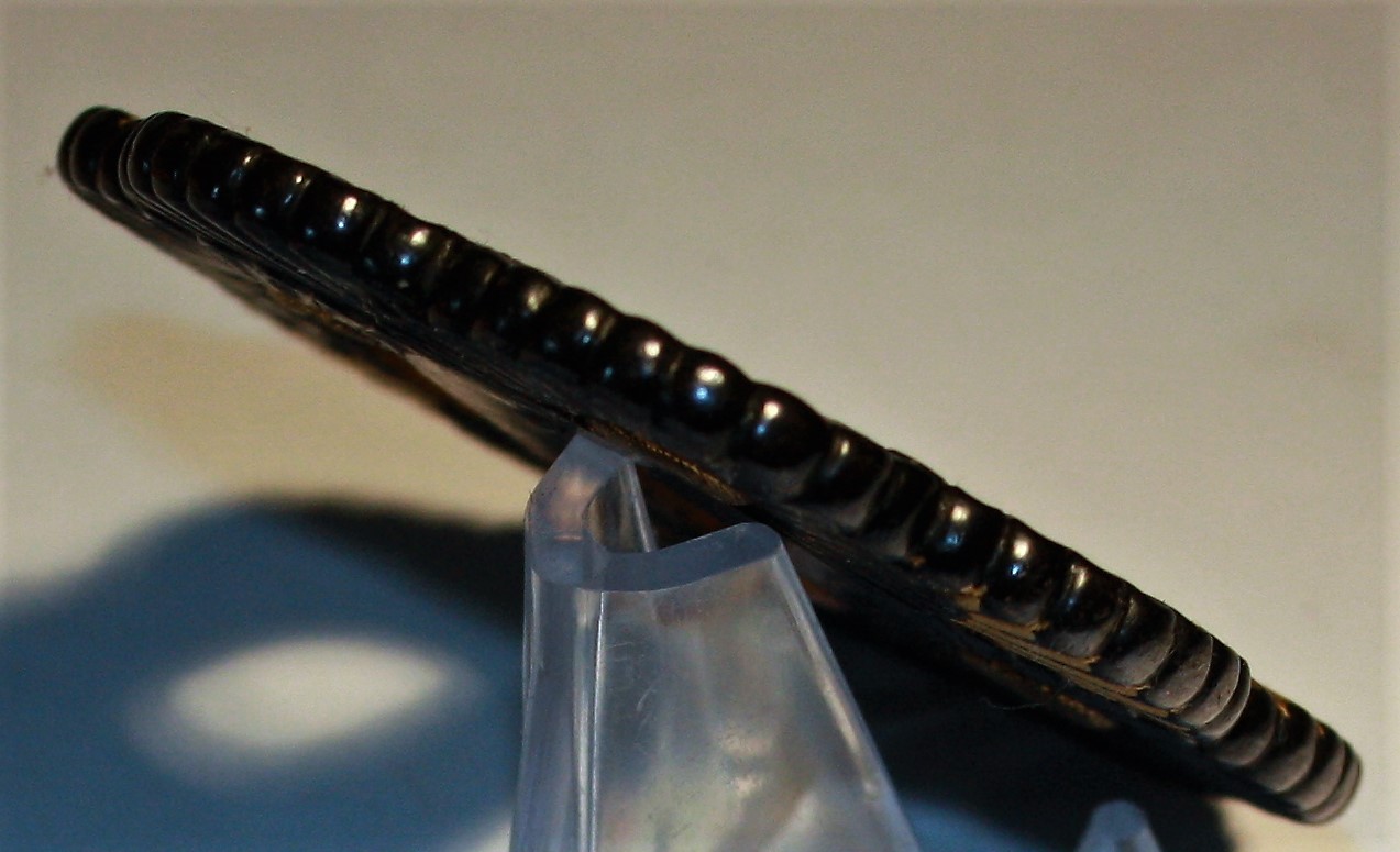

This is the tsuba I'm struggling with to try to date. It was sold as pre-edo. I don't know what color pre-edo shakudo base metal should look like, or whether at that time a thin layer was annealed to a core of copper?? Try to imagine a brighter copper in the walls and it will be close to what it looks like. (little irregularities in a few of the petals are not from casting; they're some trace of goop, I presume to protect it. Thanks, John I
John
Compositional analyses of shakudo from almost any period, from the early 14th century until the Meiji Period, reveals no clear distinction in that we see the same varieties of alloy throughout that period. What I'm saying is that based on composition alone there is no way to confidantly establish the alloy's age. It follows then that attempts to judge age by patina colour and texture are equally risky as there are simply too many factors that can have an impact on the patina and it's condition.
As far as unpatinated shakudo, of whatever composition and including so called 'yama-gane',  they all appear to be exactly the same colour as plain copper.
From what I can see in your images I would suggest the openings have merely been filed at some time to fit a new blade and perhaps accomodate a kozuka. Not all shakudo alloys will self patinate back to black. In fact I recently 'revived' a very chocolate coloured tsuba (thought to be 'yama-gane') to a rich ink black patina. An XRF analysis revealed the alloy to indeed be a true shakudo.
I hope some of that helps clarify things.
Ford
