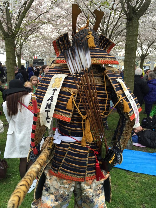

md02geist Posted July 16, 2016 Report Posted July 16, 2016 Hello all, Noticed that *some* suits of armor seem to have a ring around the area in between the shoulder blades give or take higher or lower, and this has a special knot tied into it. A friend of mine called this the "ceremonial knot" or something similar. What is the name of this knot, and is there a history behind it? I assume it is for good luck etc. Quote
Baka Gaijin Posted July 16, 2016 Report Posted July 16, 2016 Hi Rob, The Swastika shape of the knot is known as Agemaki 総角, on the Ō-yoroi 大鎧 (lit: great armour), it served to anchor the lesser cords from other parts of the armour. scroll down this blog to the fourth image and you'll see how it was fixed: http://blogs.yahoo.co.jp/septaria77/65311790.html This will show you how it functioned: http://ikkaiyoroi.com/himo03.htm On later armour it can be argued that it became a decoration which may have originally possessed some talismanic aspects. Don't get too tied up over it...... 1 Quote
estcrh Posted July 16, 2016 Report Posted July 16, 2016 Hello all, Noticed that *some* suits of armor seem to have a ring around the area in between the shoulder blades give or take higher or lower, and this has a special knot tied into it. A friend of mine called this the "ceremonial knot" or something similar. What is the name of this knot, and is there a history behind it? I assume it is for good luck etc. This is an "agamaki" knot, a redundant holdover on most armors, its original purpose was to help stabilize the large shoulder guards (o-sode) as seen in the image below. 1 Quote

uwe Posted July 16, 2016 Report Posted July 16, 2016 Rob, In Eric's first example, uketsutsu and gattari serving for fastening the cords. Instead of the agemaki no kan. On later armor's (as Malcolm already stated) the knot was used for adornment.....and preventing the ring to rattle 1 Quote
estcrh Posted July 16, 2016 Report Posted July 16, 2016 Rob, In Eric's first example, uketsutsu and gattari serving for fastening the cords. Instead of the agemaki no kan. Uwe, I do not think that is correct, there is an agamaki and the cords from the o-sode are tied to it, or at least that is what I am seeing. The agamaki may be attached to the gattari but it is not a clear view. 1 Quote
IanB Posted July 16, 2016 Report Posted July 16, 2016 The first image shows a typical Edo period armour where the maker has tried to reconcile the idea of o-sode and their cords with a gattari and ukezutsu for holding a sashimono. The second image shows a traditional armour, in fact a composite of a do-maru and an o-yoroi. The row of scales to which the agemaki ring is attached is laced in reverse so that the shoulder straps can be thrown back when putting the armour on. The agemaki bow, likened to a dragonfly with that part fastening to the ring representing the head and eyes whilst the loops the wings. Being heavy, the bow had the duel function of holding this row of scales down by its weight as well as providing an attachment for the cords that held the o-sode in position when raising the arms or bending forward. As sode became smaller during the Muromachi period the need for the elaborate system of cords was simplified and then abandoned together with the large agemaki ring. The gattari and ukezutsu were simply attachments for some form of sashimono, often a flag but also other devices on a pole, that identified the wearer or the unit he belonged to. Important accessories in the battles of the Sengoku era. By the 18th century after a long period of peace there was a nostalgic revival for the glories of the past that resulted in armours being made with ancient features such as o-sode, large spreading neck guards and the like - the latter making the wearing of a sashimono impossible yet the fittings for one were put on the backplate. Essentially the armourers had forgotten how o-sode were fastened. The central leather tie on the top plate should be tied to the rear loopon the shoulder strapp but was often tied around the shoulder strap with the standing plate that protected the neck from the sode being pierced to allow it to be tied this way. By the end of that century they had sorted it all out and good copies of o-yoroi and do-maru were being made, only to be abandoned when news of America's intentions arrived and high quality armours were produced based on Sengoku styles. Ian Bottomley 7 Quote
Baka Gaijin Posted July 16, 2016 Report Posted July 16, 2016 Hi Guys., Ian has it closely observed, excellent info BTW. For the rest of us mortals, if you use the zoom facility, you can clearly see that there is no Agemaki no Kan on the first image, there clearly is an Uketsutsu and Gattari that the Himo of the Agemaki is knotted into. Pip Pip...... 2 Quote

DaveT Posted July 16, 2016 Report Posted July 16, 2016 With image one I think I can offer an opinion.The sode were not originally made for the armour and were most probably added later during it's re-lacing. Thats why there is not a No-kan present.If you look at the top of the agemaki bow it is opened wider and strung around the gattari, therefore its adapted.The straps coming from the sode make use of the kanamono nothing more. Looks nice, but is fabricated to an extent. 1 Quote

estcrh Posted July 20, 2016 Report Posted July 20, 2016 With image one I think I can offer an opinion......................................The straps coming from the sode make use of the kanamono nothing more. Dave, I am not exactly sure what this means....."The straps coming from the sode make use of the kanamono nothing more".....Kanamono are the various metal fittings found on Japanese armor, some purely decorative, some functional. As far as I can see the straps of the sode are connected to the agamaki knot....did you mean agamaki instead of kanamono? In the image below the yellow arrow is pointing to the agamaki, the red arrows are pointing to were the sode straps are tied to the agamaki know, I do not see any kanamono involved. Quote

estcrh Posted July 20, 2016 Report Posted July 20, 2016 Heres my knots Fantastic, you should make a new thread with some more pictures. Quote

md02geist Posted July 21, 2016 Author Report Posted July 21, 2016 Heres my knots Very cool. What sort of rope do you use for them (thickness, material, etc)? Quote
DaveT Posted July 21, 2016 Report Posted July 21, 2016 Hi Rob, the rope is made from combined silk yarn. The tickness depends entirely on who made it. Older ones are very thick and heavy. Silk is rather expensive these days so reproductions are a lot thinner. When I say reproductions I am not including the ones made for display suits, these use cotton from china. 1 Quote
md02geist Posted July 21, 2016 Author Report Posted July 21, 2016 I'm looking to make one myself for a reenactment group (casual) and trying to figure out where to source it to make a reasonable looking one without needing to be authentic. Quote
Kai-Gunto Posted July 22, 2016 Report Posted July 22, 2016 Very cool. What sort of rope do you use for them (thickness, material, etc)?Not made by me. The tassels are silk. Its a high quality replica kozane armor from Japan. Quote
md02geist Posted July 22, 2016 Author Report Posted July 22, 2016 Curtain tassel should do the trick. Awesome thank you! Quote
