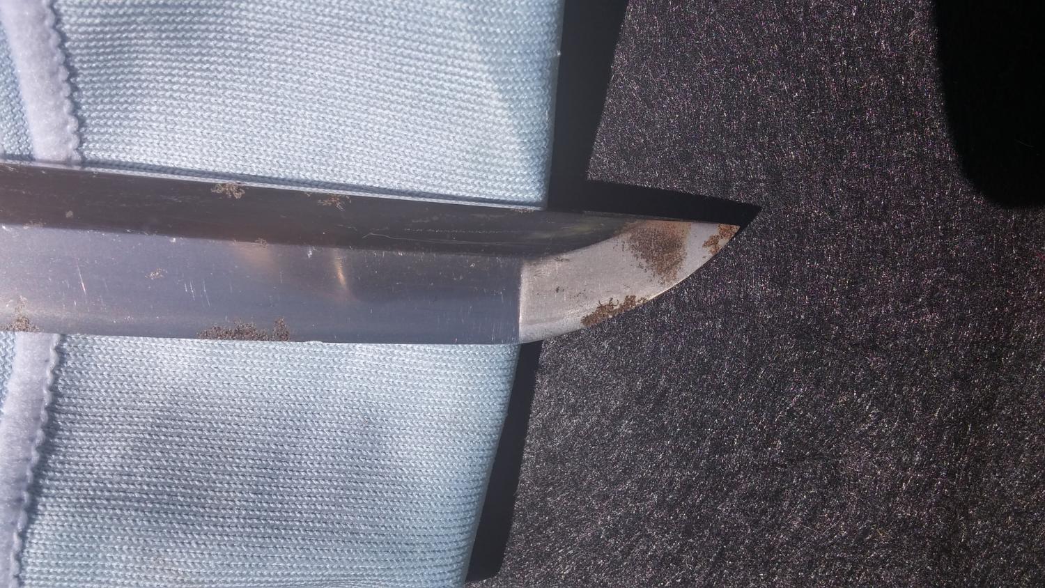

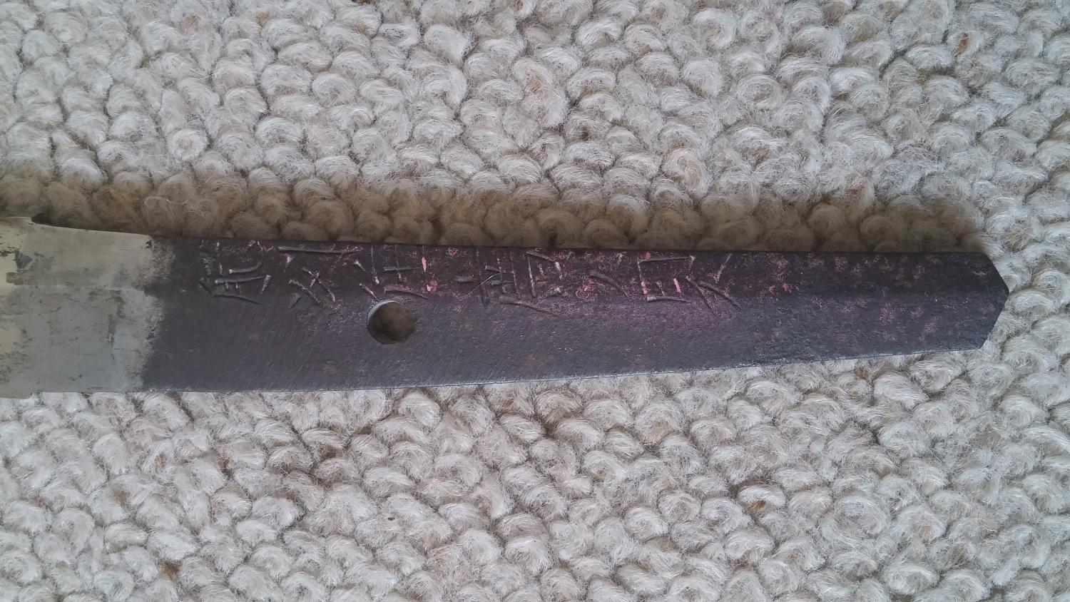

I'm not set on this assessment, but to me it appears to be koski zori, as the upper portion of the blade appears to be relatively straight. A Ko - kissaki and narrow upper part of the blade. Iorimune with gentle Orosi. The nakago is a standard shape with the nakago iris either kengyo or iriyama-gata maybe. The nakago still displays fairly strong katte sagari file marks.

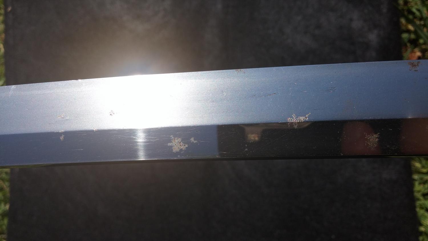

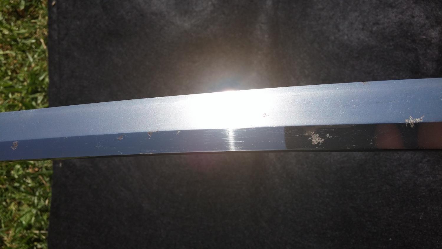

I really struggle with hada. I don't feel comfortable trying to make an assessment. I really need to see several examples together to recognize the difference and signs to look for. As previously mentioned, I only have two examples to compare. The same goes for other activitiesin the steel. The hamon is hoso-suguha and I think the boshi is ko-maru. The boshi temper line curves back to touch the tip of the ko - shinogi. One side is somewhat obscured by rust patch, but when I look at the other side, the upper part of the boshi curve seems to have... claw mark shapes pulling out of the boshi towards the yokote. I wasn't able to match this to anything I could find.
In terms of age, I don't see this sword being terribly old, though I believe that flat black rust does suggest the blade is reasonably old. Unfortunately it has not been looked after and has several inactive rust patches, some light pitting, minor marks evident. I'd also suggest someone may have tried to clean it at one stage.

Hi Steve,
I think that the kuni is Hishu (肥州) rather than Kishu (紀州) so a choice of Higo or Hizen rather than Kii for the province of manufacture.
Hawleys has some possible candidates working in Hizen during the Edo period, none in Higo:
HIR 367: Signing Hizen Kuni Ju Nin Fujiwara Hirosada (1st Generation) working around 1615
HIR 368: Signing Hizen Kuni Ju Hirosada (2nd Generation, son of Kanehiro, good suguba) working around 1684
HIR 364: Signing Hizen Kuni Ju Hirosada (son of Hirosada, presumably the one above) working around 1716.
The first generation gets 20 points and the others 15 so average skill level.
My guess would be one of the later generations as the sword looks to have the kanbun sugata.
Best,
John
Thank you for the assistance, always greatly appreciated John. I agree with you that it's likely later generation to, as I'd say the sword certainly looks of average make to me. I've corrected the spelling to and added some notes for my records.
