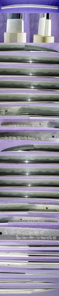

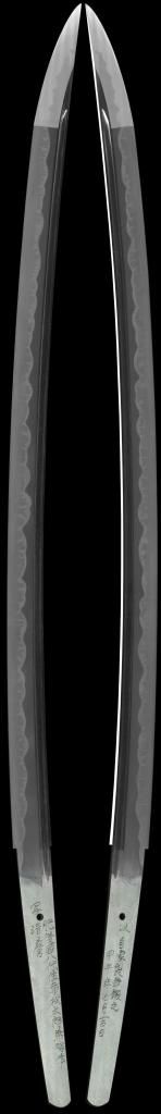

Decided to buy a buy a shinsakuto from e-sword.jp, very easy transaction and really nice people to work with. I'm guessing it will be here by the end of November. I hope it's ok to include a few pictures, smith is Kaoru Kimura aka Kanehiro according to the folks at e-sword. I wasn't in the market for an art piece, I plan to have this mounted and use it in the future for Iaido and Tameshigiri, but I did want something more traditionally made.
