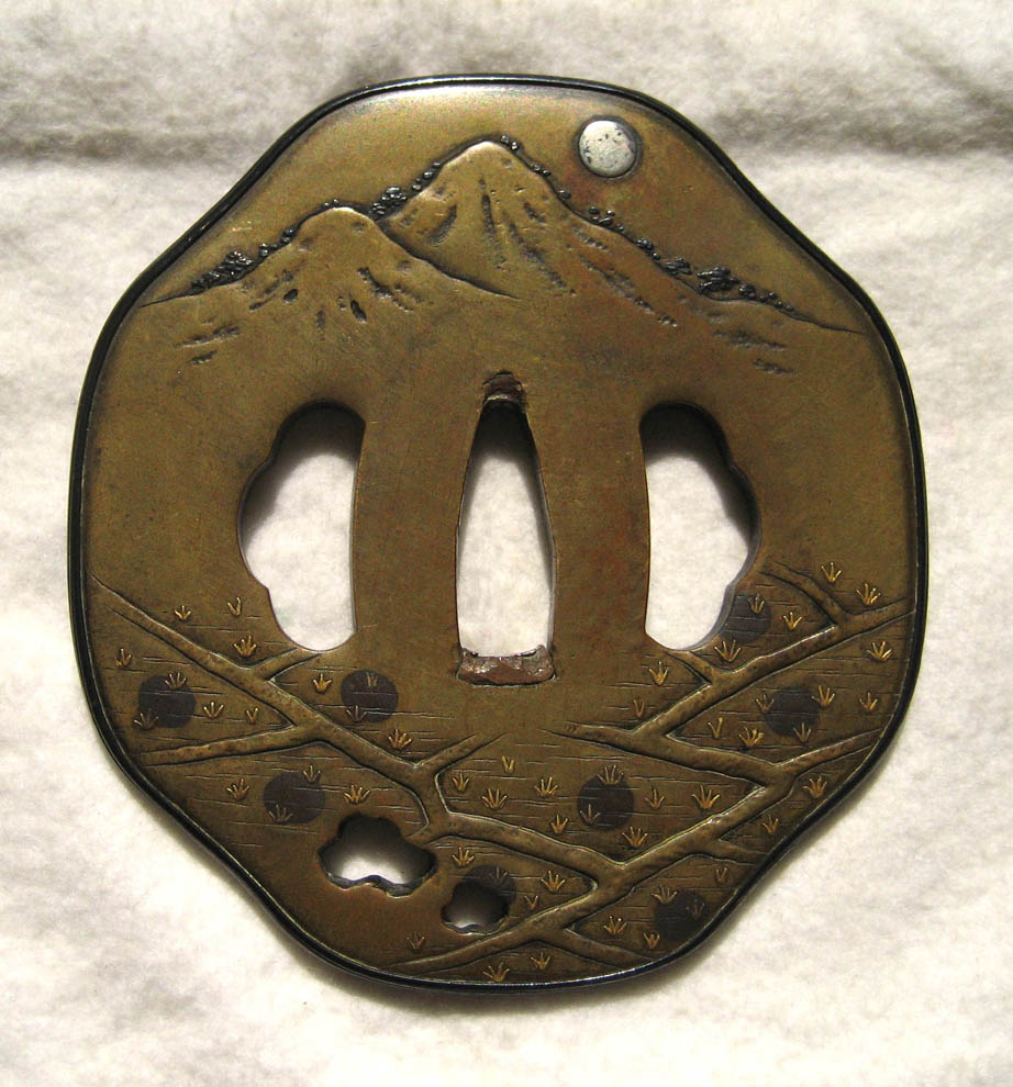

Curran Posted July 5, 2014 Report Posted July 5, 2014 Hi Curran, With this topic I wanted to highlight and discuss the sometimes anonymous independent artists whose works get the "Higo" attribution sometimes that were centered around Kumamoto castle in Higo Province making sword fittings for the samurai population and to a lesser extent the merchant population during the Edo Period. Some historically well known independent artist unlike the maker of my tsuba include Miyamoto Musashi and Nakane Heichachiro. Well, the Kumamoto artists are a complex topic beyond me. Some of them were incredibly skilled and it is a shame we don't have more in English on them. I am not sure there is that much in Japanese. A talk with an eBayer led me to this attached tsuba. I just assumed it was 3rd gen Nishigaki work, but one of our Higo smart guys said to look in the Hayashi book at the works of an artist known as 'Kohrin'. His works are rare and mostly in the Kumamoto Prefect Museum. I agree with the gent that this is a work by Kohrin. I thought the shakudo trees on the mountain were nicely done. No intention of sending it to the NBTHK for a paper that says 'Higo'. Anyway, love the design of moon reflected in the rice fields. Nidai Kanshiro did a famous tsuba of this design, and part of why I just assumed it was 3rd gen work in the same line. There are quite a few Kumamoto artist works I would love to own. Quote
Soshin Posted July 5, 2014 Author Report Posted July 5, 2014 Hi Curran, Thanks for posting this wonderful tsuba. This is the type of tsuba that I would like to discuss in this topic. Basicly tsuba that have or would likely get a Higo only attribution. The rim looks really nice does it have a shakudo cover? I wonder how they did the moon reflections in the design? Quote
Curran Posted July 5, 2014 Report Posted July 5, 2014 The moons are all inlaid at an earlier stage in the construction. We can look inside one of the ana and see a cross section depth of one of the moons into the plate. It isn't very hard to reverse engineer the design of this one. The fukurin is a shakudo twisted rope type fukurin. Much nicer than I anticipated from photos. This came from an antiques dealer about 20 miles south of me in Port Charlotte (site of a class 4 hurricane landfall about 1 decade ago- totally flattened it). Unfortunately, it was the only one she had and no word where it came from. As you say, some of these independent artists are a mash-up of the 4 main schools and whatever else. Nishigaki <-> Hayashi mash-up on this one? I haven't had the time to go further than confirming it is probably Kohrin work. Often they bridge two schools, and I like the results. Quote
Soshin Posted July 6, 2014 Author Report Posted July 6, 2014 Hi Curran, I often don't look in many antique shops and are likely missing a few nice pieces that once in a while come along. In my opinion this this is a really great find for a local antique shop. As you say, some of these independent artists are a mash-up of the 4 main schools and whatever else. Nishigaki <-> Hayashi mash-up on this one? I haven't had the time to go further than confirming it is probably Kohrin work. Often they bridge two schools, and I like the results. I quoted the above text because I think this is an important point about tsuba that received the Higo only attribution they often show attributes of one or more of the main school mix together. Sometime the workmanship can be as good as the work being done in the schools during the same time period. Your tsuba I would consider it a Nishigaki-Hayashi mash up of techniques. In the case of my tsuba it is mash up of Shimizu school techniques and the pre Edo Period Kamakura style. Quote
