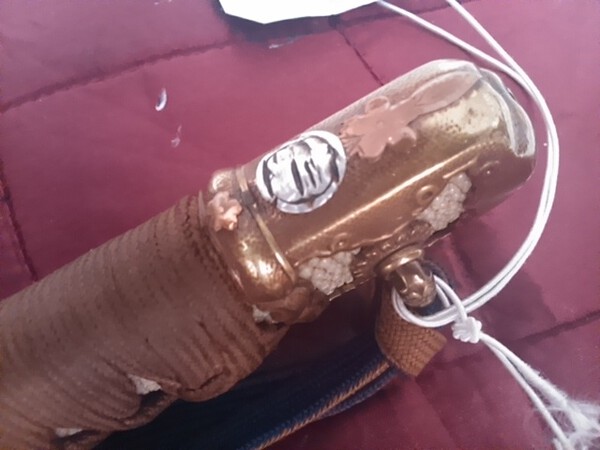

Recently purchased a ww2 gendaito, and like many it has a silver mon attached.
Unfortunately it was defaced, but a shape remains.
Has anybody got pictures of mons, that I can maybe match mine to,from books or from your own swords.
Any pictures appreciated, and book images.
I have pictured my mon,
Anyone a clue of the family or a guess of the remaining shape.
Thank you for this,I am trying to track down records,from nihon so,and hope that an officer of a specific family,may be logged in a ledger as the buyer of the sword.
I also like drawing these so pictures of your mons will help and a book even better.
Thanks all,sorry if it's been covered.
Best regards, Ian Bellis
Hi Ian,
Yours has the distinct "feel" to me of being a character mon (kanji mon)...either two kanji (I think) as in a name, or one kanji, maybe slightly stylised. Just my feeling. I haven't checked, but you could google character/kanji mon and something similar might come up...but you would be guessing to a certain extent, unless one came up that fits what is still visible. Good luck.
As for defaced mon, I have 8 gendaito, 3 have mon, two are removed altogether...pity. Character mon are more valuable (historically speaking) IMHO as they are usually the officer's actual name, which theoretically allows you to do some research into who he may have been...as opposed to "normal" picture mon which, by WWII, could be anyone.

Thanks George, I didn't even know there were character mon,
So this could be the buyer or sword owners name,
That's excellent, I probably won't find out as kanji is still out of my league yet,sword mei are beginning to jump out a little.

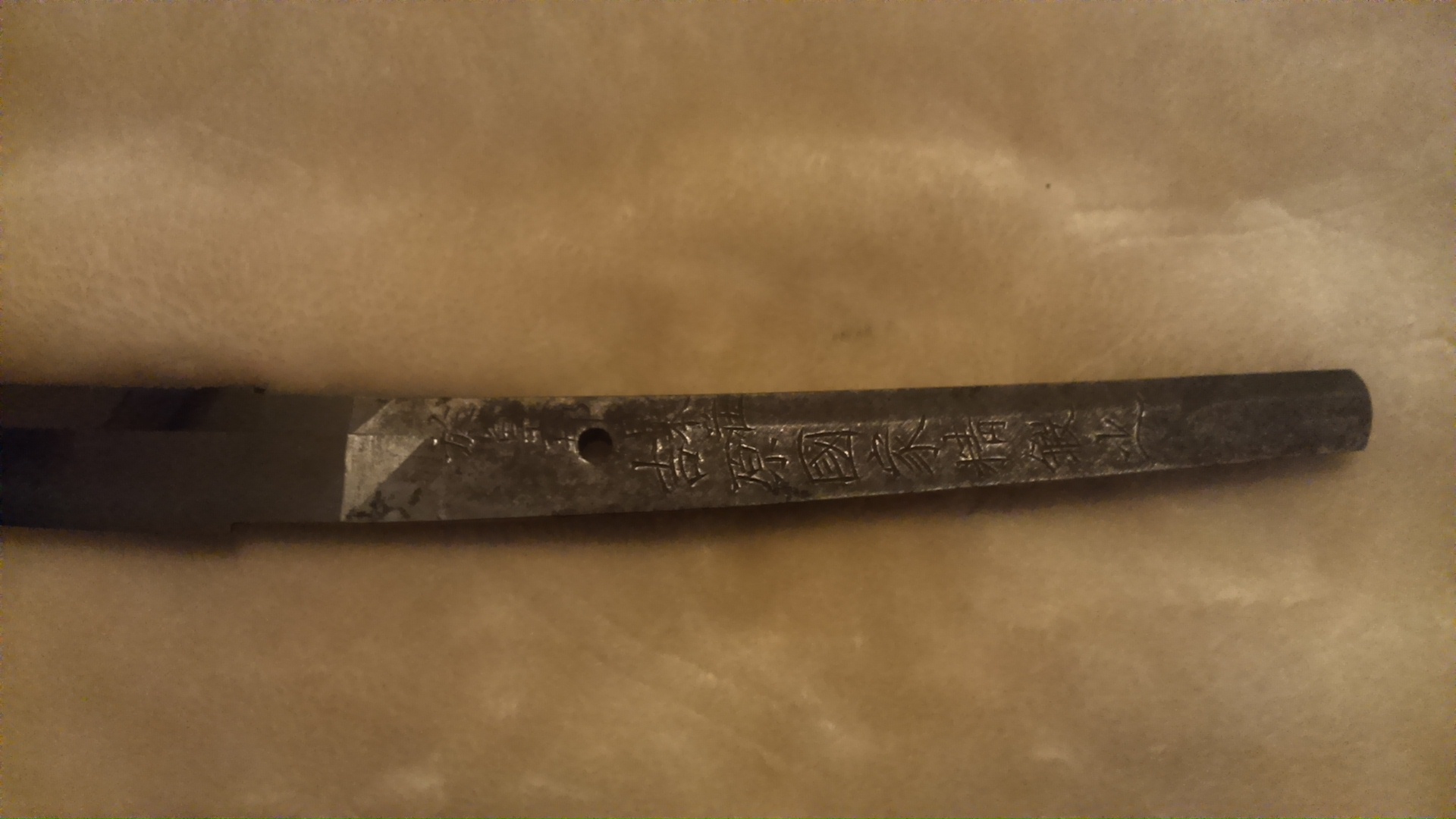

Thanks George for your help and encouragement,the kuniie keeps giving,made some Japanese togishi friends,budo sensei,they love the kuniie, and have shown great interest in it,yoshikazu

George I showed it to yoshindo yoshihara, and yoshikazu, both love the sword and flamboyant hamon.
In regards to the mon,it is as you say a name, but it can't be deciphered as too defaced.
I love the sword more everyday,and gain confidence in it,it has been complemented by his grandsons, so that's enough for me.

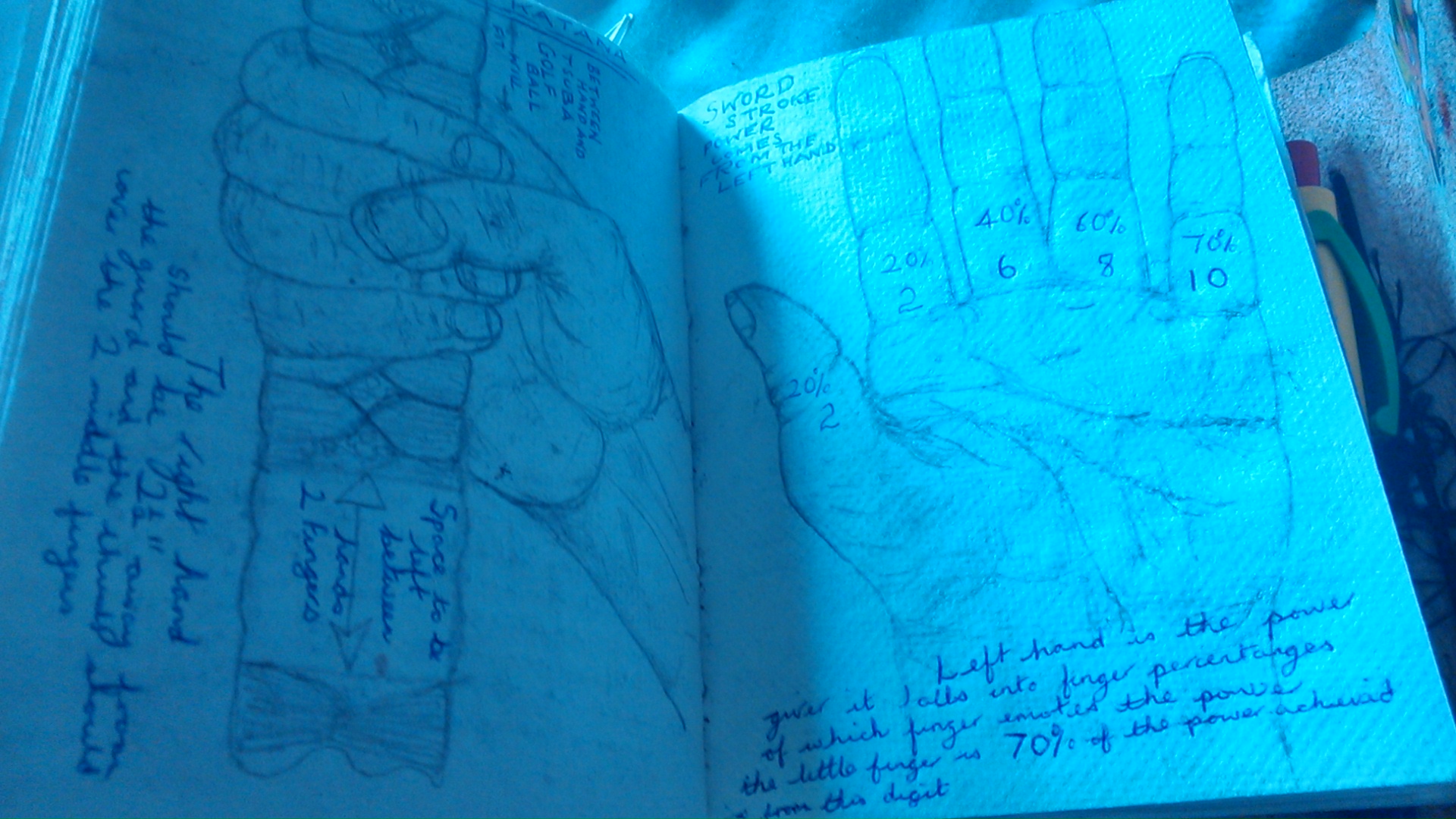

Pics of my journal, and sword collection.

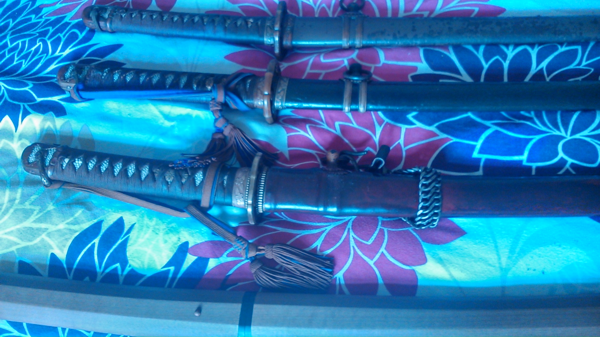

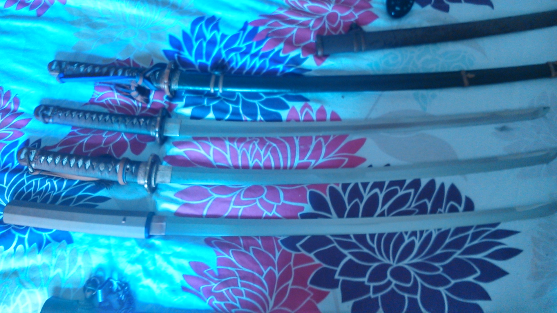

Thanks George for your guidance.

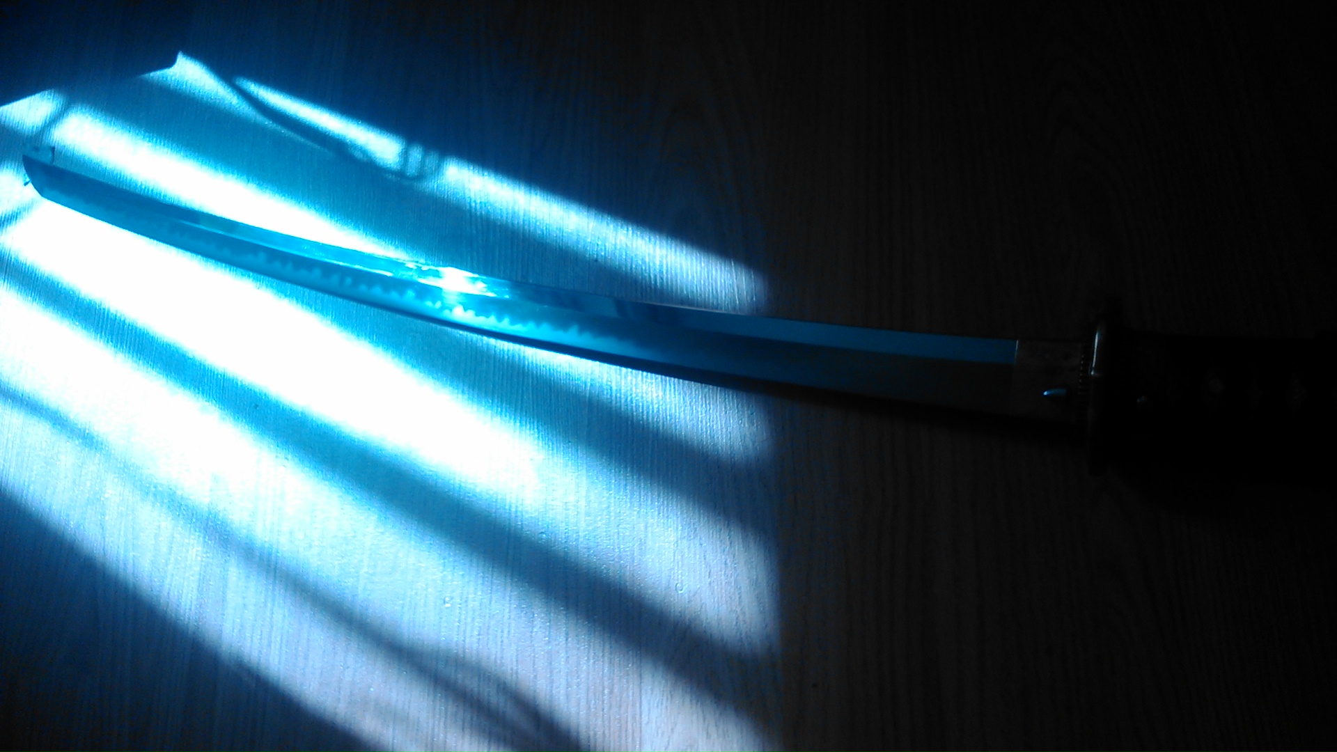

1 star stamp motomura kanemoto
2 yoshihara kuniie

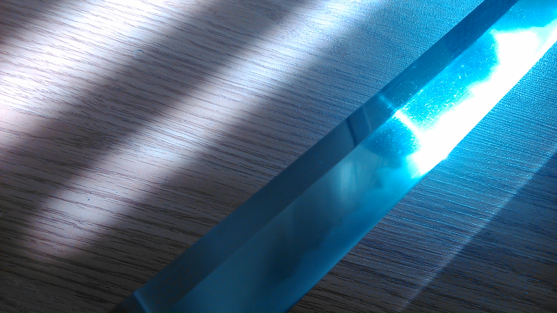

3 ichiara nagamitsu, a lovely sword, the hada and hamon although obscured by scratches,is magnificent, the Ashi are long and reach to the cutting edge, there are choji that join like mushrooms, I wish it was in Polish, a beefy blade,near 26.75" nagasa,lovely cutting sword,and fine balanced.
In all honesty, the best in a situation for balance is the star stamp,it is a joy to handle, in one or two hands,I see why the program started,these swords,they were meant for use, not just show.
The kuniie is in original polish as you know, and honestly is razor sharp,it again is weightless until swung.
I think these smiths are highly underrated,to make swords under pressure of this standard is amazing.
I am selling one,but it's hard,I may just save and keep them,I am losing militaria, but there is no comparison, these swords are so intriguing,
Considering most ww2 swords are classed by some as inferior, they have so much unique differences, it's staggering.
Sorry for going on, will keep you updated George, but the kuniie was admired by both brothers,an honour in itself.
Did you like my journal George?
259 hand written notes from this place,and your star stamp passion,basics,rarity makers mei,it's kept me sane these 2 years.
All the best,again thanks for your kuniie comments, no one seemed bothered, but many have pmd congratulations, and Brian kindly commented.
Best regards, my friend and mentor. Ian Bellis
