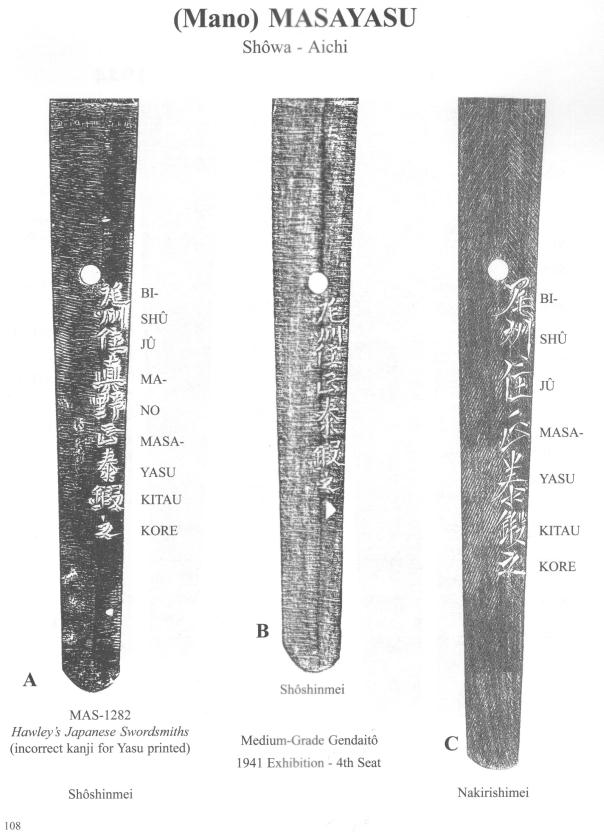

cisco-san Posted August 28, 2013 Report Posted August 28, 2013 from J.S. Slough´s book A polish would cost 2000-3000USD ...... Quote
obiwanknabbe Posted August 28, 2013 Author Report Posted August 28, 2013 Thanks for the image cisco-san. So This makes it difficult. Am i correct in concluding that the image to the center has Yasuri mei is most similar to mine, being that the file strokes are completely horizontal and deeper cut? The "kore" is different though. My "kore" is closer to the image listed as Nakirishi mei. Then again, the "Yasu" is different too. I suppose this is why there can be so much debate on authenticating a Mei. Could this blade have been made by a student? Also, the punch mark at the bottom. Is that a telltale clue? Mine has one, and the first two images have them. Ideas on what that is about? Regarding a polish, $2k-3k is the range of cost I am familiar with, but is it worth it? If this smith of my blade is the one being discussed here, then he was rated Cho saku in 1941. The real question is would the polish be a wise investment? Side note, Where can i get a copy of that book? I searched for the author but nothing came up. What is the title? Thanks again folks Kurt Knabbe Quote
