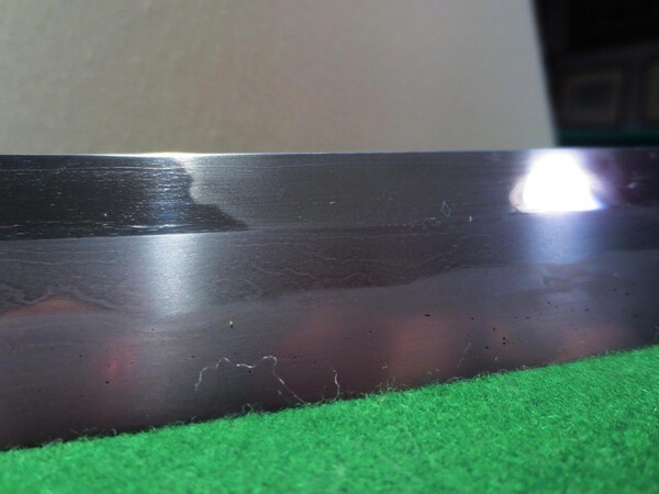

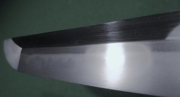

One I guess I have seen as it extends back from the boshi along the mune for almost 2" and ends in a square edge so it was probably intentional
The other is on the shinogi-ji and is half moon shaped so I wonder if in this case the clay fell off the blade while tempering?

I read that as well Grey but I think what happened is exactly what Chris said - it is the only area on the shindig-ji on one side that is there. ai am almost positive it was not re-tempered but in terms of the clay falling off - agreed.
I am not sure if that happened at that stage in the forging if the smith would bother re-doing from the start - I understand that even though it is a flaw it isn't a fatal flaw as far as I understand.

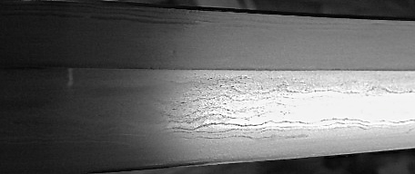

While only a few areas of the hada are visible, what is shown is masame and some itame. There really isn't anything in the photos close to ayasugi:
Sometimes the clay is wiped off the Mune as a way of controlling sori . I learned that when I was stationed in Yokosuka, Japan in the 1960s .Here is a blade I made a few years ago. I used antique hardware to add some authenticity. I would like to see some pics of what you are referring to. Regards James
I looked at your pics , I believe the previous poster correct. Seems as though some clay fell off during quench

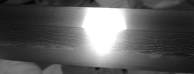

Looks like lots of something in the steel that prevented tight, slag free welds. You see this sometimes in the so-called hantan blades of WWII.

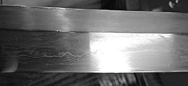

To me, the welds looks fairly tight... it just looks like a large pattern masame hada, made of several thick layers (less layers in number, but larger in thickness than "typical" masame hada) sandwiched together. At least I think that's what I'm seeing. It is kinda odd looking though...
I understand what Chris means about the welds though... they look to have a wider than normal weld joint, but no openings... I don't know how this would happen...
I remember some of the gimei blades on ebay (one seller was selling lots of them ,they all looked the same but had different mei), having hada like this... We talked about the on NMB a while back...
You got it - they are thicker folds but they are certainly welded tight and no openings at all - not a WW11 blade either I don't believe
These sure looks like rough, open/slaggy welds to me:post-1462-14196877284871_thumb.jpg
If you ran a surface indicator over the surface I bet it would show crevices along those welds...

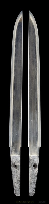

Attached is a Showa era sword by Amahide, I think this might illustrate the type of hada some smiths produced during this time period by folding different steels together in a manner similar to your sword.
http://www.nihontoantiques.com/fss188.htm
There were some smiths who did this during Shin Shinto period, when experimenting with forging methods, maybe posting more pics of the whole blade and tang will help to provide you more information.

THe welds are certainly not visible when in hand and although they appear like open rough ditches on the photos - there is no roughness apparent on the steel.
I do agree that it is probably a mixture of different types of steel with differing hardness

Its like he folded and hammered and turned it a bit and maybe even twisted and flattened.
I should try and get a full length shot or run a movie down the length cause it is sort of weird - mumei as well so >??
