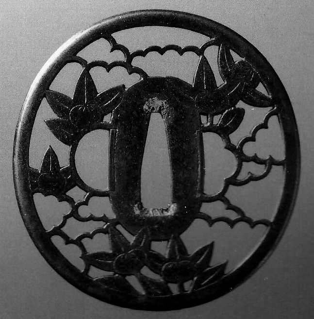

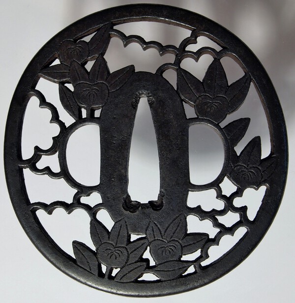

Hello guys, :D
This is the picture of this HIGO tsuba, said by SASANO SAN to be from HAYASHI TOHACHI. What is strange is that Mr ITO'book doesn't refer to this tsuba for HAYASHI TOHACHI. :(
To be or not to be .... :?:
Anyhow the picture is good enough to enjoy. :D
Best to all. :D
Marc

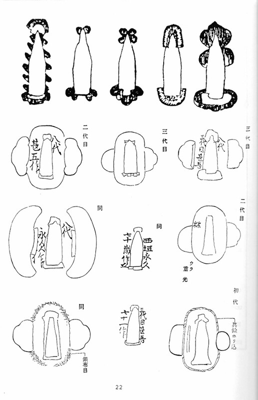

Thanks for the replies and the color photo. From looking at the photo and Sasano book I don't think they are of the same tsuba. Both photos are of the ura side I wonder if anyone has a photo of these two tsuba from the omote side. I would like to examine the chisel marks around the nakago-ana. In a old book of mine titled 600 Japanese Sword Fittings Terms by W. M. Hawley. I came across a figure written in Japanese detailing the chisel marks around the nakago-ana used by the first three generations of the Hayashi Higo school. This might have been used by Sasano to attributed this tsuba to the Sandai Hayashi. Here is a scan copy.

Hello David & Curran
Yes of course it is not the particular tsuba of TOHACHI by Sasano, which by the way was for sale on the site of Fred WEISBERG some months ago.
I own this tsuba, sold by Robert BURAWOY, well known dealer in France, having worked with Robert HAYNES and now retired.
Thanks for the info about punching marks.
Best regards
Marc

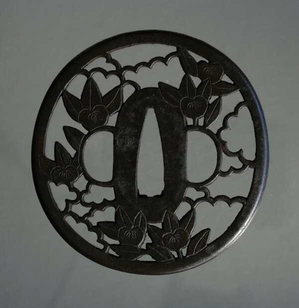

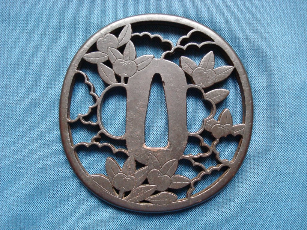

Hi Keith, Ford, Marc and BaZZa,
Thanks for the additional information and photos of tsuba using the tachibana and the tachibana in mist designs. Ford I have a few quick questions about the tsuba you posted. Did you make the tsuba? Chisel marks around the nakago-ana on the omote side are identical to a tsuba I have examined with the same tachibana in mist ji-sukashi design. The fine kebori detailing of the tachibana are also identical. This is different then Marc tsuba and one pictured in the Sasano book. The color of the patina of your tsuba looks much more brownish and not a deep purplish in color compared to the tsuba I have examined. A good example of the deep purplish patina color I am talking about is the tsuba "T-138 Signed Hayashi Shigemitsu Tsuba" from Tetsugendo website: http://tetsugendo.com/. This difference might be a result of the lighting and white balance settings.
Yours truly,
David Stiles
Hi David,
no, not one of mine. The colour in the photo is way off. The Canon 400D I used to use threw the colour decidedly red. To be honest I don't recall the true colour. I took that image about 3 years ago. That grey back ground ought to be a mid tone grey, to give you an idea how skewed the colours are.
The image of the reverse is a bit more true I suspect.
Hi Ford,
It is a small world after all. It turns out that I am the new owner of the tachibana in mist ji-sukashi tsuba you had three years ago. It was the big purchase I was referring to in my sale posts on NMB and one reason for the turnover of some of my collection. I really like the color and glossiness of the patina as well as the quality of the iron and the detail work done in kebori. The former owner was thinking it was the work of the Godai Hayashi but I think it is more likely the work the Sandai Hayashi. It is possible that the tsuba is a rare work of the Yondai Hayashi who only lived to the young age of 41. If it is assumed that Yodai Hayashi started working when he was 20 years old his working period was only about 21 years. What was your impressions of the tsuba when you had it?
Yours truly,
David Stiles
Hi Evryone,
I am going to try to photograph my new tsuba which Ford had with the tachibana in mist open work design sometime in the next few days. I will post the resized images here for everyone to view. Comments and questions are always welcome.
Yours truly,
David Stiles

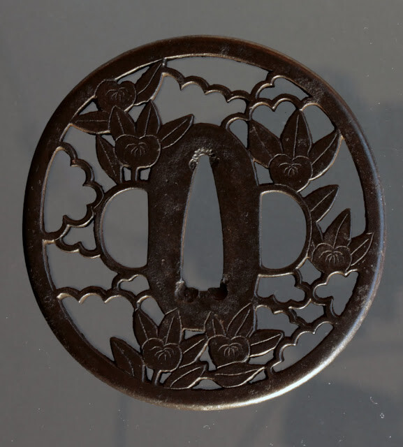

Hi Everyone,
Here is the new tsuba and only Higo tsuba in my collection. It has the tachibana in mist ji-sukashi design. The measurments are 7.6 X 7.9 cm with a rim thickness of 5.0 mm and a seppa-dai thickness of 5.5 mm. I think it is a Hayashi school Higo tsuba. The deep purplish black color of the patina is just wonderful and the tsuba is a joy to view in hand and reminds me of the Hayashi tsuba on the Tetsugendo website. I once said that Higo tsuba are a bit over rated but now I understand more as I have such a nice example in my collection now. Learning and development is an important process in this hobby. I hope my photographic skills do this fine (my opinion) tsuba justice. I will be bring it to Tampa show next year to let people see in person. :D
Yours truly,
David Stiles

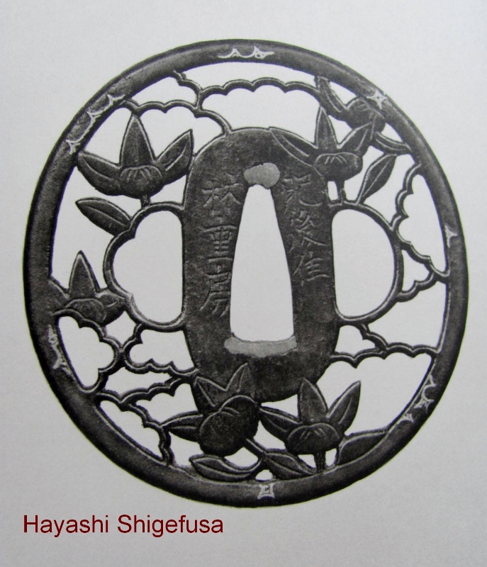

Hi Everyone,

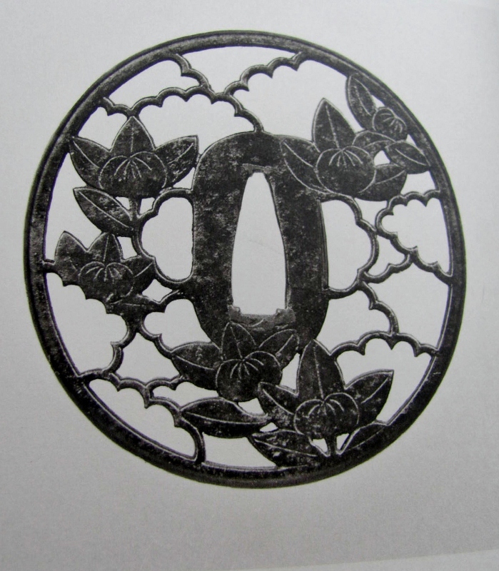

A friend of mine who had a copy of Higo Kinko Taikan has provided me with photograhs via email of the two tsuba with this tachibana in mist openwork design and permission to post on the NMB. Here are the photos with added text. I will then follow up with some of my conclusions based upon this new evidence.
This tsuba is signed Hayashi Shigefusa who is the third master of the Hayashi school.
This tsuba is mumei but clearly is in the Hayashi school style.
While my tsuba shares this design it is different and the carving of the tachibana using the kebori technique is different an in my opinion finer and more naturalistic. The seppa-dai of my tsuba while rounded is not as rounded as the signed example provide from the Higo Kinko Taikan or the Sasano example. My tsuba by seppa-dai alone in contrast to the mumei example reminds me of the second generation master Hayashi Shigemitsu work. My tsuba also lack the Hayashi characteristic katsurabishi-zogan of the signed example done by the third generation. My tsuba will be interesting and educational to submit to NBTHK shinsa. I hope to do this early next year. I would love to hear other people comments, thoughts, and ideas as well.
