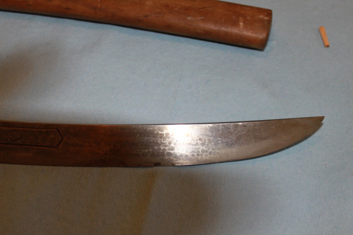

Jacques Posted October 30, 2012 Report Posted October 30, 2012 Hi, Yep, we have a better vision of that sword. It appears i'm wrong about ken and shinogi, but i'm right about tiredness and in my opinion it still not deserves a new polish which will make it just more tired. Quote
cabowen Posted October 30, 2012 Report Posted October 30, 2012 The blade has had its share of polishing and abuse, but it would still take another polish in all likelihood. There is still a hamachi present and it is most likely maru-gitae meaning you will not expose core steel from polishing. I wouldn't call it tired quite yet. The horimono maybe a later addition to cover forging flaws, some of which is visible towards the tip of the blade. They appear to be cut rather shallow. Bottom line is this is not a high quality item and you may find the money for polishing better spent elsewhere. Quote
bigjohnshea Posted October 30, 2012 Author Report Posted October 30, 2012 Thank you both for giving your opinions. Chris, I was thinking that that Horimono might have been added around the same time the Mei was added. It seems that many of Masamune's swords have Horimono like these, and perhpas that was part of the intended ruse by whoever added them. I have no reasons other than suspicion to support that. Quote

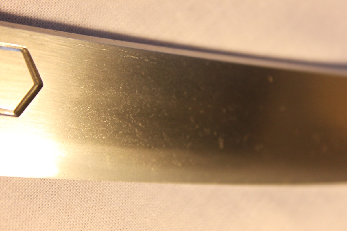

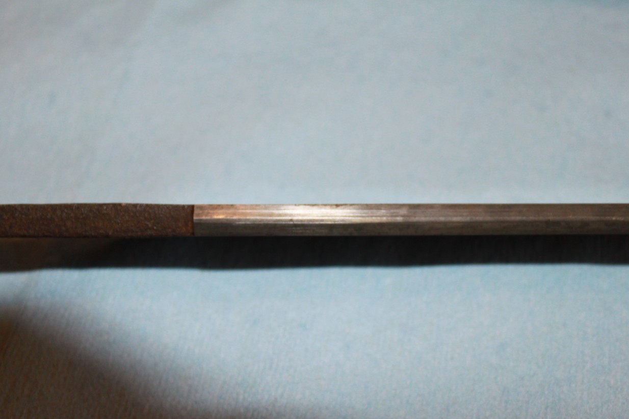

bigjohnshea Posted January 30, 2013 Author Report Posted January 30, 2013 Gentlemen, hope you have all been well. I wanted to post some photos of this blade now that a window polish has been put into it. Would love to hear some more of your thoughts. Quote
Lance Posted January 31, 2013 Report Posted January 31, 2013 From the pictures it looks better than what it did before, but it appears that the whole blade was (quick) polished? I thought opening a window (polish) was only done on 3-4 inches of a blade? Regards, Lance Quote
bigjohnshea Posted January 31, 2013 Author Report Posted January 31, 2013 Chris, I don't think I speak that language yet. :-) If you have a moment could you expand on your thoughts? A friend of mind seems to think it is from the Muromachi period. Lance, I like it a lot more with the window polish as well. It seems like he polished nearly the entire region in front of the horimono. The first photo shows the transition from polished to unpolished regions just before the horimono. Thank you again to everyone who contributed to this thread, and in doing so, to my knowledge. Quote
cabowen Posted January 31, 2013 Report Posted January 31, 2013 According to Jacques, the sword was tired and not worth a polish as it would only "make it more tired". I think the photos clearly show the blade took well to the work done and that it is not tired. It does indeed look to be Muromachi/later koto to me. It may not be Juyo, but it isn't a tired piece of worn out steel either....I would say congrats on a nice rescue....If the spurious mei was removed, it would in all likelihood pass shinsa with ease. Quote

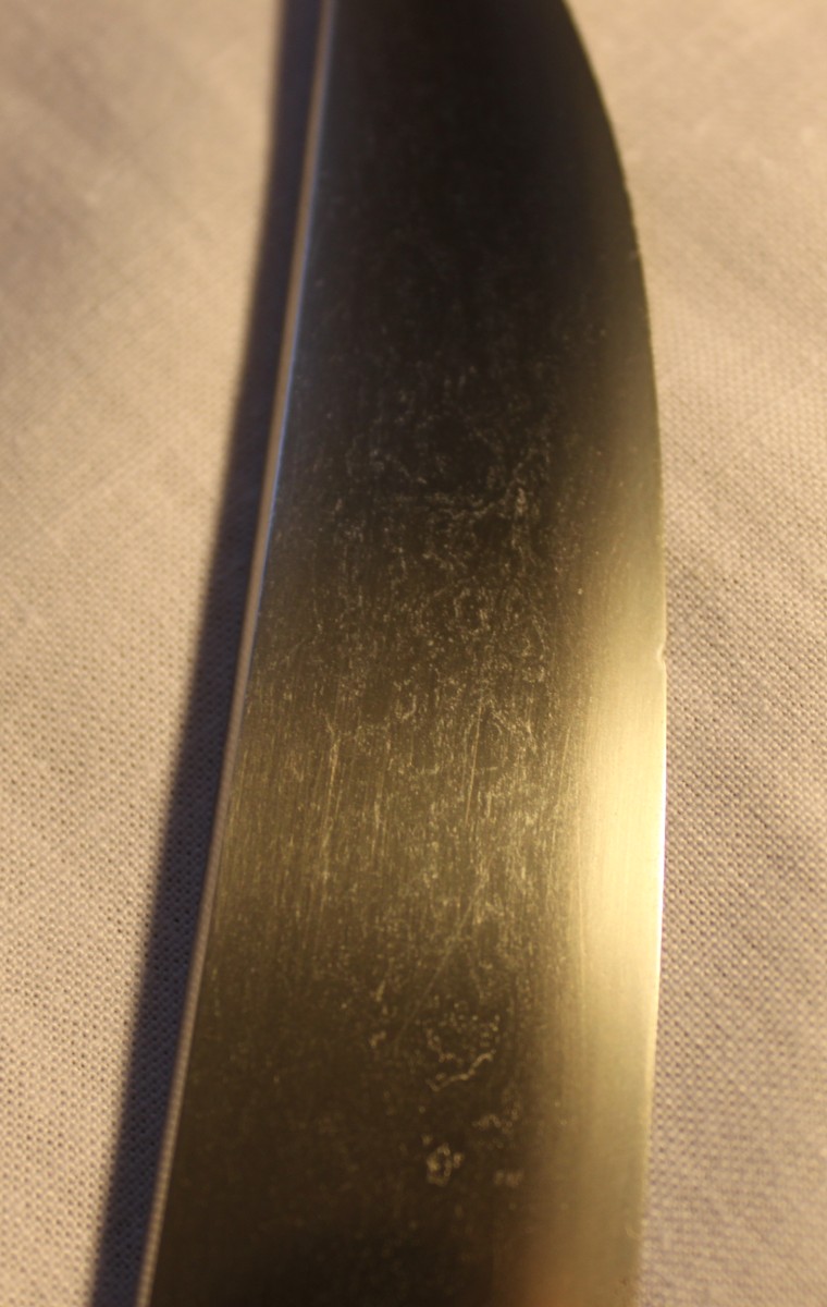

Jacques Posted January 31, 2013 Report Posted January 31, 2013 Hi, I think that picture is very expressive your sword is pretty tired and nobody knows if it is maru gitae or not. If i were you i would keep that sword as it is, but i'm not you and it's not my money. Quote
bigjohnshea Posted January 31, 2013 Author Report Posted January 31, 2013 Jacques, The polisher said similarly that he thought the blade looked very tired in some places, and I assume he was also thinking of the region you posted an image of. Regardless of the course I have chosen to go in with this blade I truly appreciate your input concerning it. Thank you again. I have a follow up question concerning your statement about the possibility that it is maru-gitae. How can we discern just by looking at the exterior of the blade if something is maru-gitae or kobuse-gitae, etc. etc? I only ask because I am holding in my hand a tanto I bought not long ago made by a Mukansa swordsmith and frankly I have no way of telling whether or not I am looking at all one piece of steel, 2 pieces, or 4 pieces? How do you distinguish them simply by observing the blade? Quote

cabowen Posted January 31, 2013 Report Posted January 31, 2013 Short blades are most often made of one piece, called maru-gitae. That means they don't have core steel which can be exposed when over polished. Sometimes rough areas of forging can be mistaken for core steel, leading one to believe a sword is tired. Quote

Jacques Posted February 1, 2013 Report Posted February 1, 2013 Hi, John, How do you distinguish them simply by observing the blade Very difficult, many times it is impossible to see. If shinogi-ji is pure masame and ji itame it is laminated. How long is your sword ? Tanto are mostly maru gitae but wakizashi are mainly made in kobuse or makuri particularly those made late Muromachi. About tsukurikomi, some seem fanciful like Soshu kitae (which was never used by Masamune). Quote
