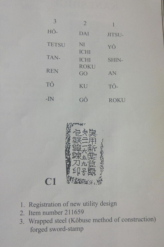

Konig44 Posted April 9, 2016 Report Posted April 9, 2016 Hi All, Am new to this site and to the collection of such items so please forgive my ignorance regarding terms. I am trying to work out what the markings on the tang mean. It looks to have an ordnance marking at the top and a company logo at the bottom. Please see attached imaged Thanks for all your help. Quote
Stephen Posted April 10, 2016 Report Posted April 10, 2016 Noshu seki ju Fujiwara Kaneshige the stamp seen in Sloughs book page 65 talks about Kobuse method of construction (wrapped steel) 1 Quote

Stephen Posted April 10, 2016 Report Posted April 10, 2016 K My old PC has my scanner hooked up to it, last time booted up it went blue screen, ill try again today, sad the new PCs today wont recognize old software .....im sure there is a pix of one on the board somewhere Quote
Stephen Posted April 10, 2016 Report Posted April 10, 2016 (edited) Duh....but i do have a smart phone search for kobuse stamp http://www.militaria.co.za/nmb/index.php?app=core&module=search&do=search&fromMainBar=1 Edited April 10, 2016 by Stephen 1 Quote
Konig44 Posted April 11, 2016 Author Report Posted April 11, 2016 Wow. Thats fantastic. This is indeed what is stamped into it.? Want to say thanks for this help. Much appreciated. Do you know anything more about the date of the sword and its creator? Cheers again. Quote
