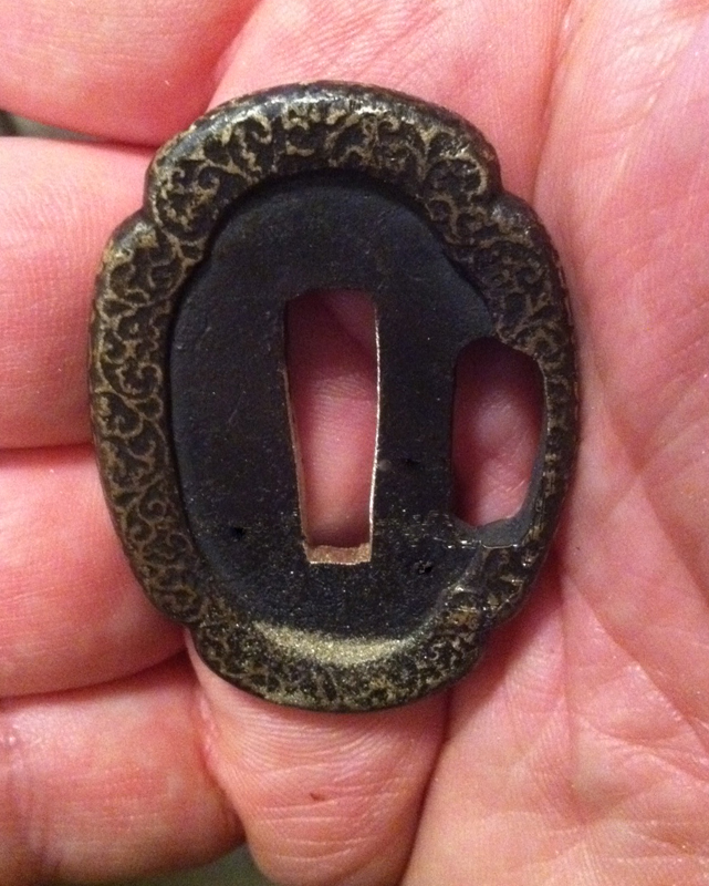

I'm working on a project mounting od a Gendai Tsuba...what I cannot see ti find in all my books is whether the "hole" on the Tsuba(see photo) should be traditionally on the left or right of the blade as it points outward. I'm thinking (the 'hole" as no kozuka would fit) it should be mounted away from the body when worn with the edge downward as most tanto were (to my knowledge?)?
Any help is greatly appreciated!
Curtis R.
(photo attached)
Curtis, Irrespective of whether your tanto has provision for a kogatana or not, the hole in the tsuba goes next to the body when the tanto is being worn, edge upwards of course.
Ian Bottomley
What makes you think that tanto were worn edge downward? Tanto were worn in the obi edge uppermost and the Kozuka hitsu ana would be closest to the body. Of all Nihonto only a Tachi is worn edge downward and is mounted to facilitate that method of wearing. :)
Sorry for the late reply...and Eric, *nothing* makes me think it might be worn edge-down...but it's nice to have some input regardless! Thank you all...the project is coming along well (yet slowly, so I don't screw the proverbial pooch :) ).
