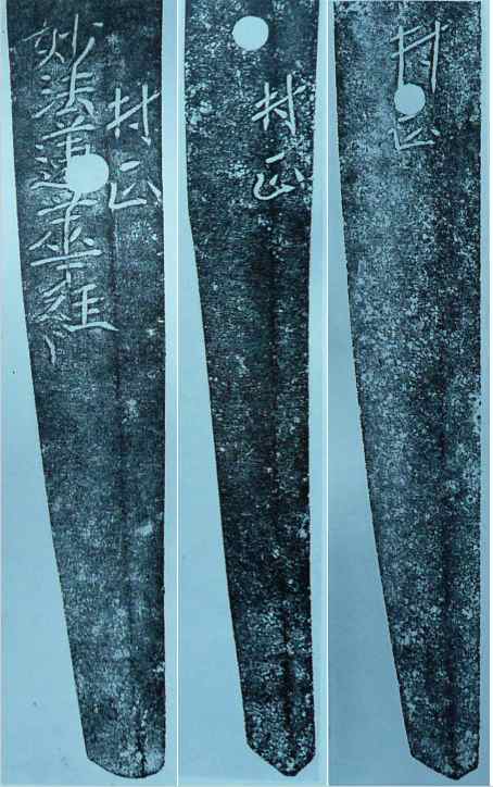

Well, I prefer to refer to authentic sources namely Fujishiro Koto-Hen
Pics from left to right - Muramasa shodai - Muramasa nidai - Muramasa sandai
Eric
Page 255
Plate I: EISHÔ JÛNEN MIZUNOTO-TORI JÛGATSU JÛSANNICHI
Plate II: MURAMASA, MYÔHÔRENGEKYO (The Lotus Sutra)
The "Jûgatsu Jûsannichi" inscription to the right is the death anniversary of Nichiren Shônin
Page 257
Plate I: MURAMASA
Plate II: HAKO MIDARE
This is called a hako midare which has collections of nioi appearing, a narrow ha and gonome choji. This is a
blade which resembles Sengo Masashige, Mino Kanesada and Kanefusa, Shimada Yoshisuke and Sukemune,
and Heianjô Nagayoshi nado. Most of the works of Nagayoshi and Nosada have a gentle ha, and Muramasa
and Nosada also have works with severe togari in the ha.
Plate III: SEISHÛ KUWANA GUN MORITA SHÔ FUJIWARA ASON MURAMASA SAKU
Plate IV: TENMON JÛNINEN MIZUNOTO-U GOGATSU HI
Page 258
Plate I: SEISHÛ KUWANA FUJIWARA ASON MURAMASA SAKU
Plate II: TENMON NIJÛNINEN KUGATSU KICHIJITSU
Irregularities can be seen in the mei kanji, but this is probably one done in his old age.
MURAMASA SANDAI [TENSHÔ 1573 ISE] SUEKOTÔ CHÛJÔSAKU
He is probably the son of Muramasa of the Daiei era. His works seem to be extremely few.
Signature: MURAMASA
Plate III: MURAMASA
