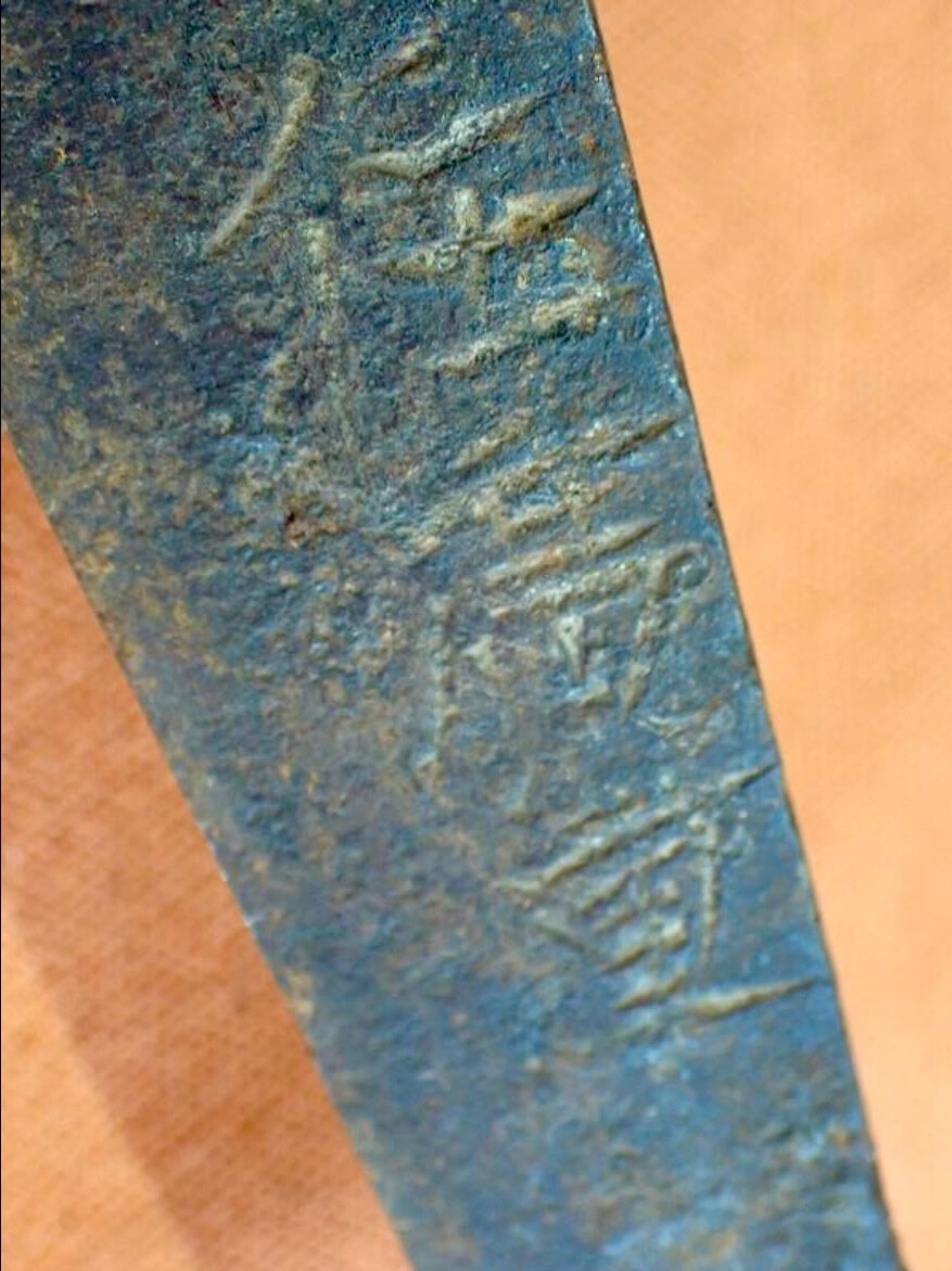

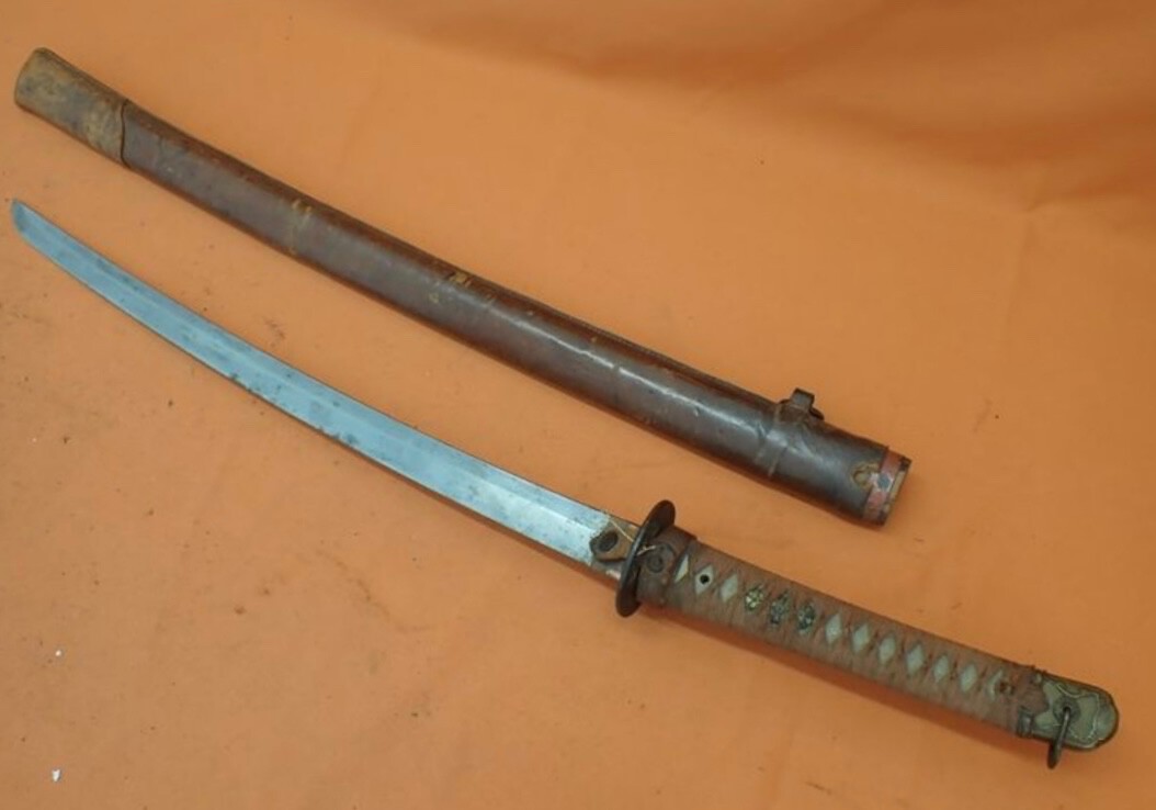

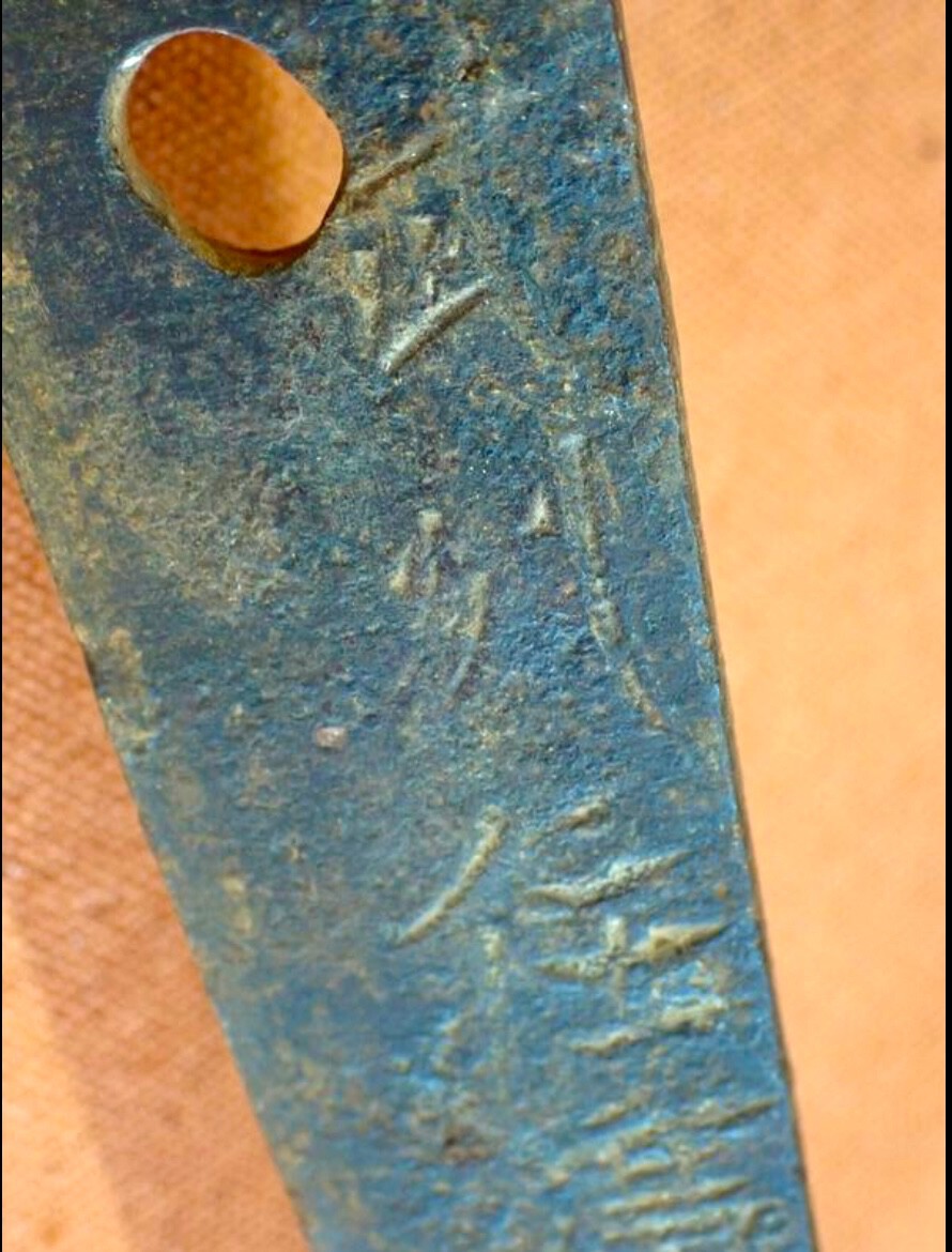

Retromodo Posted Wednesday at 10:28 AM Report Posted Wednesday at 10:28 AM Hi hope everyone is well, I’ve come across this wakisashi in ww2 fittings and I believe the blade is an older ancestral one. The Mei is 5 characters. The only one I’m sure of is the 3rd one which is 住 (Ju) . The first one looks a bit like a capital I so it might be 江 (Go) . The second one looks to have multiple vertical strokes which could be 州 (shu). So that would be goshu together which is an abbreviation for Omi . The last two characters I’m not sure about. Any additional info would be appreciated. Thanks Quote
YourBabyBjornBorg Posted Wednesday at 10:40 AM Report Posted Wednesday at 10:40 AM Hi! This is signed 武州住廣重 Bushu Ju Hiroshige, from the Bushu Shitahara school. There was one Hiroshige in Koto period (starting from the end of Tensho), 4 to 5 Hiroshige in Shinto period with existing examples. It's quite rare for Hiroshige to sign only Bushu Ju Hiroshige and not Bushu Shitahara Ju Hiroshige. 2 1 Quote
Retromodo Posted Wednesday at 11:22 AM Author Report Posted Wednesday at 11:22 AM Thank you very much for the info, really appreciate it. How would I be able to find out which generation of Hiroshige it is? Thanks 1 Quote
YourBabyBjornBorg Posted Wednesday at 11:30 AM Report Posted Wednesday at 11:30 AM I'm afraid it would be very hard to tell which generation, or even whether the signature is genuine, due to the current state of this sword, and information about Hiroshige is rather scarce overall. Hiroshige's signature style is also said to change a lot even within one generation. 1 1 Quote
ROKUJURO Posted Wednesday at 11:43 AM Report Posted Wednesday at 11:43 AM Jon, as you know now, it is certainly not a WWII WAKIZASHI. 1 Quote
