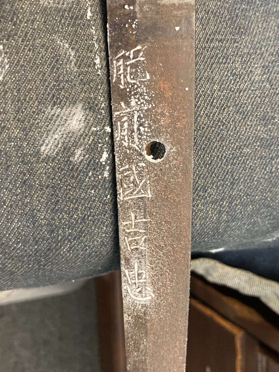

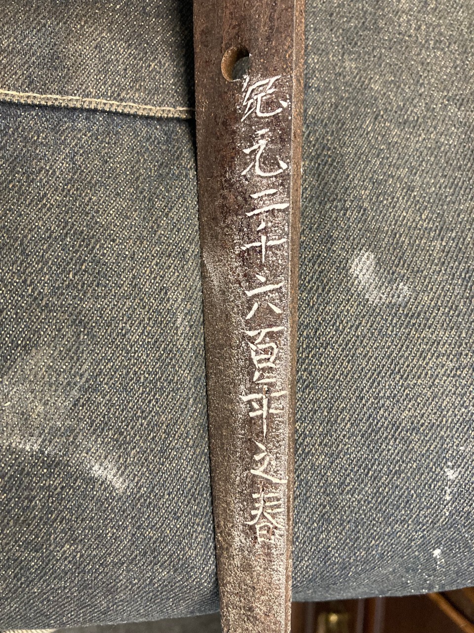

tbonesullivan Posted Thursday at 01:06 AM Report Posted Thursday at 01:06 AM This is from a Type 98 Shin-Gunto, which unfortunately had the blade become quite rusted, and then someone along the line buffed it to death. I'm hoping / assuming it's just a showato. It's got a signature I haven't seen before, and it's on the "wrong" side of the tang. 肥 前 國 吉 忠 - HIZEN NO KUNI YOSHITADA The other side has years since the founding of the empire, but the first two kanji I can't figure out: ? ? 二 千 六 百 年之春 Are the first two characters 紀 元 - kigen? The second character looks like it might be 元, but I'm not sure on the first one. Quote
uwe Posted Thursday at 05:17 AM Report Posted Thursday at 05:17 AM Probably this guy: YOSHITADA (吉忠), Shōwa (昭和, 1926-1989), Saga – “Hizen no Kuni Yoshitada kinsaku” (肥前国吉忠謹作), “Yoshitada” (吉忠), real name Kinoshita Kōichi (木下幸一), born 1893, he worked as rikugun-jumei-tōshō, jōko no jōi (Akihide), First Seat at the 6th Shinsaku Nihontō Denrankai (新作日本刀展覧会, 1941) Yes, it is “kigen”…in spring (春) 1940. About omote and ura. It might be the thing with Hizen blades and Tachi-Mei?! 3 Quote
tbonesullivan Posted Thursday at 12:55 PM Author Report Posted Thursday at 12:55 PM (edited) 7 hours ago, uwe said: Probably this guy: YOSHITADA (吉忠), Shōwa (昭和, 1926-1989), Saga – “Hizen no Kuni Yoshitada kinsaku” (肥前国吉忠謹作), “Yoshitada” (吉忠), real name Kinoshita Kōichi (木下幸一), born 1893, he worked as rikugun-jumei-tōshō, jōko no jōi (Akihide), First Seat at the 6th Shinsaku Nihontō Denrankai (新作日本刀展覧会, 1941) Yes, it is “kigen”…in spring (春) 1940. About omote and ura. It might be the thing with Hizen blades and Tachi-Mei?! It's a real shame about the blade condition. It was probably a very nice blade before oxidation. It's been polished/ buffed down so much I sadly doubt it could ever be restored. I see that he was listed as both Jōko no Jōi and Jōko no Retsu by Kurihara Hikosaburo. Does that mean he submitted two blades? I've seen several other smiths rated twice. Edited Thursday at 01:00 PM by tbonesullivan Quote
