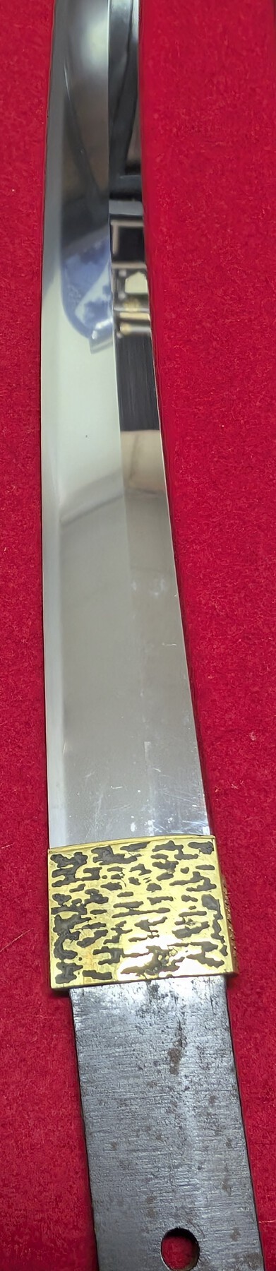

I heard that there are many 'cheap' and mass produced swords out there, so I am afraid I am holding one of these in my hand, and not an authentic edo-sword.

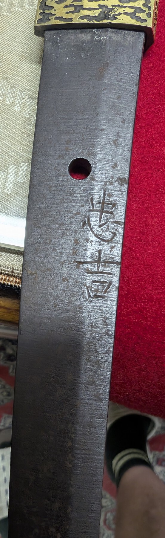

The Kanji on the tang reads Tadayoshi  忠吉

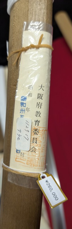

The vendor is asking 260.000 Yen for this piece. Does this sound reasonable ?

Vit, the blade is signed Tadayoshi as is indeed an authentic Edo period sword. However there were many blades with gimei (fake inscriptions) from the Hizen Tadayoshi school and I could suggest holding for something with papers (kanteisho) which this does not have. The attached document is simply a torokusho sword license and does not authenticate the inscription or give any type of attribution for the sword.
Interesting. Thank you very much!
I assume a fake Tadayoshi, even from the Edo period, does not hold the same value, but does that mean its automatically worthless ?
The vendor also added that a wavy hamon would be something only modern (or post Edo) blacksmiths are adding.
That sounds a bit odd, right?
Certainly not worthless since it is still an authentic nihonto.
And depending on the blade condition/size 260,000 yen is quite resonable esp for a long blade. I wouldnt mind paying that if I loved a blade that I knew was gimei.

On the Torokusho it says 72 (I assume cm?)
Yes, Nagasa: 72.0cm. The fact that it is daito length and signed katana-mei (on the katana side of the nakago) is not a good sign as far as being a legitimate mainline Hizen-to.
  • Like 5
I don't think it's a Hizen Tadayoshi Gimei, I think it only a lesser known smith, what used the same name. But to be sure, you must send it to a Shinsa (NBTHK, NTHK)
